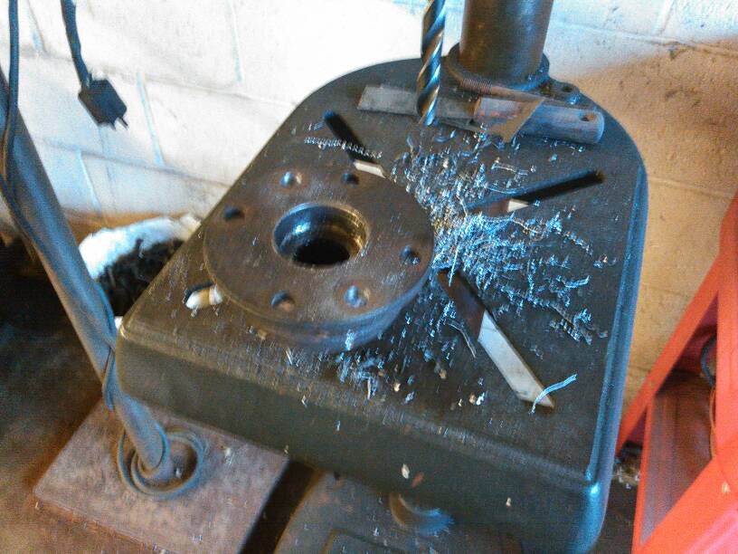

To drive the black one off the trailer I needed to hook up a driveshaft. Unfortunately the roller axles I brought came from an FJ62 so the flange was larger. I drilled it out to the smaller FJ60 pattern.

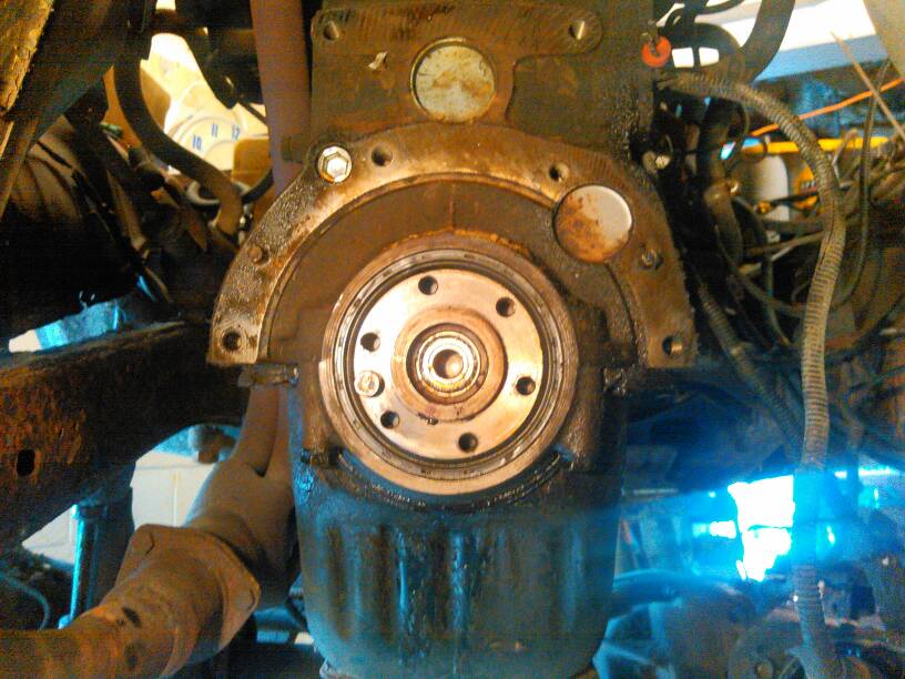

Started the H55f swap the other day, as well as the rear end rebuild. Pulled the bellhousing to check the cam plug, as they are known to leak on the 2F engine. It looked fine but the rear main was seeping so I'm installing a new one.
What a mess!

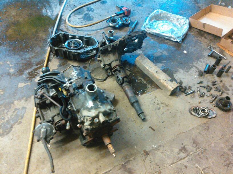

The H55 came with a vacuum shift T-case and I want mechanical, so I'm splitting apart my stock one. The H55 is a bit longer, because my truck is a pre-oct 84 build. So some shifter modification will be required. I may be able to rob parts from my 86 parts truck too. We'll see!
The 86 transfer shifter will bolt up.

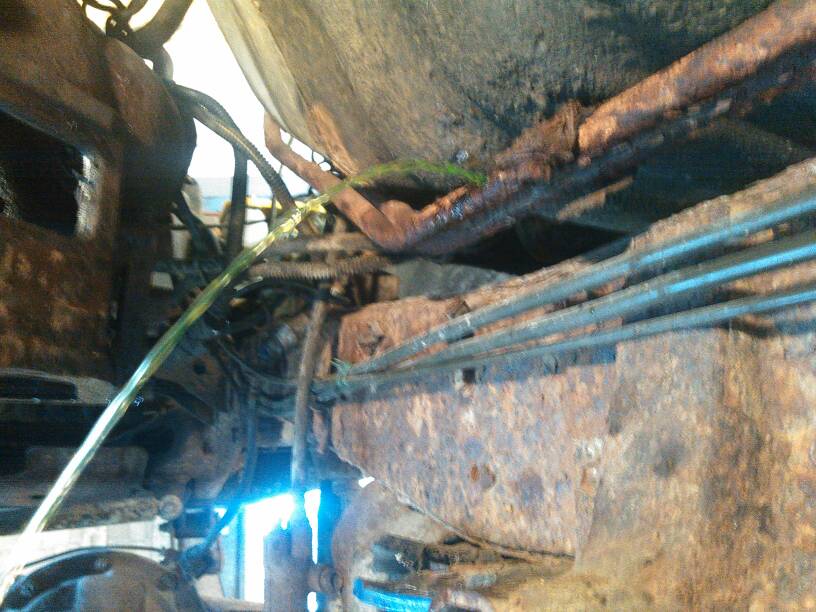

Is that coolant leaking out of that heater line?!

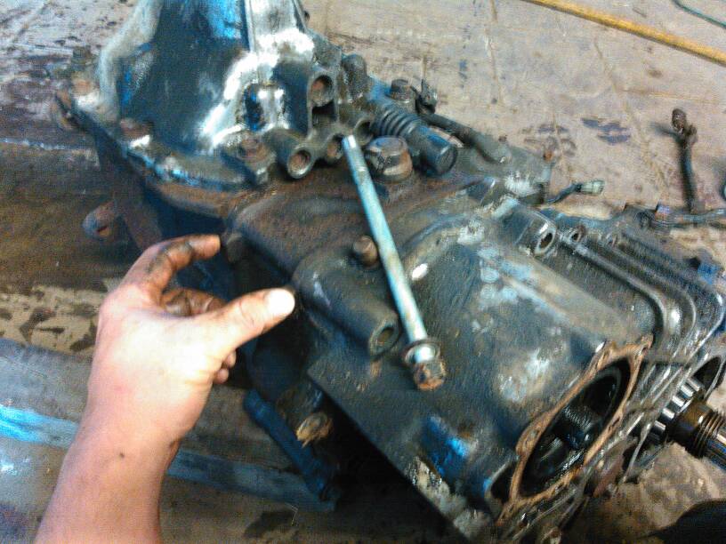

Trans is in, and with a manual t-case. I used the stock 84 case, swapped flanges for the large ones off the vacuum case, and used the t-case shift linkage off the 86 parts truck. Because of my pre-Oct 84 truck with a short trans, the stock shifter wouldn't work. The H55 is basically the same as the stock four speed but has this external overdrive box. You can see the long bolt on top. I needed a few of the longer bolts from the newer t-case.

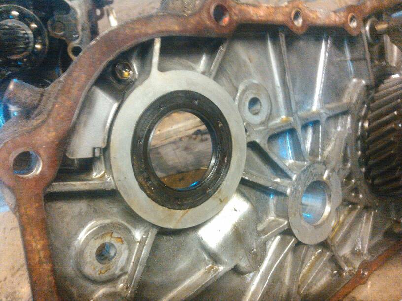

When I had everything apart I replaced the main seal between the trans and case.

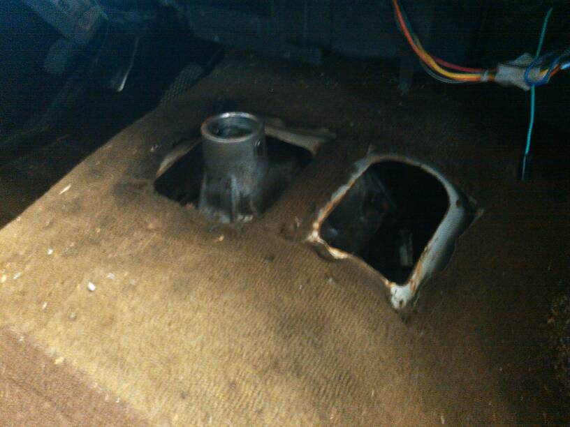

Several online write-ups claim the trans shift tower hole is too far forward on the pre-Oct 84 floor hump. I did not find this to be the case, but I did find the t-case lever was. Using the 86 lever worked out without having to cut the floor. I did notice my trans cover is white, apparently off another truck (possibly newer) but the 86 and H55 parts truck shifter boots were a different shape so I retained my "possibly original" 84 boot.
Stock narrow style trans crossmember bolted right up. Plenty of clearance for the front driveshaft too, which also is not the case on other peoples trucks.
Lastly, I discarded the unneeded tin "braces" for the T-case linkage as they really were just in the way. But for some reason I gained a 2wd low range position. Maybe this is shifter adjustment? Seems to work so I'll probably leave it alone.
