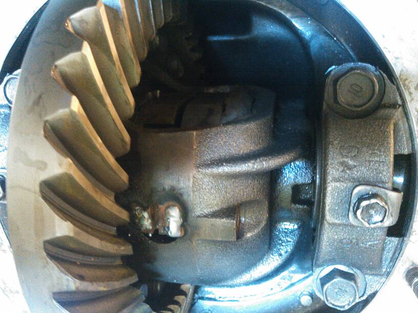

Today's project was to finish putting the rear axle back together. This included new 5.29 gears, and an Aussie locker. I ran into the same crosspin issue that I did the first time I built this axle. The thick ring gear won't allow room to install it. Many people grind the ring gear for clearance but I'm not a fan of how much material needed to be removed. So like I did last time, I ground the pin into a "D" shape.
Problem with my "D" pin in an Aussie locker is it no longer allows the pin to hold in the cap for the C-clip on the left side. So my solution was to cut a slot in the end of the pin. This allowed the insertion of a flat screwdriver to turn the pin 90 degrees counterclockwise. My initial thought was to redrill the pin retainer bolt hole but the hardened pin proved difficult to drill, plus there was not a lot of meat to do this. So some simple tack welds hold it in place.

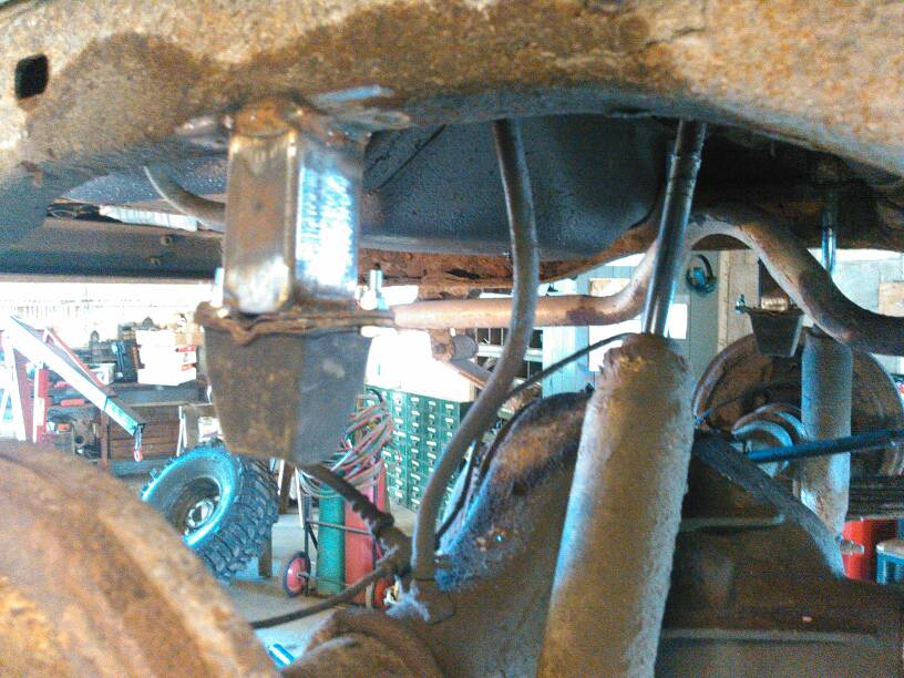

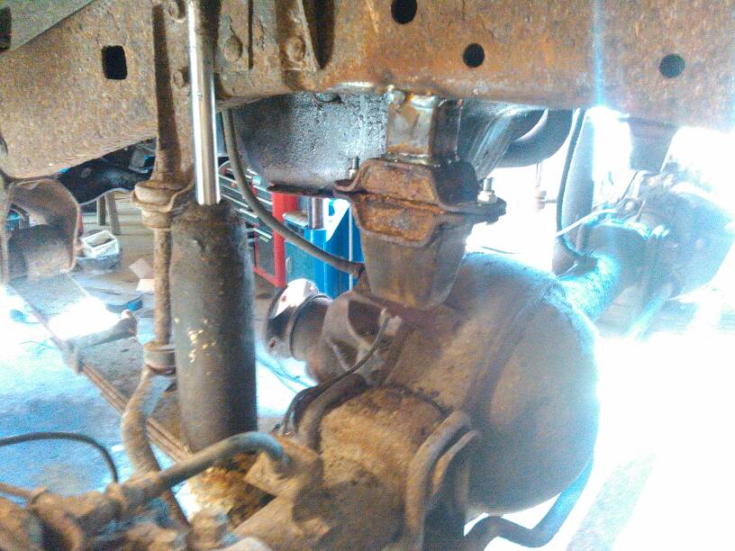

After I finished the axle I moved on to fabricating some bumpstops, hoping to keep my boggers from mating with my fenders. Fire Marshall Rollbarbob stood fire duty as I finished the welds next to the gas tank.
I didn't take a pic after, but as a final touch I coated them with bedliner.

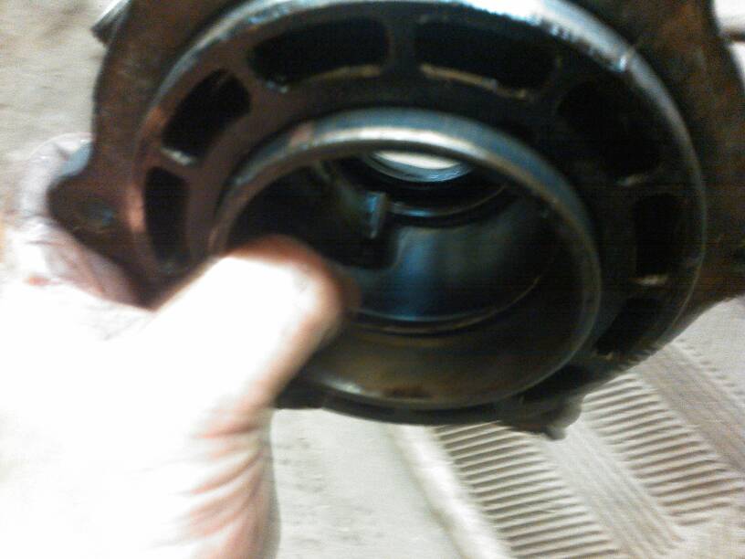

Last project this eve was swapping out the driveshaft flanges for the late large pattern. I noticed the one on the back of the T-case was tight and I have had bearing noise in the past. After taking the rear housing off a few times I finally figured out there is a shim under the race. After removing it, tolerances were perfect.

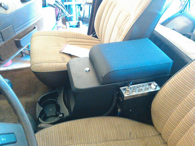

Installed a Smittybuilt YJ security console. I meant to order the stereo model to mount my CB but accidentally ordered the wrong part number. I think I like if more with the longer armrest and interior space. Still plenty of room to mount the CB on the side.

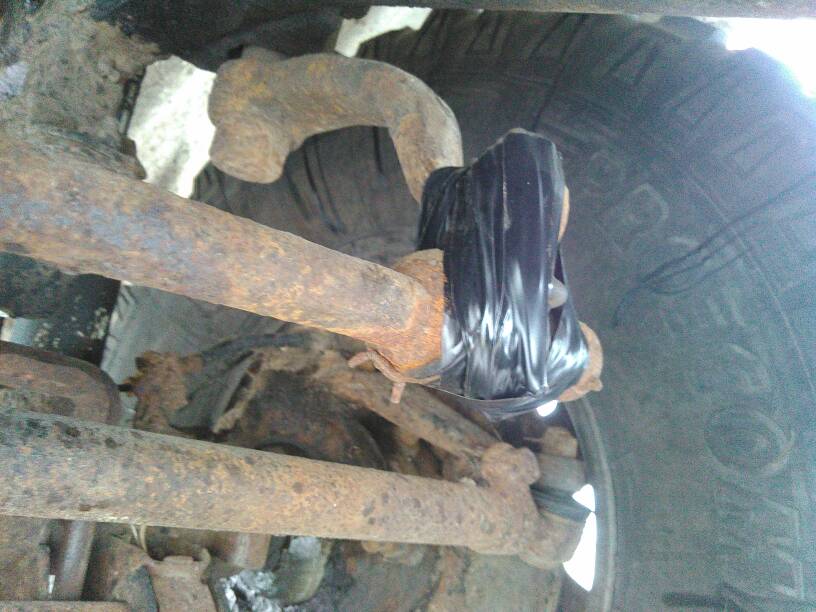

Daily driving the old girl again which I love. Yesterday I was going down the street and lost steering. I ended up over the curb and in a field. The tie rod had failed at the pitman arm.
Being a diver by trade I carry a roll of electrical tape all the time. Half a roll later I was back on the road. This should last another 31 years!
Well, at least it lasted long enough to limp a mile to my shop at 3mph so I could put another one on.

Any chance of you posting how you installed the smittybuilt console or pics?
Well...........it was pretty complicated........actually not at all lol! I took it out of the box, bolted the little spacer/filler panel for the rear part on, set it where I wanted it and drilled through the floor and bolted it up with the four supplied bolts. No modifications to the console or anything, and I like where it is. However, it should be noted i pushed the console as far forward until the little spacer thing on the bottom hit a brace built in the floor and that is where I left it. I am 6 foot 2, so I sit with the seat most of the way back. A shorter person may want the console a few more inches forward. However they would need to modify the spacer bracket or remove the floor brace. I would definitely do it again!
Final note, the cupholders are decent but not great. They are decent for a can of Coke, but taller drinks still can be an issue. Also, I too thought about getting tan, but as greasy as I get most days, black is probably better for me!

Interior looks like it was in good shape when you got it! I'm jealous. And that smittybuilt console doesn't look too bad in there. Does it fit the floorplan?
