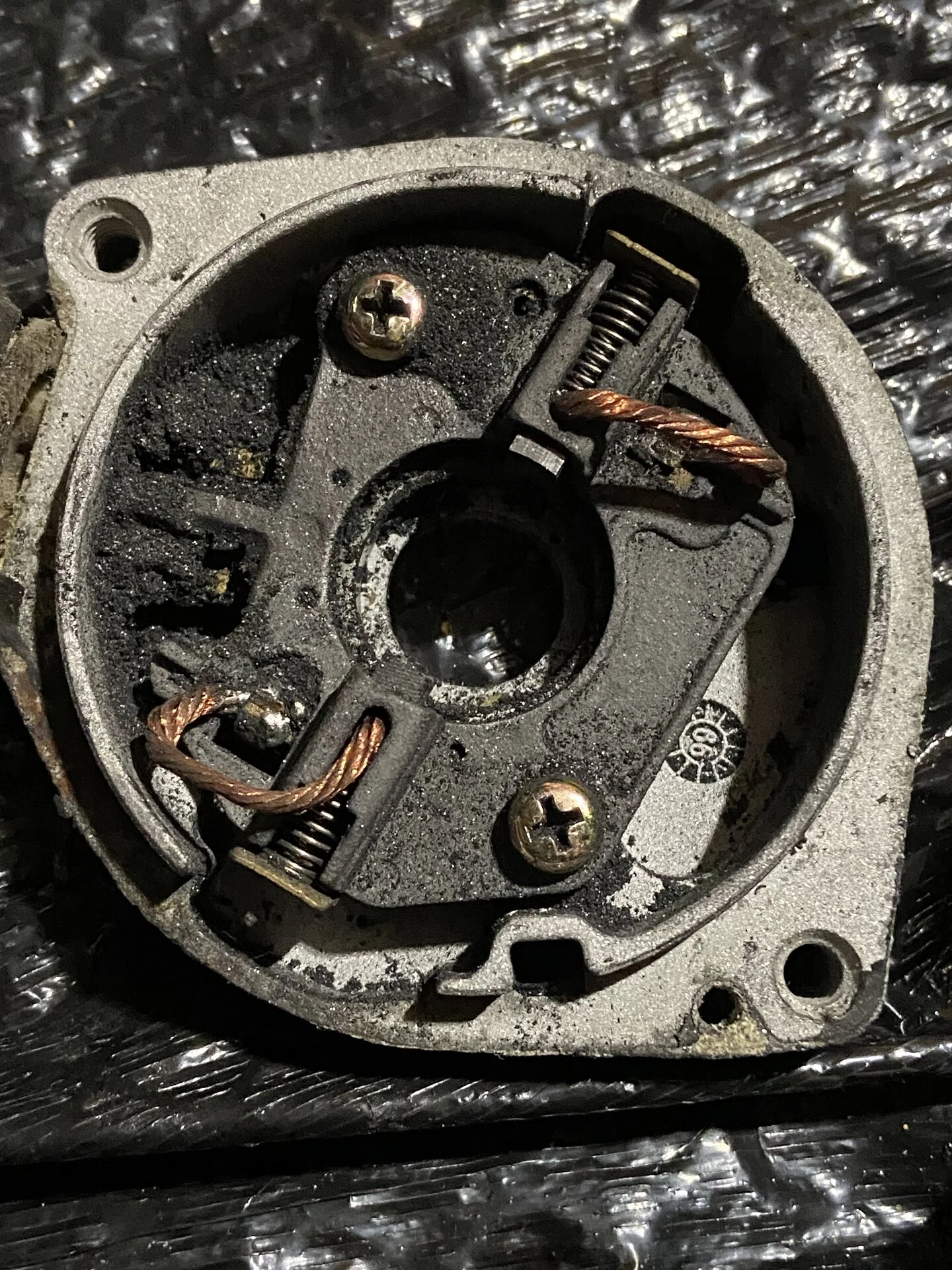

Pulled the MC last night and, since it was my second time doing this, it took me about 40 minutes from start to finish. I didn’t have time to fully disassemble the unit, but I did pull the motor off and open her up…
Brushes are fully worn down, with lots of carbon dust in the motor housing.
Bad pic, but the commutator actually shows very little wear.
Motor control wire and lugs are also in good shape.
In my limited experience with motors, this amount of brush wear in five years would suggest excessive runtimes, precipitating carbon contamination would further wears down the brushes. Again, likely because the pump was fighting against an MC assembly that wasn’t holding pressure to spec.
Hard to see, but look a little wet inside motor. If so, that also reduces life. There's a breather hole to motor and drain for pump. They must not be clogged. Or fluid is sucked into motor.
