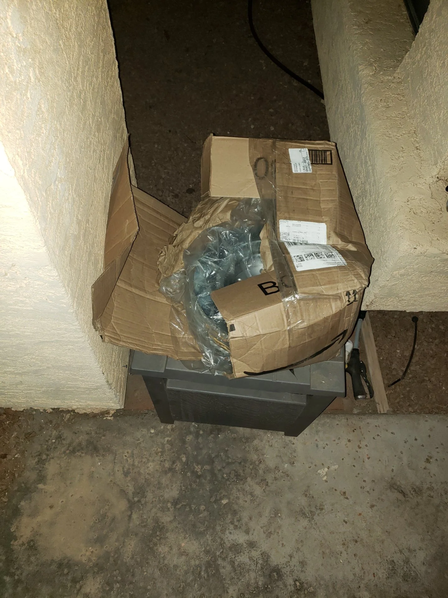

So if your brake rotors showed up like this, would you install them on your rig? No "obvious" damage. And they are big chunks of cast metal, right? Or would you wait 2 weeks for a replacement? (<- which is in itself insane, but that's a topic for another thread. The world has gone crazy...)
I would use them without thinking twice about it. Short of the delivery driver dropping them out of a moving truck, they are just machined and cast chunks of steel, and very hard to harm. They were probably just too big and heavy for the flimsy cardboard box they were put inside. If you are worried about them you could check flatness with a straightedge.

Tough call. This would be my criteria:
  • If my old disks were already off and my rig was sitting on the driveway or in the garage on jack stands, I'd use them.
  • If I hadn't started any work yet on my rig, and the current brakes are working well enough with no plans for long road trips, SEND THEM BACK! If it's not a problem waiting. What's two weeks considering how long members on this forum are waiting for bumpers and other products! Two weeks is nothing!! You'll blink, open your front door and Bang! They'll be sitting there! The time will go by that fast.
I wouldn't worry about them unless the friction surfaces are dented. They are really tough chunks of metal.
unless theres physical damage such as chunks missing or serious gouges in it i would have no problem running them. their are big and heavy so its not surprising that they blew out the box, the box can only do so much against 40 lb of rotors
My Power Stops blew out the shipping box too. No damage. Rotors are probably the toughest part minus the frame and engine block. LOL
Just have them tested for true and send it if they are in spec. If they are warped, bent or run out in any way...return.
I would run them without thinking twice. I do find it odd as to why you ordered rotors online instead of locally.

Dropping them won't warp them, but look for dents or chips on the pad surface area. If you don't need them on right away, I would wait.
However, if you need them on ASAP... Rotors are pretty robust. Heat is what warps them. Funny, the only rotors I have ever seen crack were the "drilled" type, and that's usually from heat too. Drilled rotors are stupid for a lot of reasons, but that is off topic.
When I was younger (teenager) I had the wheels come off of a vehicles while driving and had full vehicle weight sliding down a paved road on nothing but the rotor from 20-25 MPH to a stop and they were fine. Bolted the wheel back on and ran that vehicle for years afterward without issue. I was an idiot then, just forget to tighten lugnuts.
