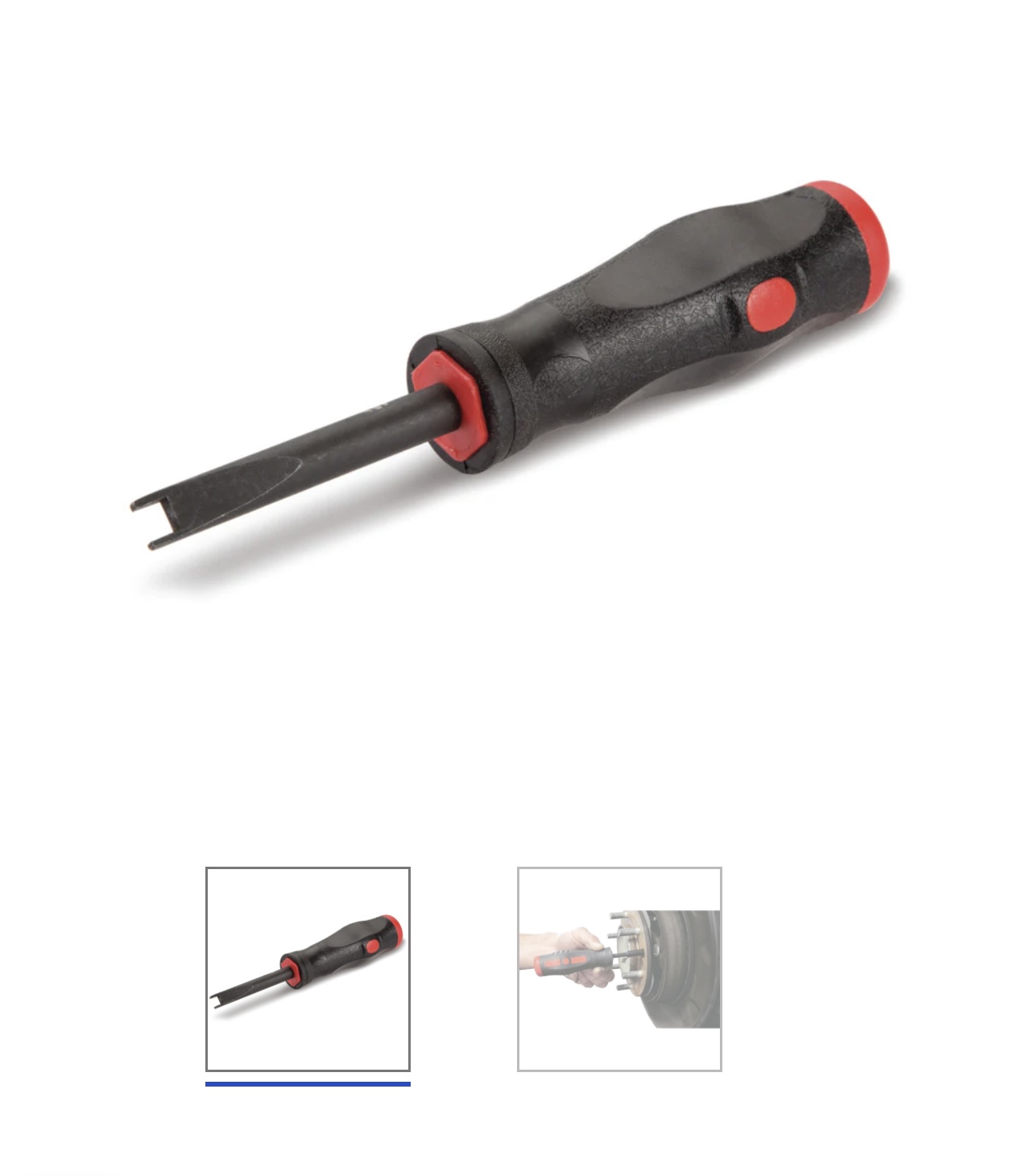

I’ll be replacing my rear brake pads, rotors, and parking brake shoes later this month so I’m looking for advice on tools and techniques to make it easier for someone who hasn’t done this in close to 20 years and the last time I messed with brake shoes was on a 62 Chevy pickup. I’ll be picking up one of these parking brake tools help with the retainers.
I’ve already got wrenches, ratchets, sockets, and pry bars. Anything else you guys would recommend? I’d rather take the money I’d spend on labor at Toyota or a shop and buy the tools to do it myself. If I delve into replacing the calipers I’ve heard that bleeding the brakes afterwards requires techstream. Is that true?
