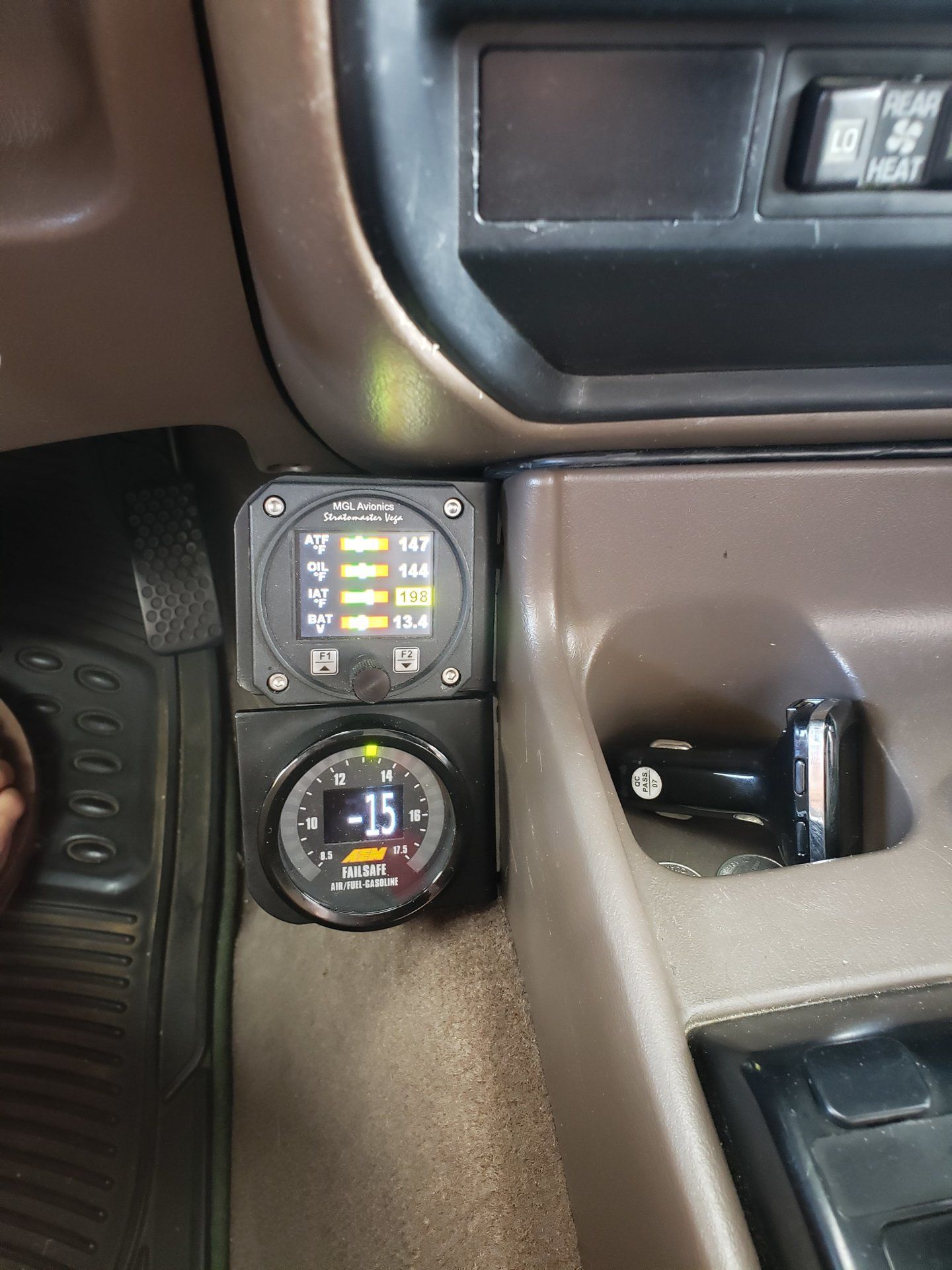

Gauges: AEM failsafe for AFR and boost, MGL TP-3 4 channel aircraft gauge (trans temp, oil temp, turbo compressor outlet air temp), scangauge for engine coolant temp etc

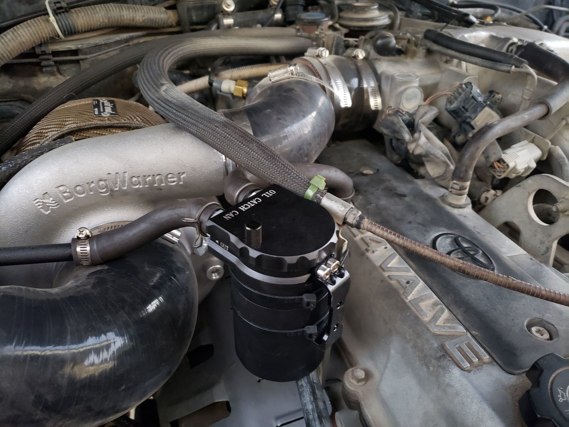

Plenty of power on the 395 for the climb from Bishop to Mammoth, it just doesn't notice elevation. MPG doesn't seem much different either way. I'm sure I burned extra fuel just having fun but I don't really track MPG closely and carry a couple of jerry cans. I did see some high intake temps post turbo (~200 F) at one point after some hard pulls, but it drops quickly after. Maybe someone can comment on the significance of these numbers. Mostly seeing post turbo intake temps about 50 to 60 F above airbox intake temp. My cooling system is in good shape and I have seen higher coolant temps but never over 205 F. Did some hard pulls with the AC on without too much temp increase. Oil temp at the peace pipe was close to coolant temp for the most part. Transmission temp does not seem significantly different from pre-turbo numbers. AFR bounces around near stoich most of the time and dips around 10 under heavy throttle. The only time it leans out above 15 is when the throttle is quickly closed. Boost has maxed out around 7psi, that I've seen. My boost/afr gauge location sucks and I'll be moving it shortly. There's an oil stain on the bottom of the compressor that I'm attributing to oil from the crankcase vent. I just installed a catch can and will see if it makes a difference. More to come!
AFRs after the throttle closes of 15 is really a non-issue, and AFR's close to 14 at cruise is also a non-issue. The only time you need to worry about AFRs is going to be when the boost is over say 2psi. I will even see AFRs close to 18 if I am coasting down a super steep long hill.
