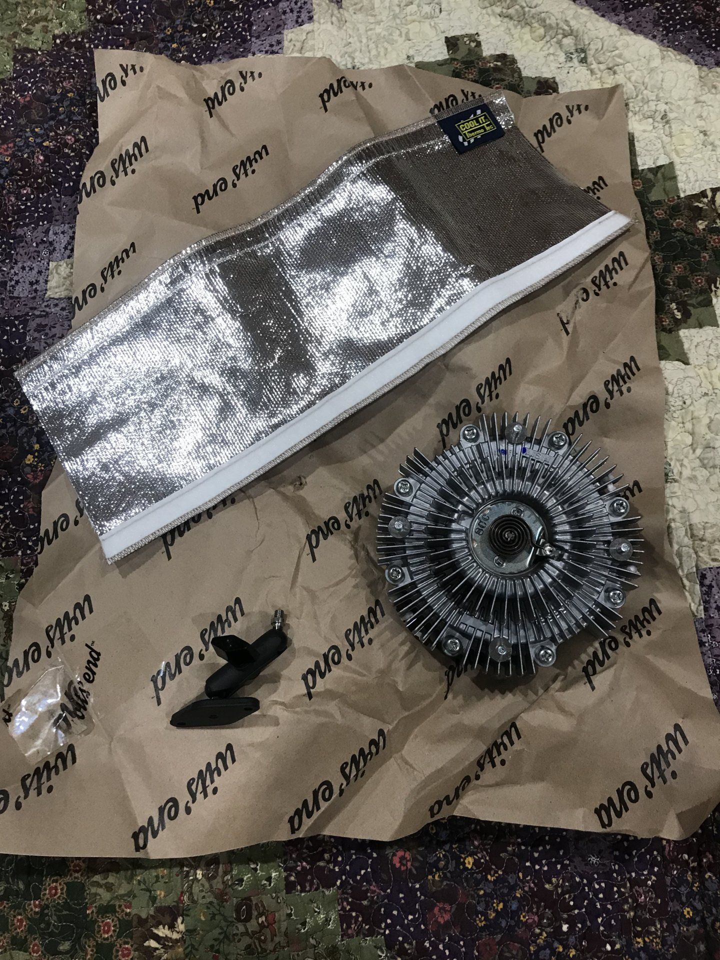

Joey’s modified fan clutch is out for delivery today too. Super fast shipping. 👍🏻

I’ll update the gauge thread tomorrow, rig is going back under the knife for Trans-Go kit, and fan clutch for total piece of mind. Oh, & wrap the main engine wiring harness.. I’m OCD. View attachment 2091248

For the Thermo tech express sleeve - did you purchase the 3' sleeve length or did you find a source for less than

bought 100’ so I just trim off what I need.
ok - are you supplying that in the kit or is that something to source on our own?
