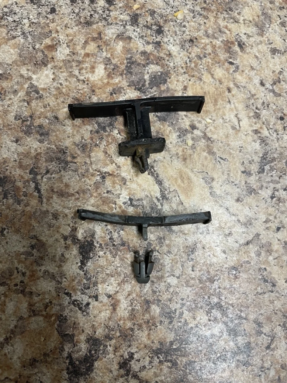

I replaced the ABS lines on my LC since some of the connectors were broken.
Where do I buy these? And what are they called?
Where exactly did they come from? Some of those ties come with the harness
only but there may be a substitute.

I have done a search on ABS wiring harness. It returns 23 pages and nothing on these fasteners. I dont even know what they are called.
They are wire harness clips.
If there is a 5 digit number someplace on the clip, then you add 82711 to get the complete 10-digit part number and then order from Toyota.
If they do not have a 5 digit number on them they are not available separately from the harness itself. Then you just make something up to keep them in place.
