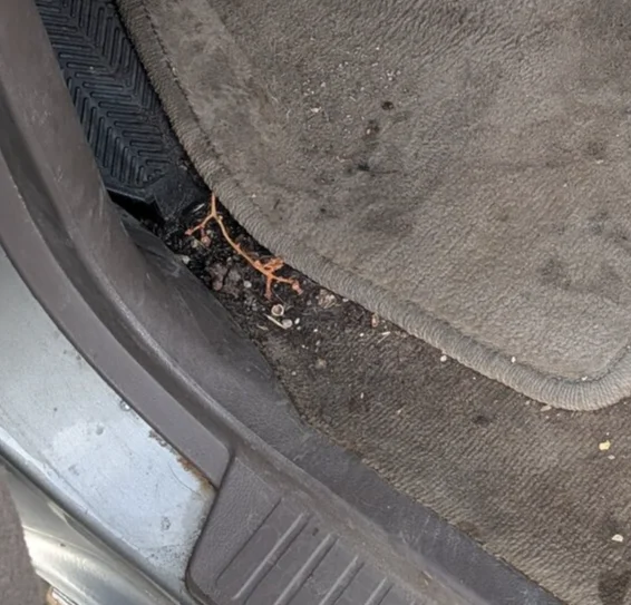

Agree with much stated above. If I were to buy it I would consider it an extra vehicle and not get emotional about it (meaning keep a strict budget). Ad or repair what is needed and nothing more. From the pictures, it looks as though the knuckles are weeping but at that price and use case just ensure you keep grease in there and call it good.

First things to check are the knuckle studs on the bottom of the front axle to make sure they are tight and not coming loose. Particularly the RF knuckle. They are known to come loose and tear up the RF corner and axle.
