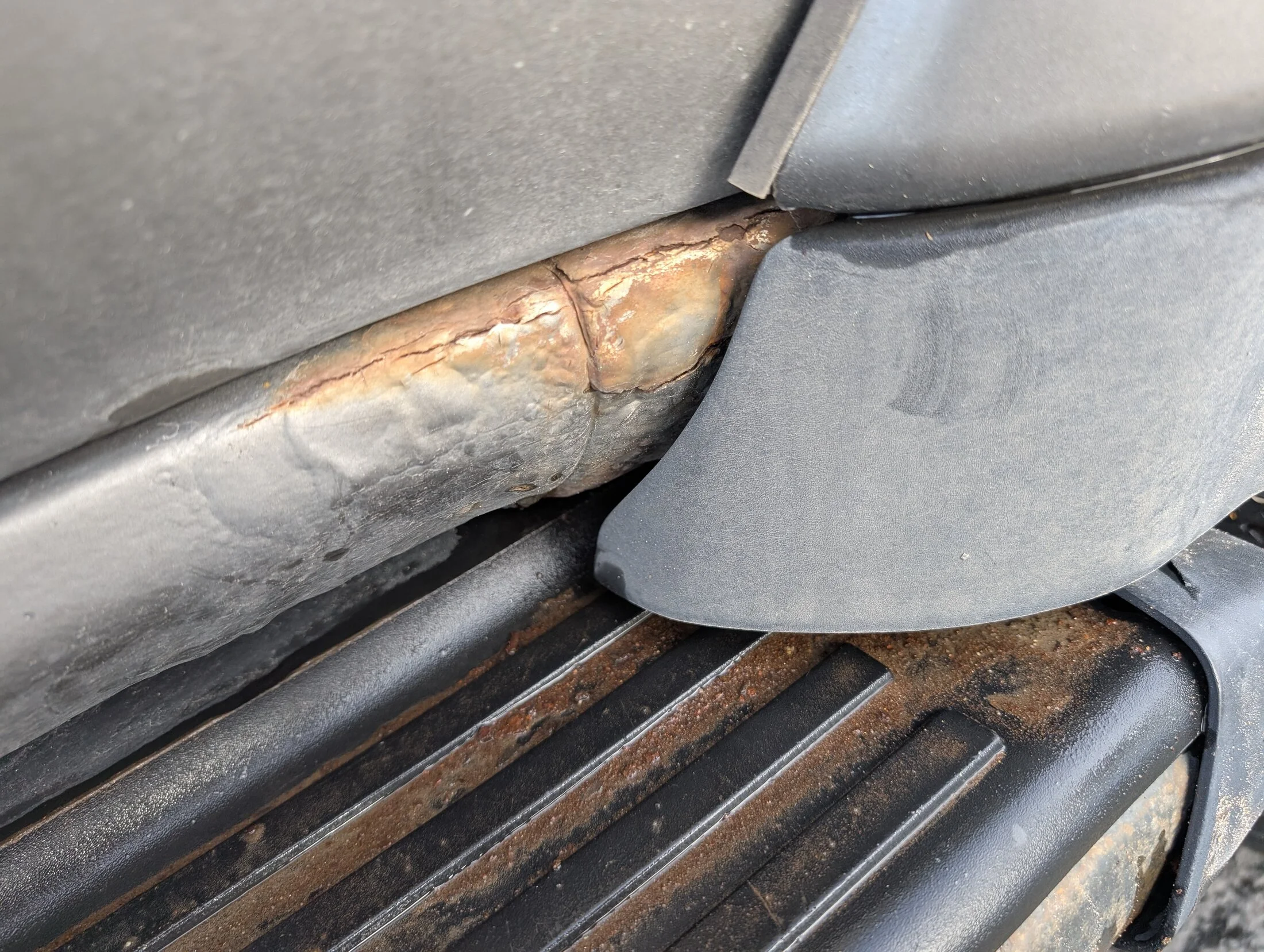

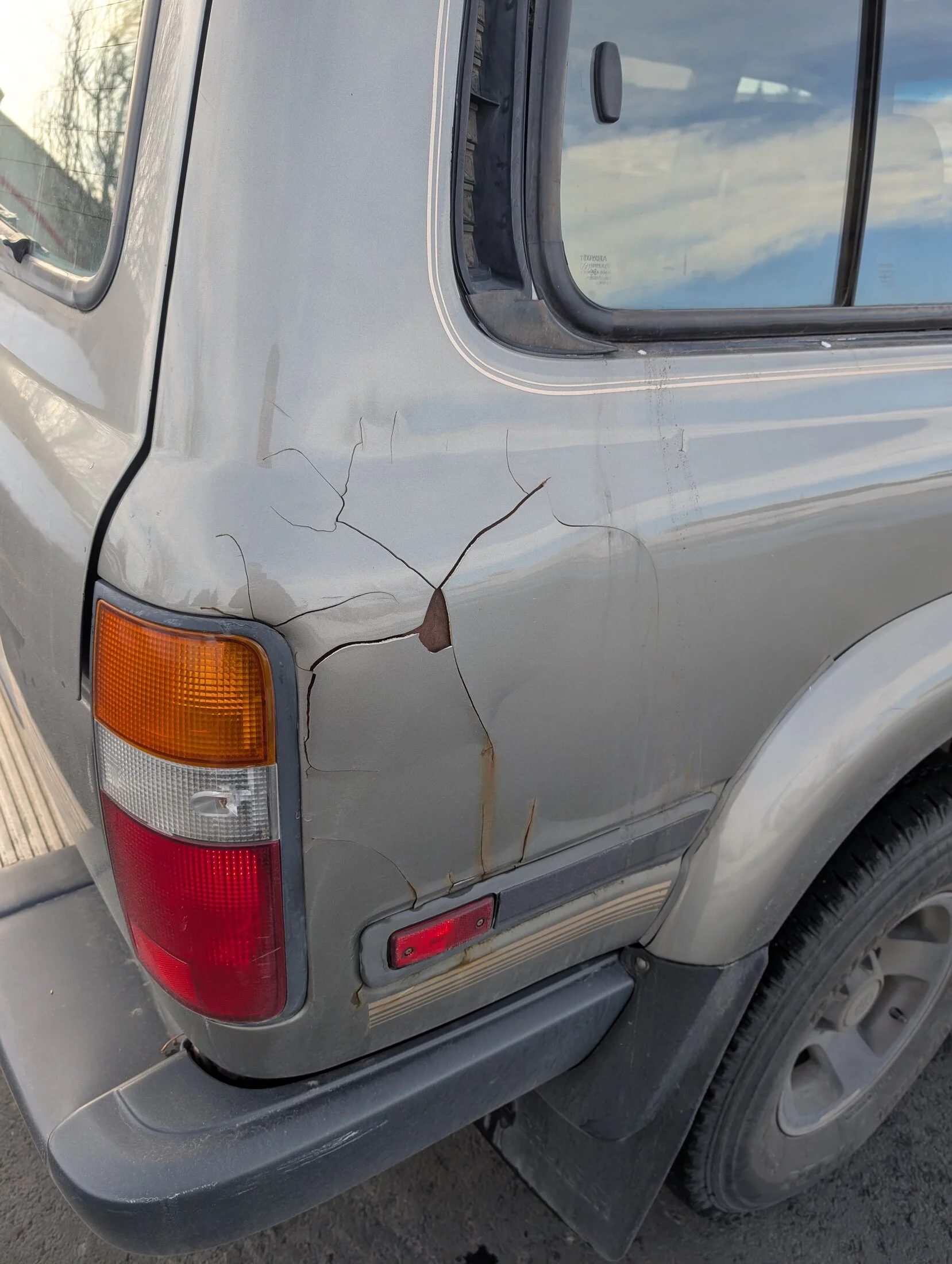

Hi Guys,
I'm picking up this 40th Anniversary LC tomorrow, after a very successful test drive today. I think I have a good line on everything it needs, but this. Do you know what's going on here? How to fix it?
Thank you!
A bodged repair with too much body filler leading to paint cracking and water making its way in. Horrors lie beneath no doubt. Fix it with either a lot of skill or a lot of money.
Little skill here, and I'd like to spend my money elsewhere to start (cleaning and repairs, not fashion accessories). Is there anything I can do to delay additional damage for a bit?
Not really as water gets down there and rots it out. You could chip it all off and spray some temporary paint over the bare metal, but it would probably look hideous and looking at tha quarter panel it looks to be extensively damaged, round the light cut-out, down to the swage where the rear running light trim is, and probably down to the wheel arch.
Unless it's a dirt cheap beater, if it's not too late, run like hell. That will cost far more to put right than you would spend just buying a better example in the first place

Don't Don't Don't assume that there is not more buttfuckery about that rig that someone has attempted to hide. Even beyond the 46 lbs of body putty slapped over dented and rusty metal. And I promise you... that corner is far worse than you think it is
This is where I am gonna sound harsh... If you had to ask what was going on there and wonder how to fix it... If you did not immediately realize what a hash up you were looking at... I would really suggest getting someone else to inspect the rig for you before you buy it. I'd bet a hot stripper's Saturday night take that they would find a long list of other... lets just say "defects"
And... this is a parts rig or a rig to beat and bash in the rocks. This is not a rig to buy with plans on making it a pretty daily driver.
BTW, does it have a salvage title? Around these parts, repairing that 1/4 panel properly would have pushed that rig into the "total write off" column so far as an insurance claim was concerned. Then it would have been sold at auction to a shady "rebuilder" who would have actively tried to find sellers that did not know to be suspicious of... shady rebuilders selling seemingly pretty rigs with salvage titles.
I know '80s are few and far between in MT. If the seller let you think this was some sort of "body delamination" that was no big deal...I still say run, don't walk from this one.

Exactly what I was thinking. Only a crook would do a repair like that to a vehicle with any value, so I assume it's a bag of :poop: with a rotten chassis or an engine that is ready to expire.
That said, 2.5k for an 80 seems like nothing to me (in Asia), I expect it's worth more in parts.

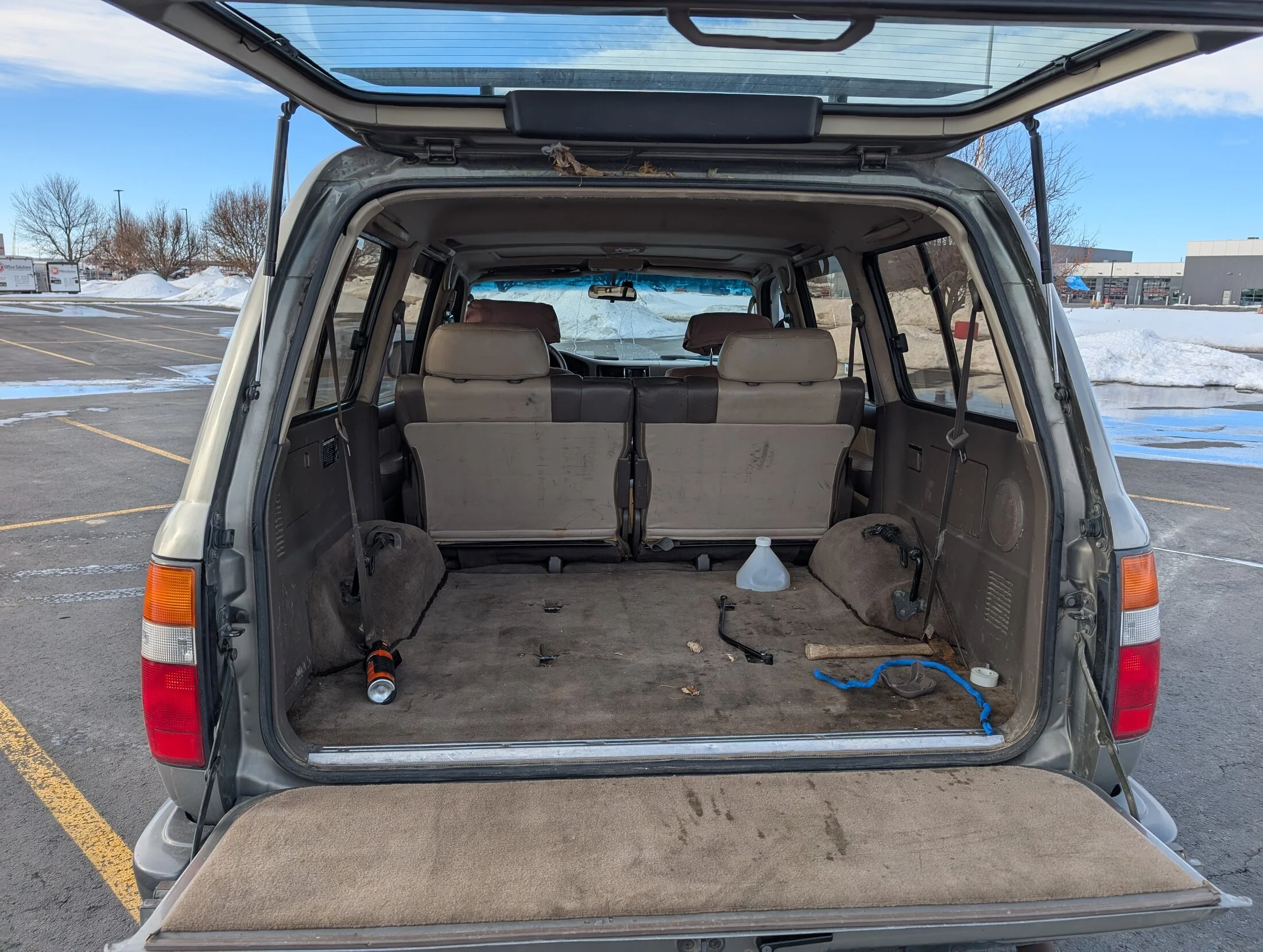

You could remove the cargo area panel and look at the backside of the quarter panel but the photos above already show it's had a good whack
which was "fixed" with a ton of bondo. You then have to wonder what else has the seller done to try to sell it ie: did he dump a bottle of head gasket
sealer in the cooling system to hide a an expensive head gasket leak repair??

Thank you all for your responses. Mark, you're not being harsh... I am obviously naive when it comes to body work and bondo, but I'm hopeful that's about where my ignorance ends.

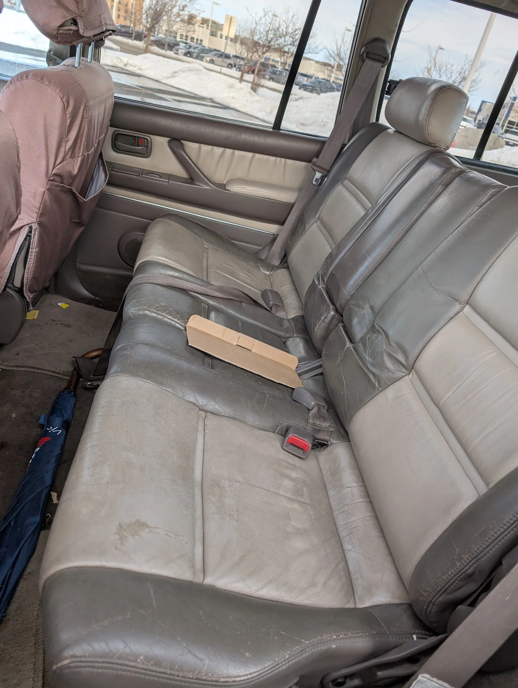

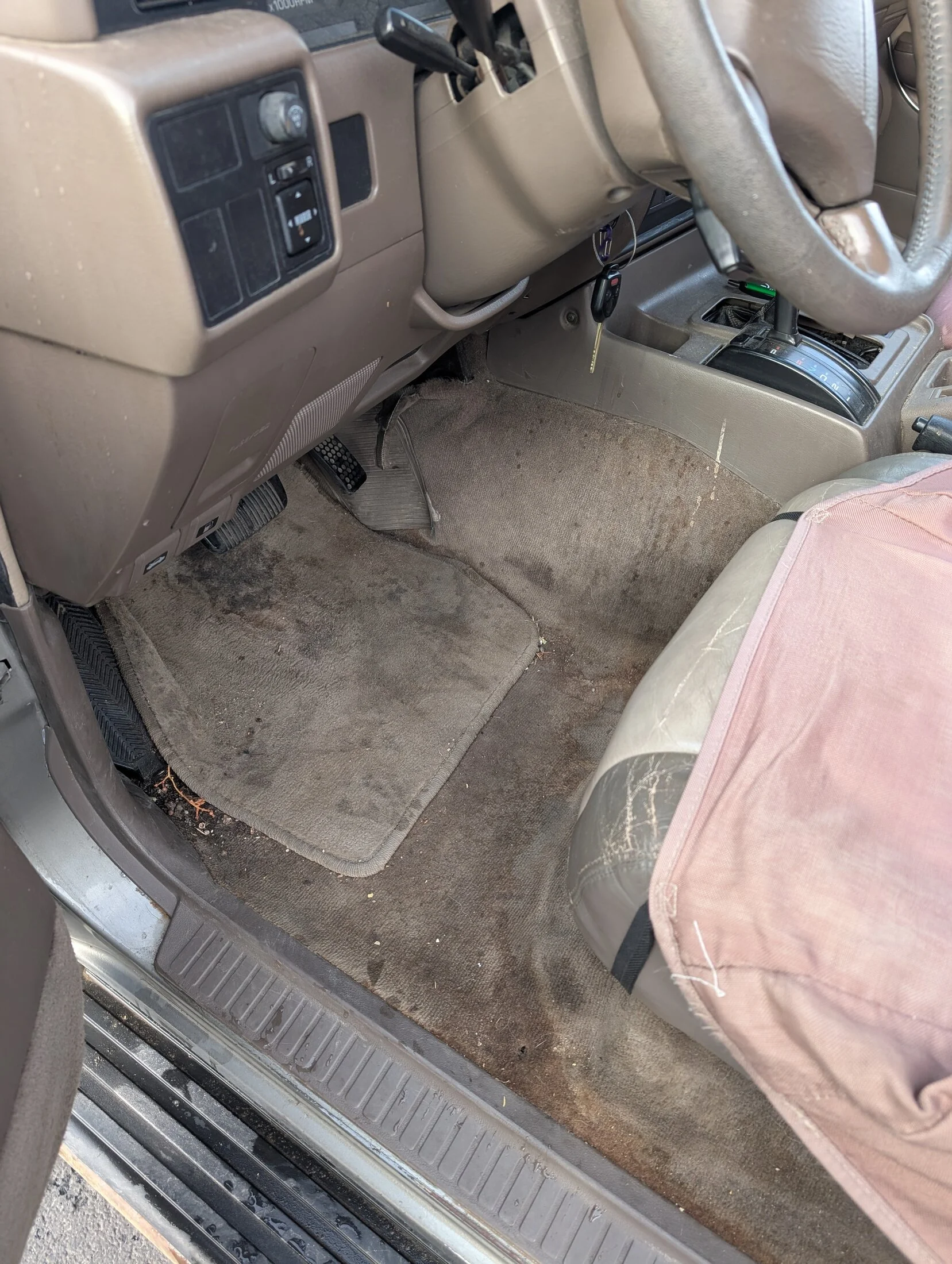

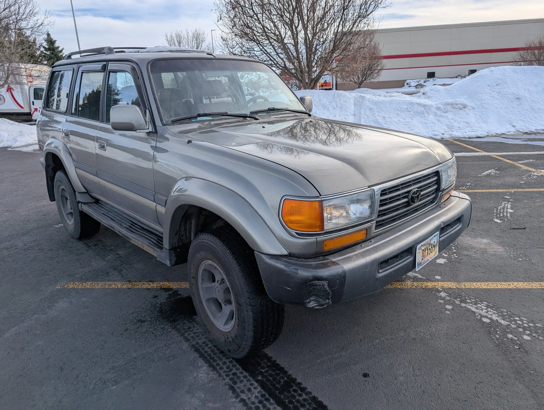

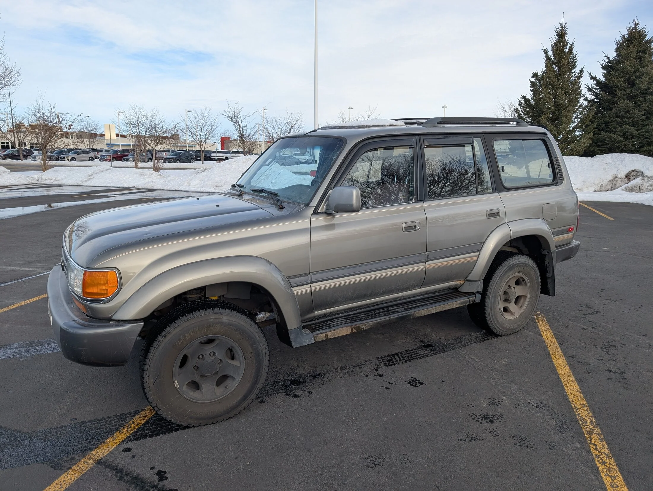

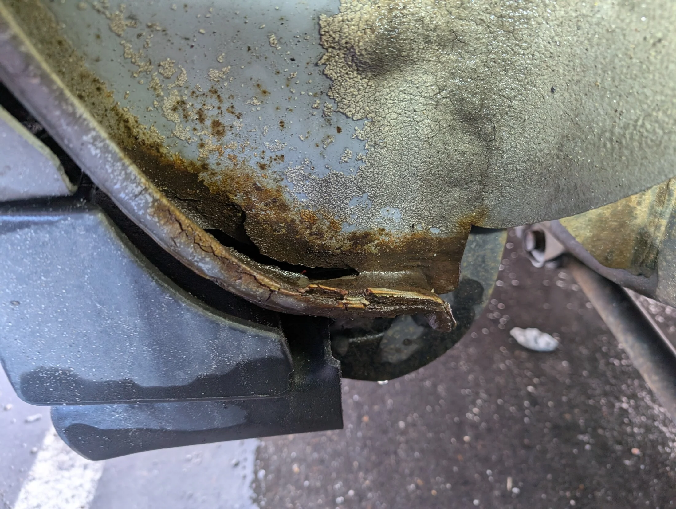

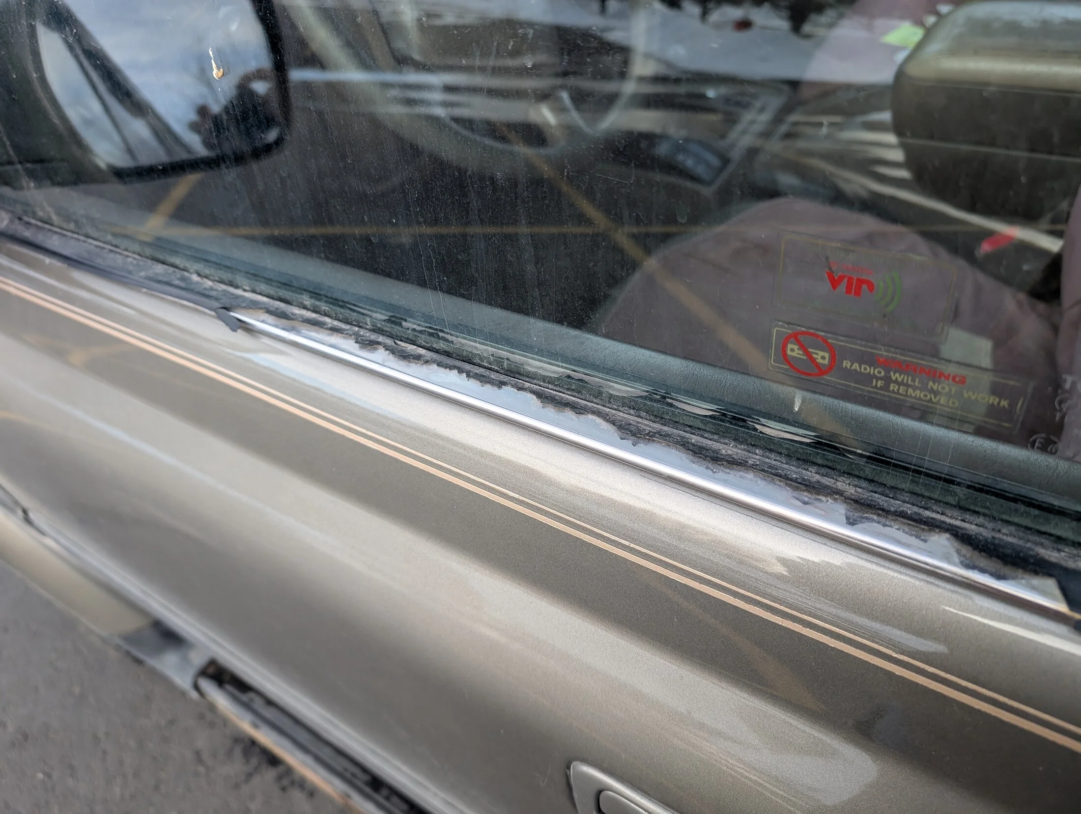

Here are the pics of just the bad stuff. I drove it on the highway and on the ice, and everything felt pretty solid.
I didn't take any pics of the engine bay.... There was a little oil seepage on the front above the top pulley, but the hoses and everything else looked great. The tranny and Tcase were dry.
