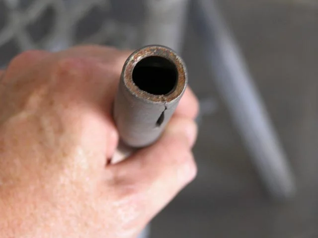

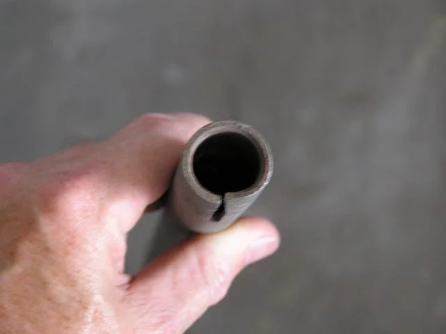

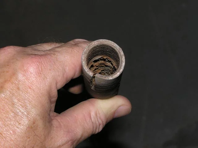

I've included some pix below of the ends of the rods where they were run over. The shop foreman intends to repair them by taking a torch to the ends, and whacking a cold chisel into the slot on each to open them back up. Then he wants me to bring him the old tie rod ends to attempt to force them into the threads while heating the rods with a torch. He claims this will take care of the flattening,and make it possible to put my new TREs into the rods. He is probably right that this can be done (apply enough force and heat...) but I wonder if this is really going to make the rod ends right again, and if it is safe. Does anyone have suggestions, comments, etc. about this proposal? I still have the old TREs, but am reluctant to allow this "fix" until I know if it is safe and permanent.
That was the relay rod. It is the worst of the two. Here's the tie rod where it was clipped.

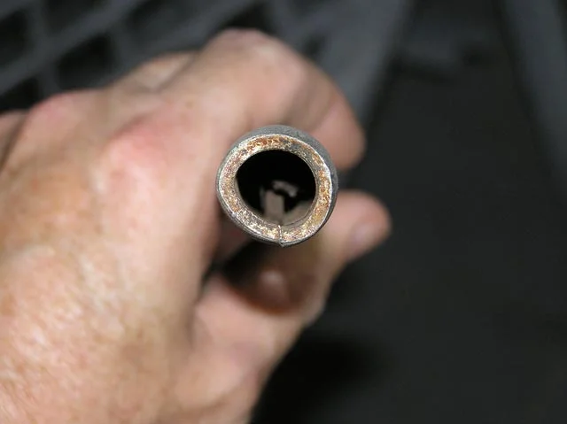

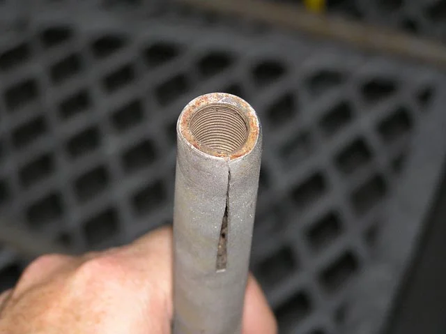

The tie rod and relay rod have been "repaired" by heating them with a torch, and opening the slots up with a chisel. The relay rod (worst damage) was really torched and an old TRE from something else twisted in, with the result that the end is now bulged, and there is an interesting kink in the end of it, so the rod is no longer straight. The foreman thought this would be "good enough" (I'm getting very tired of those two words :rolleyes:) - he recommended putting the new TRE in there and clamping it down really hard.
Then, the cavalry arrived! :D Chris, the sandblaster guy, called and said he was heading down to look at the project and asked how it was going. I related the newest tale of woe. He said not to worry, he would run by his home on the way in and bring something I might like. :confused: :hhmm:
Sure enough, 10 minutes later, he walks in with a brand new Toyota OEM tie rod and relay rod in his hand!:confused:!! We check them out - same length as mine, same diameter. Try out the TREs - perfect. LH and RH threads just like it should be. I can't figure this out :confused: Turns out, about 4 years ago, he mangled these items in his BJ42. Went to the Toyota dealer here in Lilongwe and ordered a new set. They got him the set for a LHD FJ. He took 'em back cause they didn't work for him, and asked them to replace them with what he had actually ordered. They wouldn't take them back... this is not at all uncommon here. If you get the wrong stuff, no matter who made the error, it is virtually impossible to return anything. He placed a new order, got what he needed, and just put the FJ parts away. When he heard what I was in need of, he just pulled 'em out and gave them to me. :bounce::D:bounce2: What a Guy! Nice bloke! :) :clap: :clap:

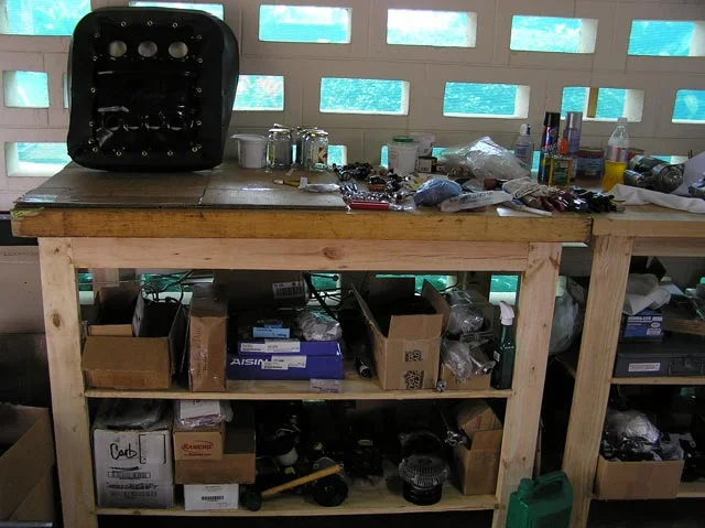

Still plugging away at the small stuff, getting ready for the mule to finally get out of the panel beater's and back where I can start the build up. Got the front seat bottoms rebuilt. New foam from SOR. The covers are only about 8 years old, since I had them replaced when I couldn't stand the tears anymore. I've been keeping them in good shape with sheepskin covers. I used hog rings to refasten the covers, but I don't like what they do to the vinyl, so I grommeted the previous holes with brass. It may last longer that way, but regardless, it makes me feel better :)
Also finally have workbenches in the garage. The tops were old ones from our facilities maintenance shop at the embassy. We replaced those, so when no one else wanted the old ones, I took them home and hired a joiner to build legs and shelves. Pretty nice. I won't have to do everything on the floor, on my knees, now.:D Good thing - my bones are getting too old for that.
