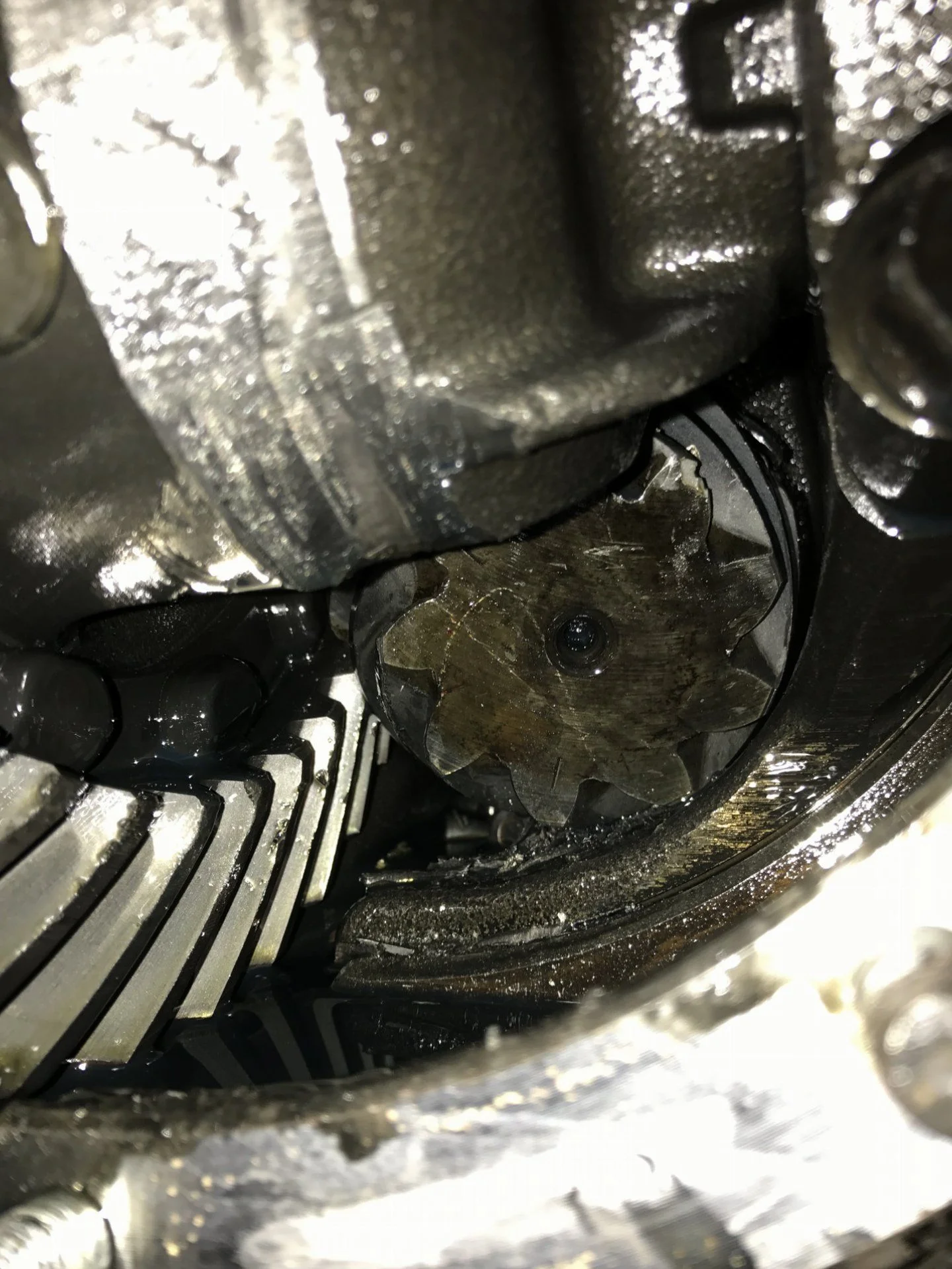

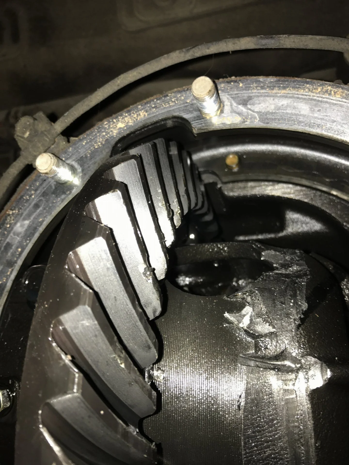

Opened up the differential case to see the carnage. This must have stopped the truck in a hurry. It looks like there was less than one rotation before the loose pinion jammed up the works. The diff needs to come out to free up the pinion but that can't come out until the axles are out of the way.

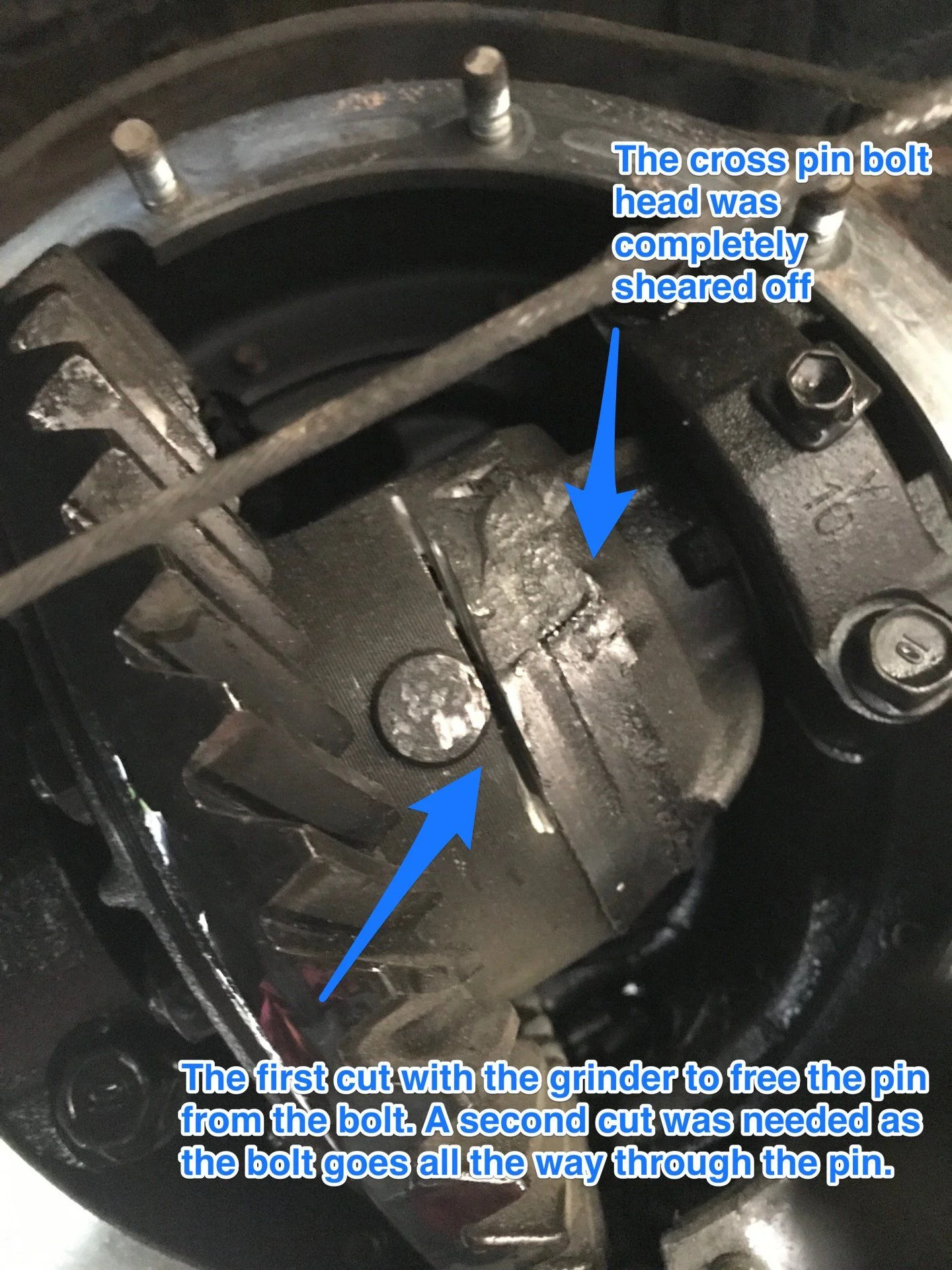

What normally would be a simple removal of the cross pin bolt turned out to be a lesson in operating a grinder in tight spaces. The small cross pin bolt that holds the pin which keeps the axles from tossing their retainer c clip was sheared off in place. Some grinding and pounding was needed to drive out the pin before we continue with normal diff removal.

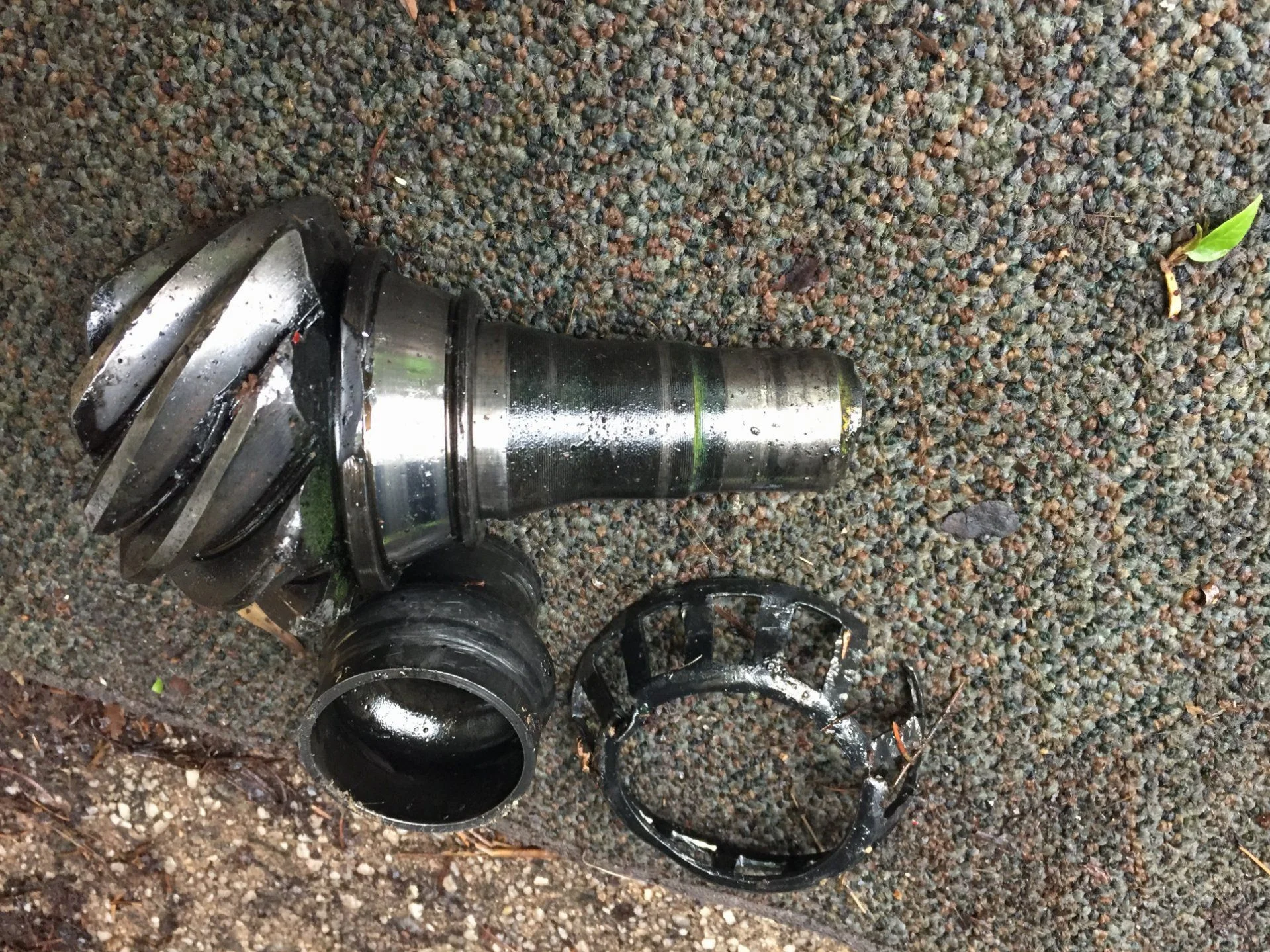

Once removed, the carrier was next so we could get at the pesky pinion. The lower pinion bearing was completly obliterated into a pile of bits and pieces at the bottom of the axle housing. Still not sure if the TCase or the pinion bearing was the source of failure, but with the pinion removed the diff housing went back in temporarily So we now have a roller to work on!

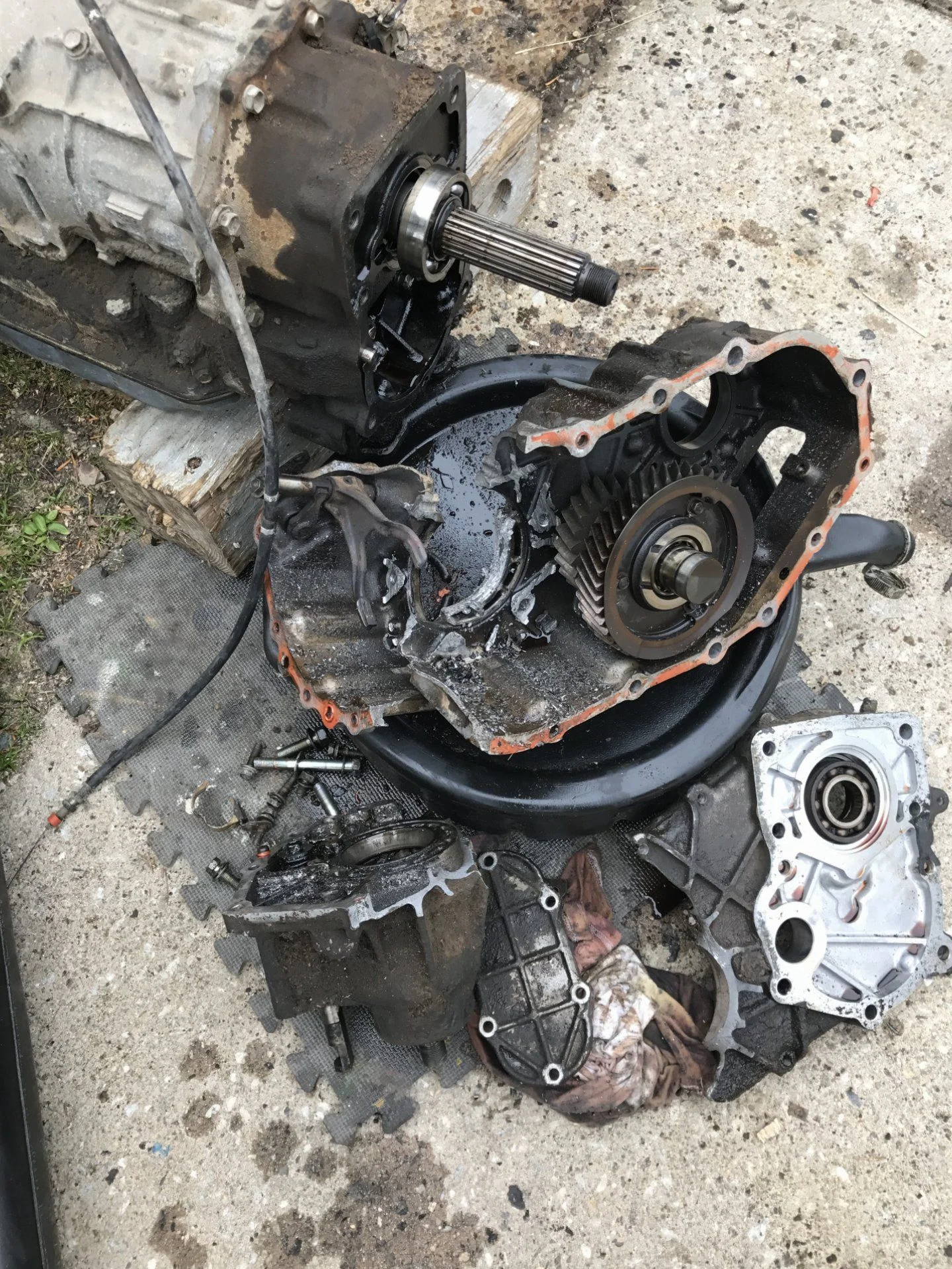

Did someone say split case?
With further investigation I'm convinced the tranfer case was running bone dry. The shift fork shows signs of extreme heat buildup (just shy of welding itself in place) and several gears have surface rust. Also, extensive use of rtv on the case and silicone on the output flanges shows some amateur battles with leaks.
The shockwave of destruction extended up into the transmission bell housing and the mounting plate behind the flex plate where the starter mount. Absolutely no luck in getting a starter to mount up with or with a transmission. The motor looks fine but to make sure we spent the day assembling a new donor transmission and Tcase. Got it all bolted up late last night just shy of firing it up again. Should have it all patched up tomorrow evening.

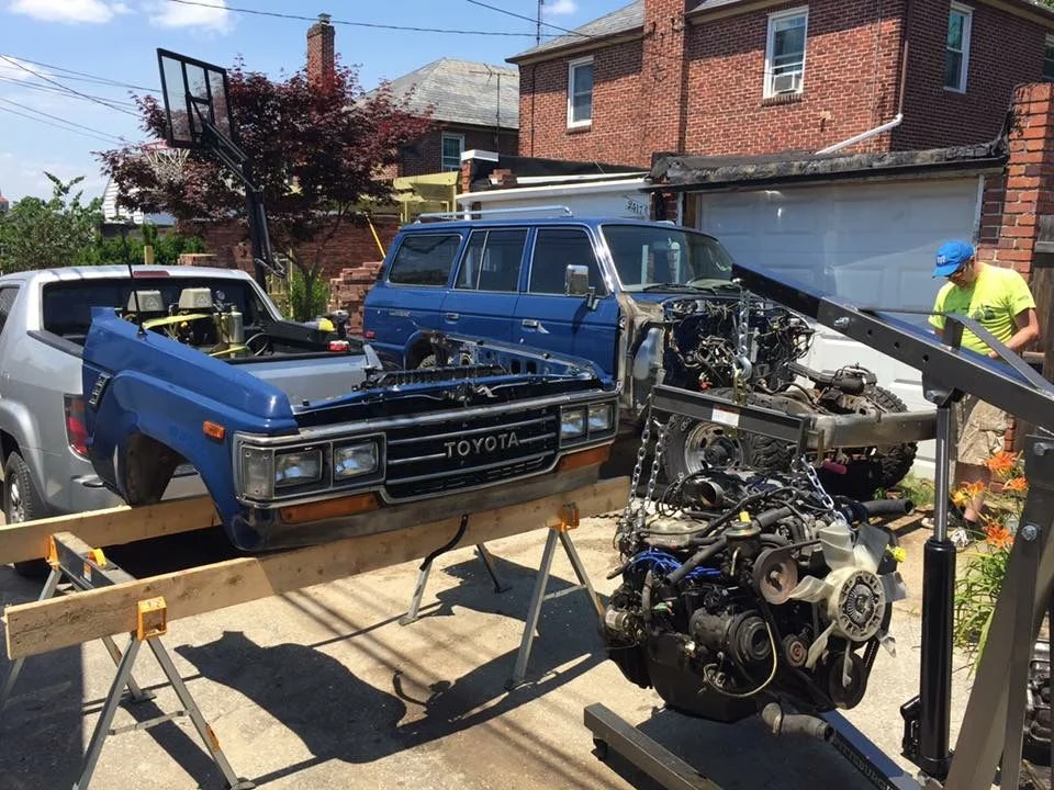

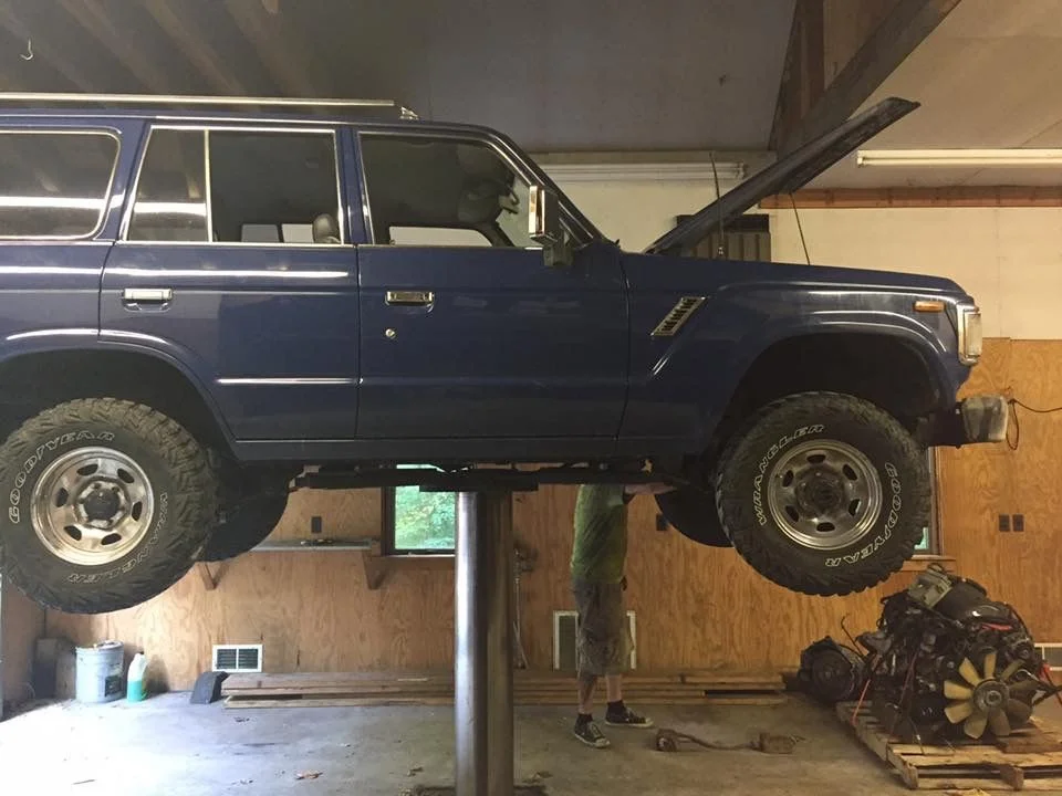

Before hauling blu up to the shop where we have a lift but more importantly AC and the space to perform bulk of the work, we decided to pull the drivetrain here in my alley. Shadetree mechanics at their prime!
Man this shop is some fun! The center lift makes things a bit tricky but with the help of four 2ton stands from the HF we separated the 28year marriage.
Cue up your favorite breakup song.
Don't blame me for the vertical vid. I am the jerk working the lift.
