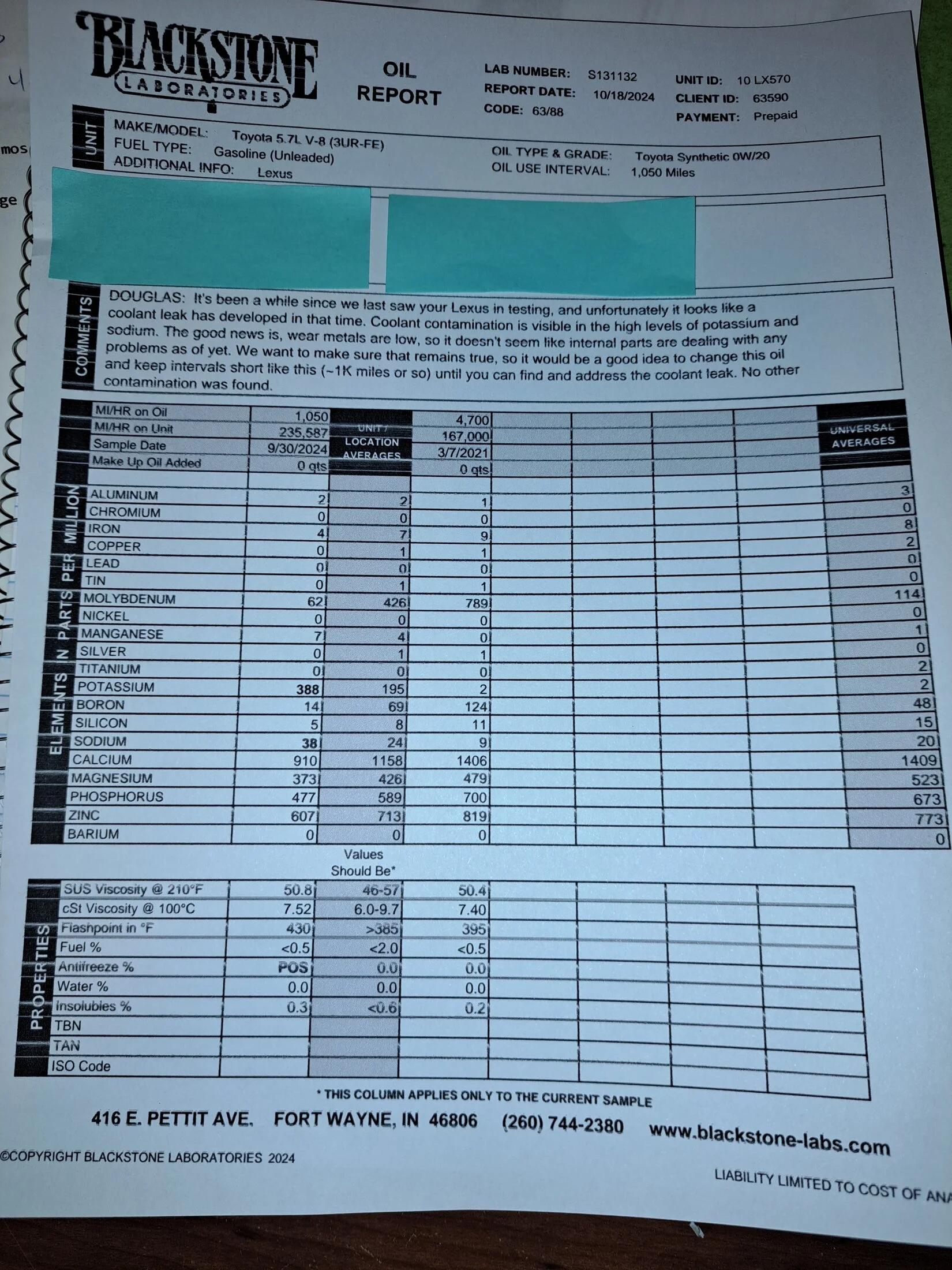

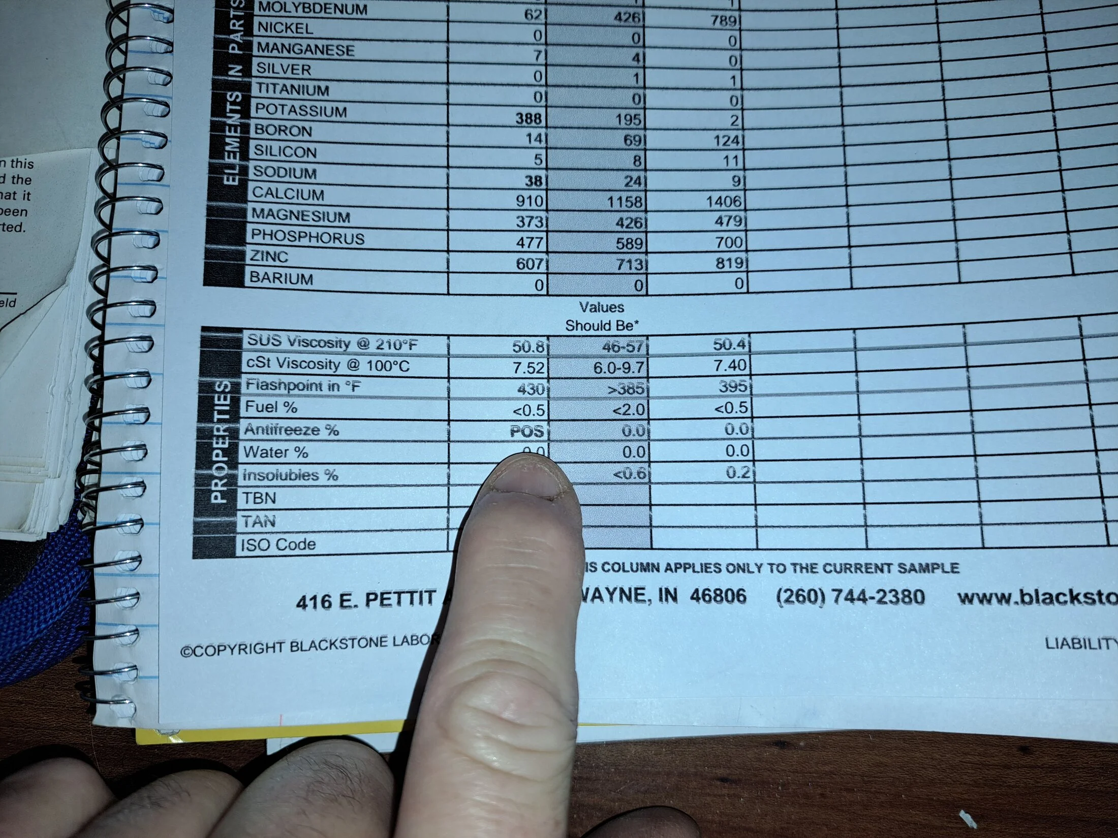

Several posts ago I shared my current situation on my 2010 lx570 with 235k that developed a misfire cylinder 4. Further diagnostics showed head gasket issue. Decided to swap in an engine with 45k on it. Prior to removal of the damaged engine I drained some oil (the oil only had about 1k miles on it since it's last oil change). Sent the sample to blackstone and sure enough they found coolant in the oil. Some of you wanted to see the report so here it is.

Thanks for posting the results. It makes me wonder if you were doing regular oil analysis with each oil change, how far in advance coolant could be detected in the oil before problems start showing up. My guess is there wouldn't be much advance warning at all, though. However it is good to see that the oil analysis picked it up at this stage.
So about $10k total for the swap? Wonder how much it would have been to just do head gaskets? But then you'd have to deal with unknowns of if the heads and/or block warped. Has the shop tore into the old motor to check? Did it have the same pattern of failure at the coating of the coolant passageway right next to the cylinder? Based on the other metals and per the comments in the report the engine may still be in relatively good shape otherwise.

Yeah with the mileage it just made more sense to me to swap the whole engine. If I hadn't found one with such low mileage (45k) I probably would have fixed mine. I had a lot of tapping from the timing chain tensioner so would have had to address all that too. Amazing how much quieter this engine is. I sold the old engine to the shop that did the swap and he's supposed to send me pics once it's torn down.

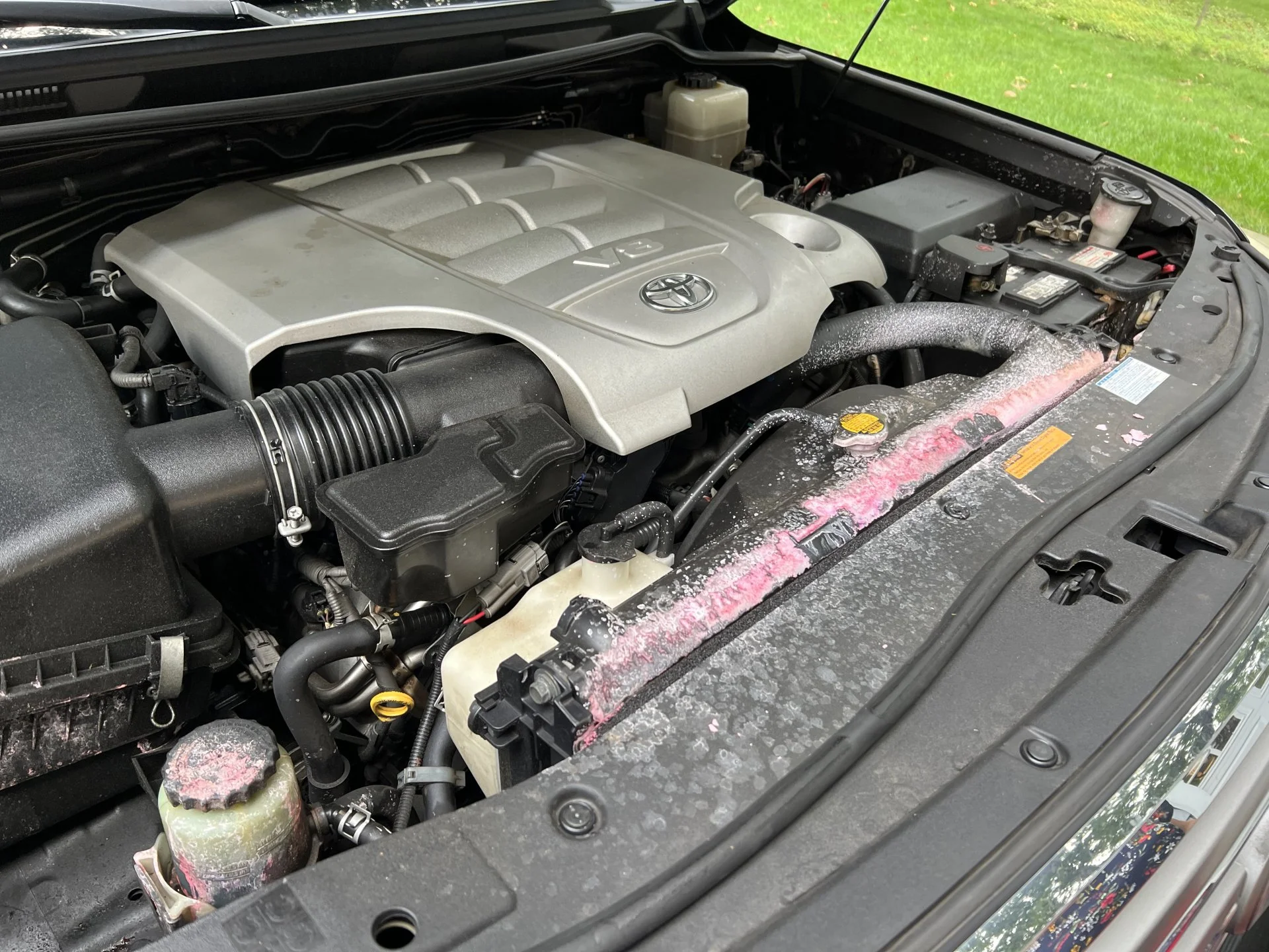

IMO it is not the coolant or low pH of the same (several of us have measured and do not see a drop in pH). It is the factory installed radiator until late 2018 which cracks at the top and an overheating event warping the block (see example pictures below from other forum member).
Getting the latest OEM radiator and potentially an OBD2 device which sounds an alarm when temps goes above normal (like the UltraGauge MX v1.4) are more direct measures to prevent this.
Having said that, I am not going to ignore coolant however not increase frequency of change beyond radiator only every 50k miles or about 5 years at the pace I am going at the moment. Others have suggested every 30k miles which would equate to an approximate full flush every 100k miles per factory recommendation. Eitherway is probably fine, perhaps every 30k miles in your case after the failure with your original engine.
