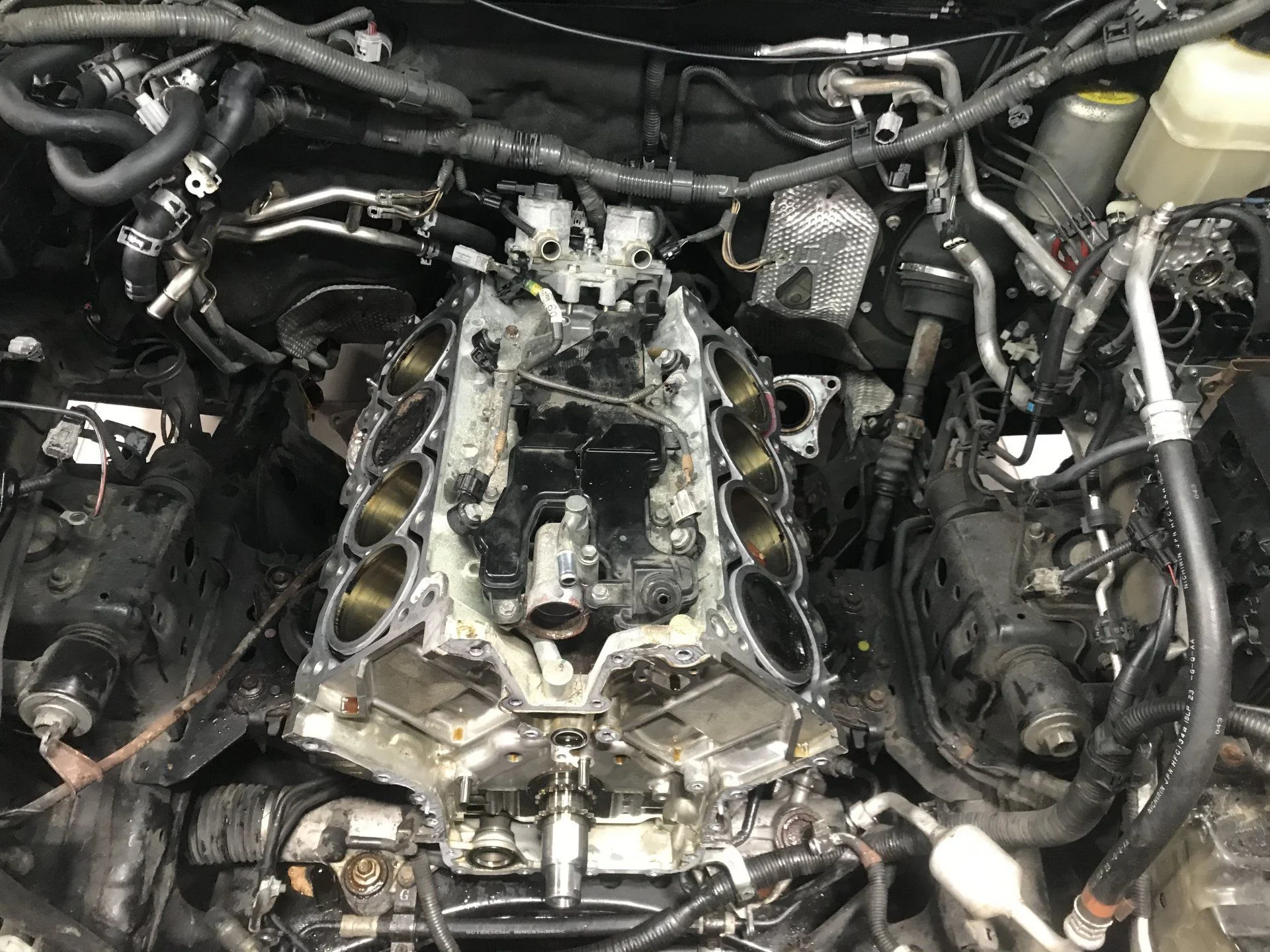

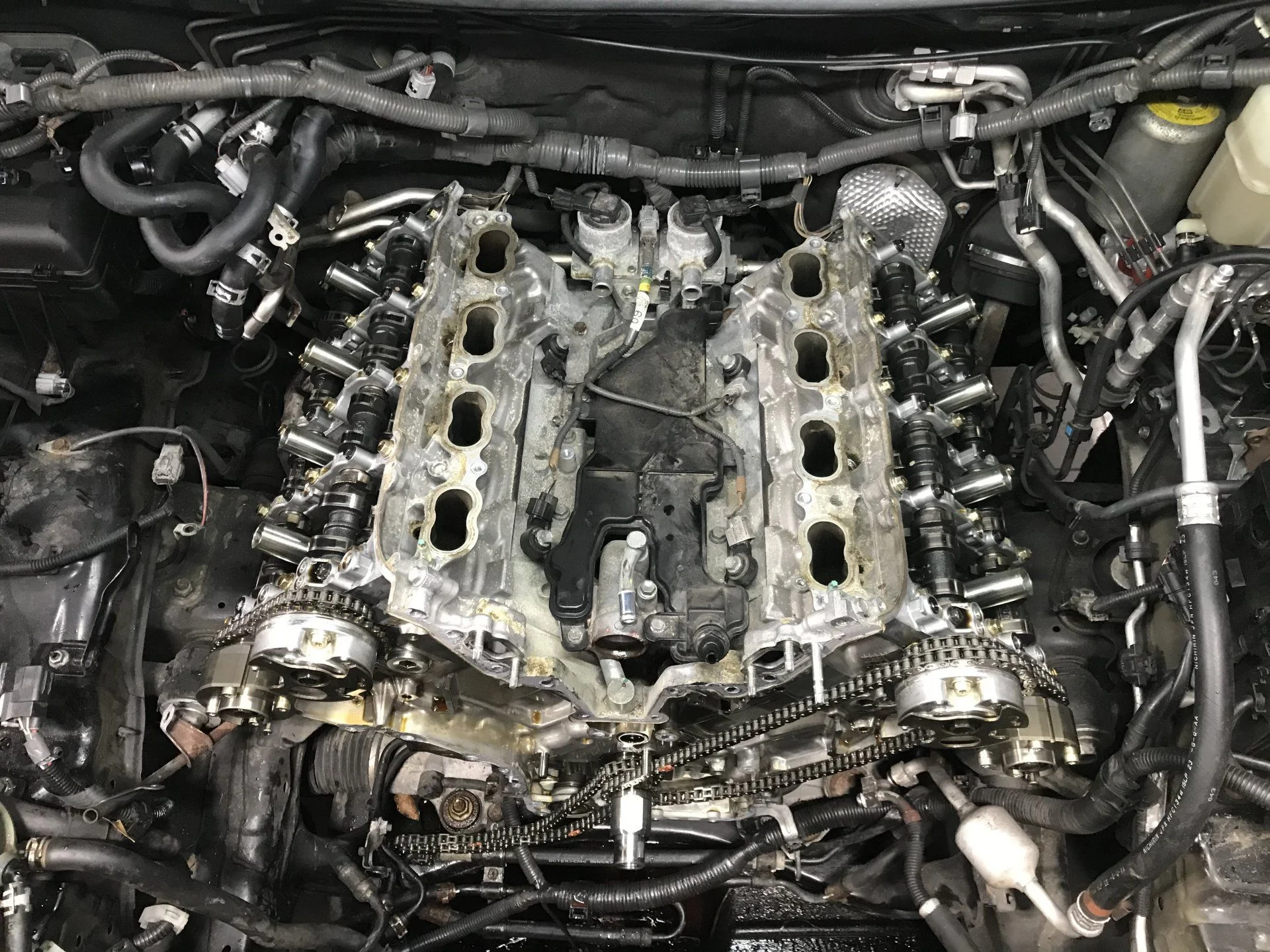

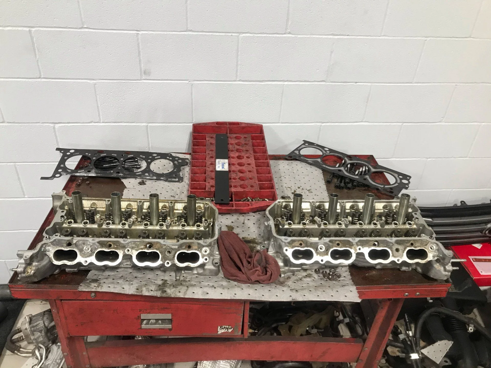

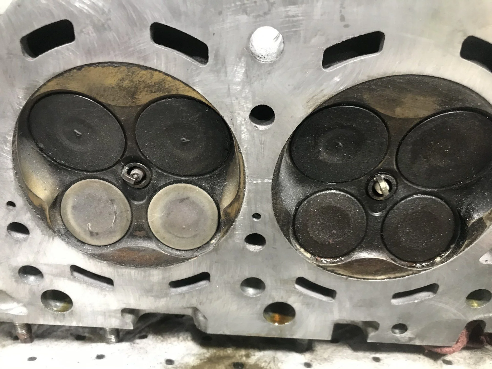

Here’s whats going on currently. Heads off to the machine shop tomorrow.
Wow, you don't realize how massive these 5.7L engines are until you see the guts. What's the machine shop going to do?
That looks like an awful lot of carbon deposit on the cylinder heads that show and the valves for an engine with such low mileage. I'm also confused why some of the valves are dirty and some are spotless... artifact of a leaky head gasket? Then again I've never broken down a Toyota 5.7L
