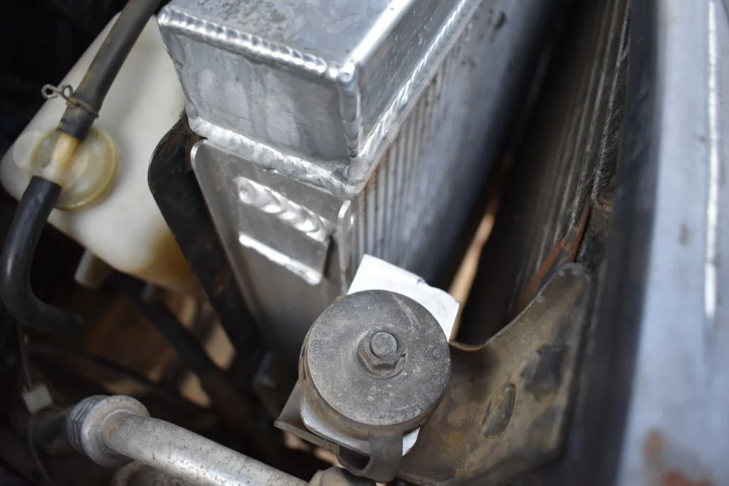

I've had 2 of the welded aluminium ebay radiators fail on me. On my BJ73 3 of the 4 mounting brackets broke off on a remote track in the middle of nowhere. I tied it up with wire and limped home.
On my Suzuki Sierra (Samurai) it split where the top of the tubes meet the tank, 2 days into a 3 week trip.
Both were around 6 months old and neither of the eBay sellers held up on their advertised warranty.
On the plus side, they both cooled really well.
The Sierra one replaced a recore which the straps had broken off of, crappy solder job. As you can imagine, I'm pretty keen on just buying a new copper/brass these days.
