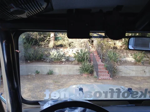

I finally pulled the trigger on a new driver seat.
I went with the Procar Rally and bought the Procar mount (from Man-A-Fre since they had one on clearance).
Old seat and new seat
View out the windshield, camera approximately at eye level
View in through the rear hatch
I the Procar seat sliders have three heights they can mount to the adapter frame. I was going to go with the lowest setting, but that was interfering with the seat slider. I chose the middle setting which is about 3/4" higher.

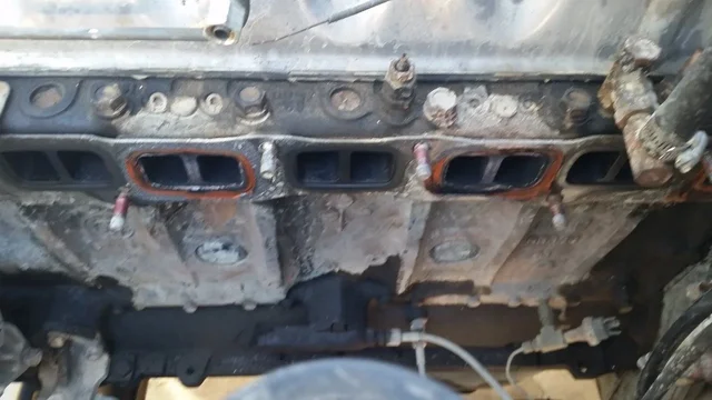

Removed the intake and old headers today.
It looks like at some point in the past 10 years I had a head gasket coolant leak. It also appears that my oil pressure regulator has been leaking somewhat.
As I can't tell if the coolant leak is recent and I haven't seen a loss of coolant in the overflow or radiator, I'm inclined to leave that alone.
The oil pressure regulator on the other hand will likely be resealed while I have access to it.
