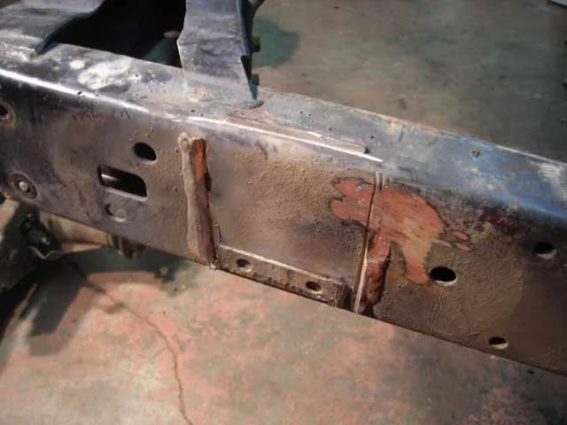

Started going to town really prepping the frame, removing all body mounts and getting it ready for sand blasting... Had to cut all the body mounts off. I probably had a good 2-3 hours total of grinding... Hands felt like they were asleep when done. I have a cheapo Makita $60 Home Depot grinder. Thing is like a Toyota, just keeps going and going. Will be my second pig built with it I suppose, probably my favorite / most useful tool, has hours and hours on it and still truckin :)

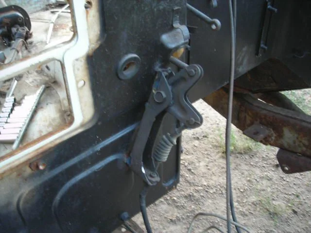

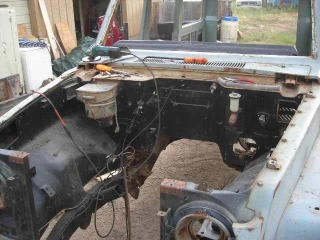

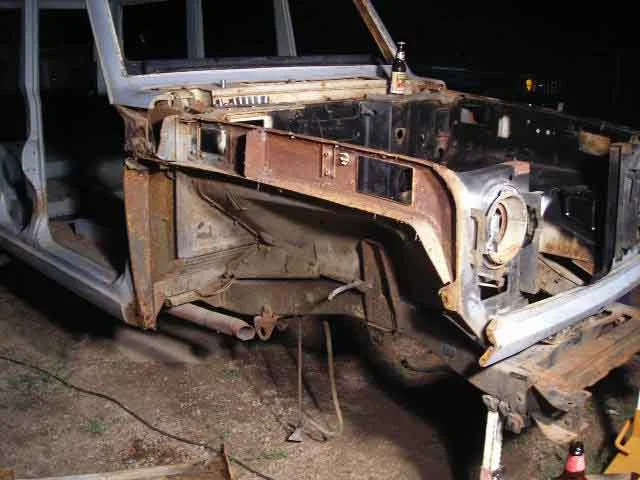

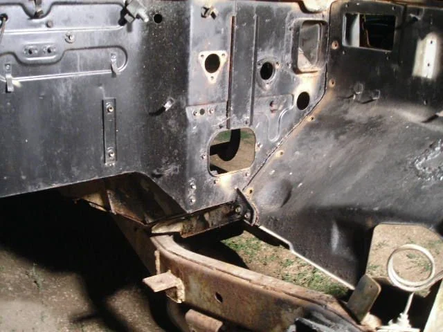

I was in the engine bay mostly then a little bit under the dash... Got the wiper motor out and the heater and some other items...

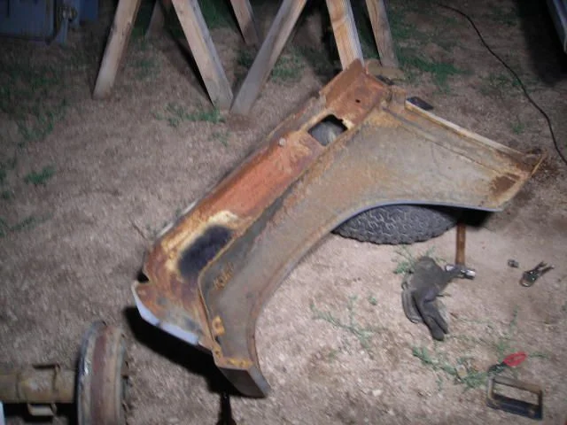

Here is some lovely welded in PO mod, gone now. Also got the blower motor out. I am saving everything but the plan is to use the 'modernized' 80 series blower motor. I am also hoping to use the 80 series AC as well... You can see it is dusk here. Today it is finally a cooler day (raining a little, first time in ages) so hopefully I can get this torn quickly.. Plan is to remove fenders and front clip before attempting to put on 80 series frame..

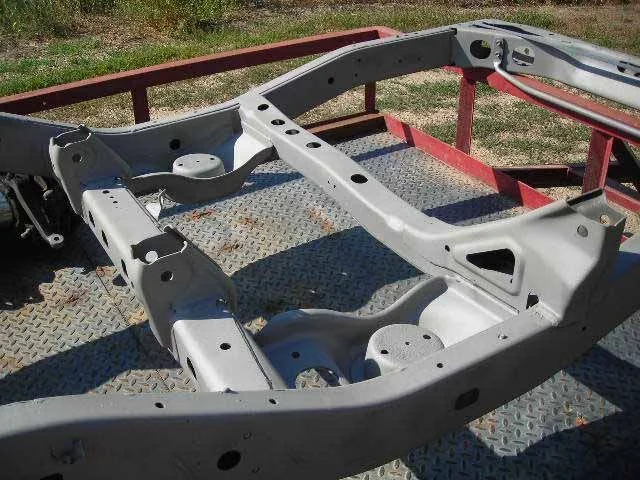

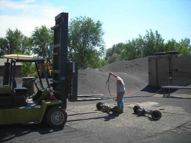

Then, I started talking with the sand blaster and was thinking I would only take the axles down for now, paint them up and the links, then remount them to the frame after I make the 6" cut. Then roll under the truck, weld on body mounts and engine mounts / etc, then take all of that back to the sand blaster (with body) and do it all then. Problem with that is lots of wirewheeling and I would really prefer to be doing all of these frame mods with a clean frame. Problem with this is flash rusting, in air/humidity the frame can start rusting out of thin air when bare metal. So I have two solutions to this. They said they could reblast quickly and lightly, said it would take no time at all, something like $20-$30 (I will probably have them do this) --OR-- I might buy this $30 harbor frieght blaster and redo it myself since it will be quick and fairly easy. But I have a feeling I'll be leaning towards having them reblast when I bring the body down....

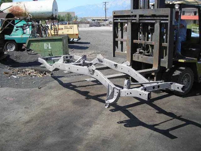

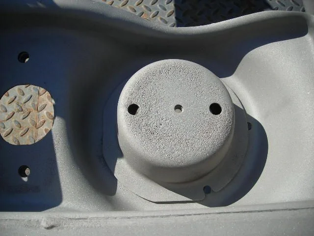

SO -- I decided to go ahead and have them blast the frame and the axles and here they are and this is where I am at. Of course it turned out awesome. That is the color of raw steel, no primer.. Of course I am pretty pyched to have this thing so clean and rust free of course :)
From top pic you can really see where they got some of the rust out. They said total labor time to sand blast the whole frame was about 1 hour. Was two hours in with axles and everything, total was about $183 with tax...

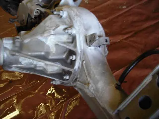

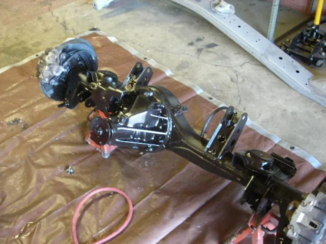

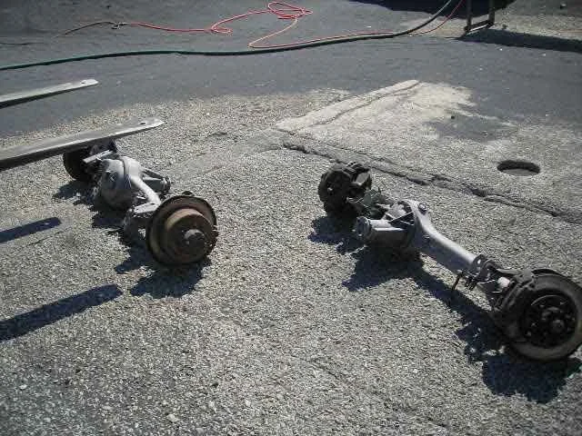

Wish I had more photos of the axles, those turned out really well as well of course. I might take some more later.. Here is what I have. The axles look basically like the frame, same coloration. Guys were very good, they did everything inwards from the brake plates (rear axle) and knuckles (front axle) but avoided the e-locker mechanism...

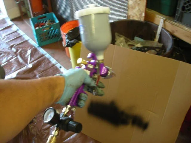

First, picked up a cheapo Harbor Freight HVLP spray gun, gallon of zero rust, and POR marine clean and metal ready...
I wasn't sure about the Harbor Friegh gun cause it seems about 1/3 of the crap I have bought there I regretted but I heard good things about it from Berg and his friend who actually prefers it (uses more poaint of course with more overspray) than a really high end gun for painting cars. I have a cheapo paint sprayer gun that came with my airtools kit a few years ago but it usues something like 13 cfm and this uses about 4. Even then, my 26 gallon compressor could barely keep up...

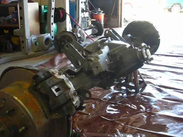

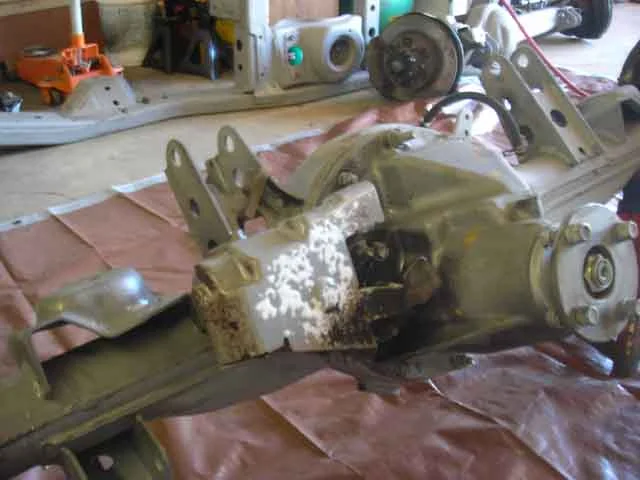

Decided to paint the axles with the Zero Rust to prevent flash rusting espcially because they will have pretty much no modifications to them from how they are now, unlike the frame...
First, sprayed metal ready. Then let sit about 10-15 minutes. In first photo you can see it eating crap off the axles, it turned white and fuzzy... Then ironically you completely wash the axles with water. In both cases I used a spray bottle to douse, both the metal ready and the water...
Then strangely it dries this whiteish color. You can literally smell the metal ready eating any contaminents off the axle, smells like rotten eggs, real sulphury smell :)

Here is photo of the HVLP gun.. My first time with a gun of this type (hooked to air compressor) so did some trial before.. Luckily these are just axles so it was pretty easy. Pysched cause again took only about 20 oz for two whole coats on the axles.. Gallon was $60 out the door but using only 20 ox turned out cheaper than rattle can, even for the expensive zero rust..
