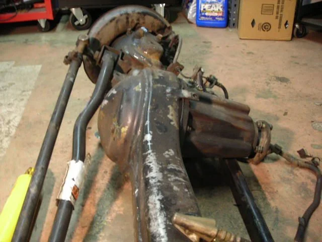

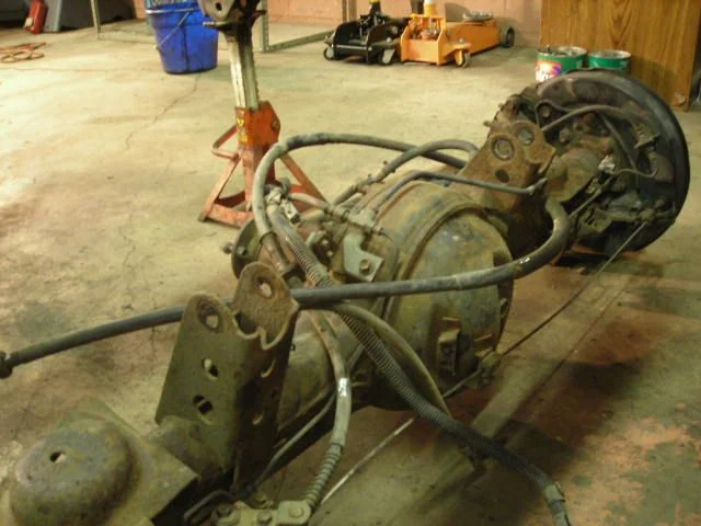

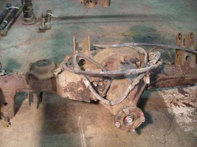

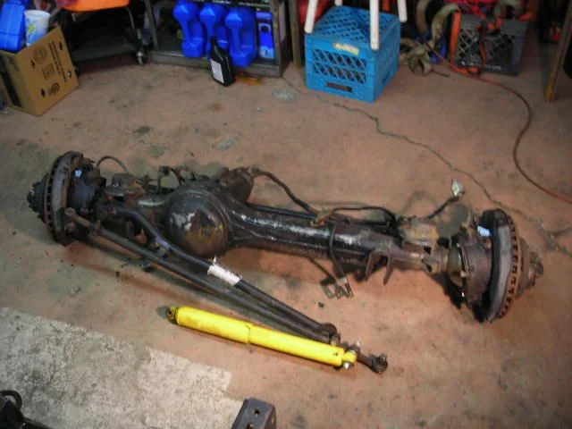

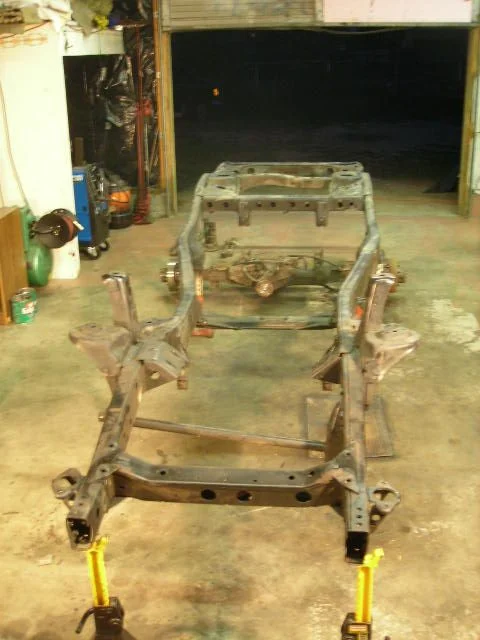

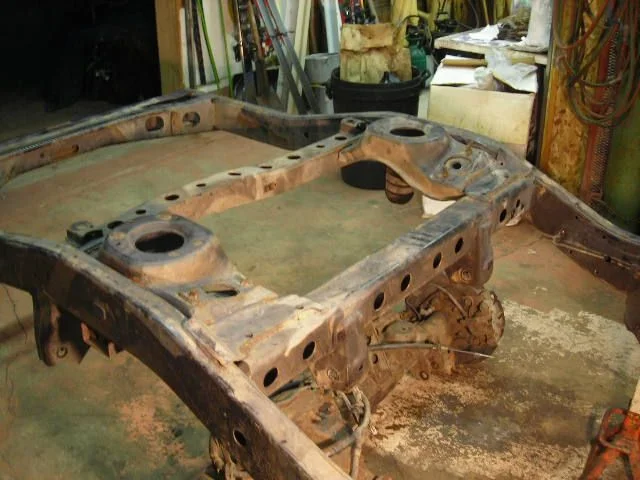

Anyway, here are photos of the frame and axles. For a while I was resisting taking it all apart.. But then with airtools and a breaker bar with highlift handles it took maybe 2-3 hours to complete seperate the axles from the frame. I also feel like I know 80 series much better now, it seems to all make much more sense coming from this leaf-sprung cruiser owner only... So I like that.. Pretty soon the frame will be chopped, I have come closer and closer to actually starting to make the chop to get the ~6" out of there to have the right wheelbase for the 55.... Really the biggest thing holding me back is the lack of jackstands (4 are being used to hold up the pig...). I wish at this point that I hadn't chosen to sell the leafs just yet so it would move around. During the day and especially lately is has been so damn hot that I haven't been able tear down the 55, and at night of course can't see. I think I really only have a couple more hours though until the 55 is completely torn down so I am close..

Front axle (pretty clean right now). I think this will require no prep really other than light cleaning before paint..
And here is the frame.. You will notice the front is much more clean. I get pretty dirty on average doing car work (not sure what it is about it) so I decided to snap a picture of myself with the frame as well all nastied up.. You can best see if the photo I'm in the difference between the front of the frame and rear in terms of rust. Luckily it is all mostly surface rust.. :)
Holy crap man you look about as nuts as me.:flipoff2:
Lookin good man, I dont know about you but i am so sick of dealing with rust my head hurts. I din't catch it(prob cause I am slow) but are you going to lift this pig?
FYI, and I don't know exactly what your plans are, but the steering stabilizer is OME and only about a year old<5k on it. Birfs were done at 120k by National city Toyota in Socal. I put a new pinion seal in about a year and a half ago... Wheel bearings repacked same time as the pinion seal.
I never touched the back axle except for messing with the e brake and changing brake pads.

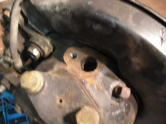

this truck will not have ABS (and I sold all the ABS stuff to a mudder) so that is all gone. Problem is when you remove the sensors, leaves a bog old hole. So I made some plates for it. Not sure if these will be permanent or if I'll make or even buy the correct part... Siliconed in to protect...
