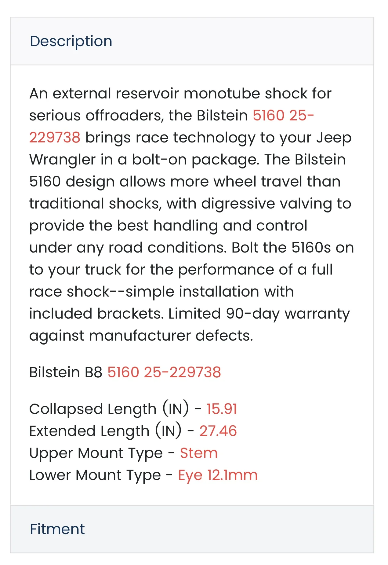

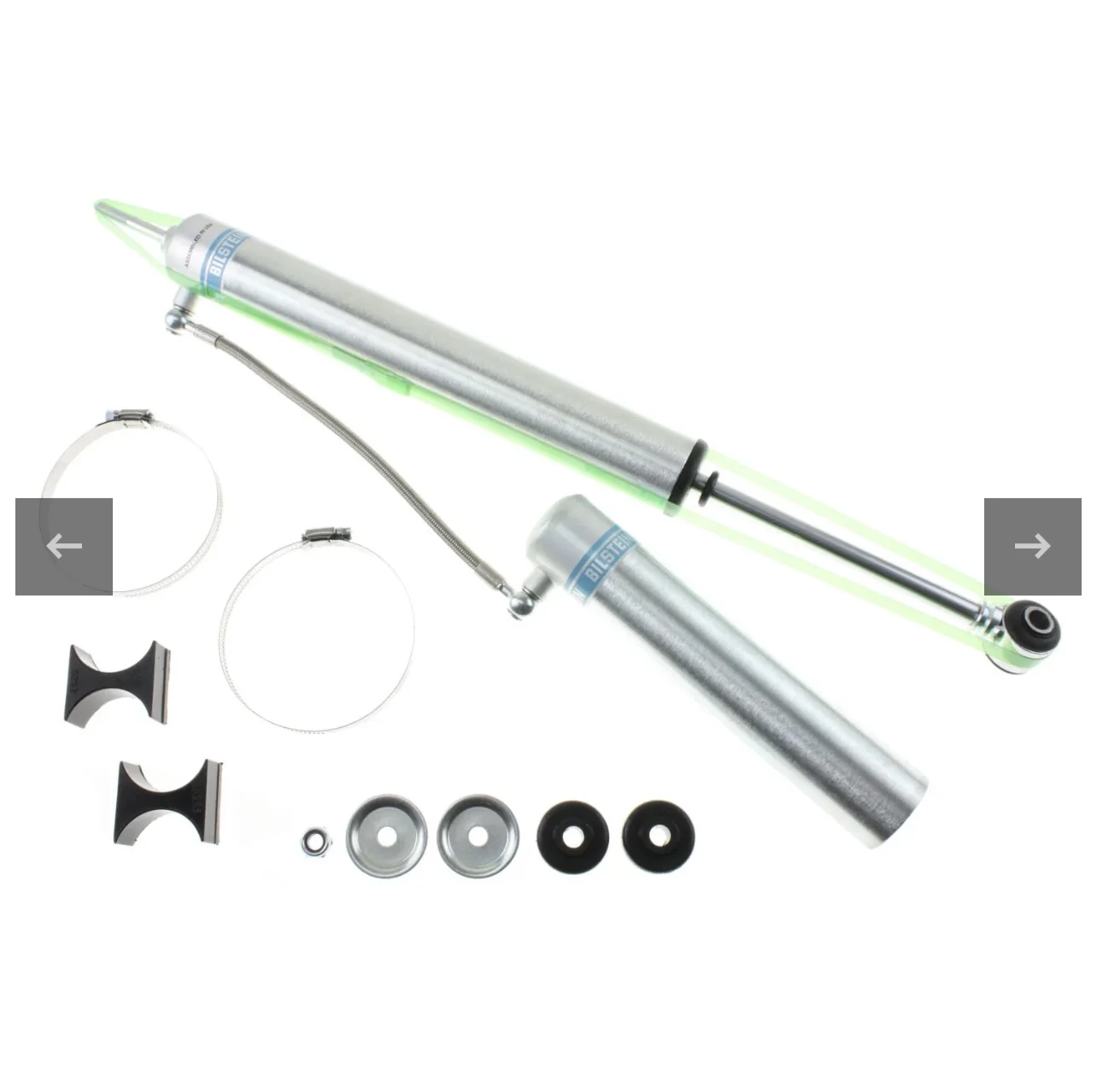

I want to replace the front shocks on my 1994 HZJ73 and I am leaning towards these Bilstein 5160’s. All the specs line up to work well except for the bottom eyelet size.
I am out of town right now and away from my Cruiser so I can’t measure the bottom eyelet size, but internet searches are pointing towards 5/8 inch and the eyelets on these shocks are listed as 12.1mm.
Would the bottom eyelet measurement be of the actual metal hoop or just the bushing size? Would I be able to swap out the bottom bushing to make these fit?

Yeah impressed out the bilstein bushings and put in ones that fit. If I remember I ordered the first size wrong but got it right the second time.
Bushings need to be changed to 19mm / 3/4"
Just sold a full set of 5125's to a guy in Texas for his HZJ77 and we change the bushings out before they leave here so they are ready for install right out of the box.

3/4 bottom eyelet width. Got it.

I’m currently debating the 5160’s (low cost and extra travel), Dobinsons IMS or MRR/MRA (only about 8 inches of travel) and custom Radflo shocks. The Radflos are about $1200 and valved specifically for my setup with 10 inches of travel, but no adjustment knobs.
The only thing pushing me away from the Dobinsons is the shorter amount of travel. I’ve heard so many good things about their ride quality though.
