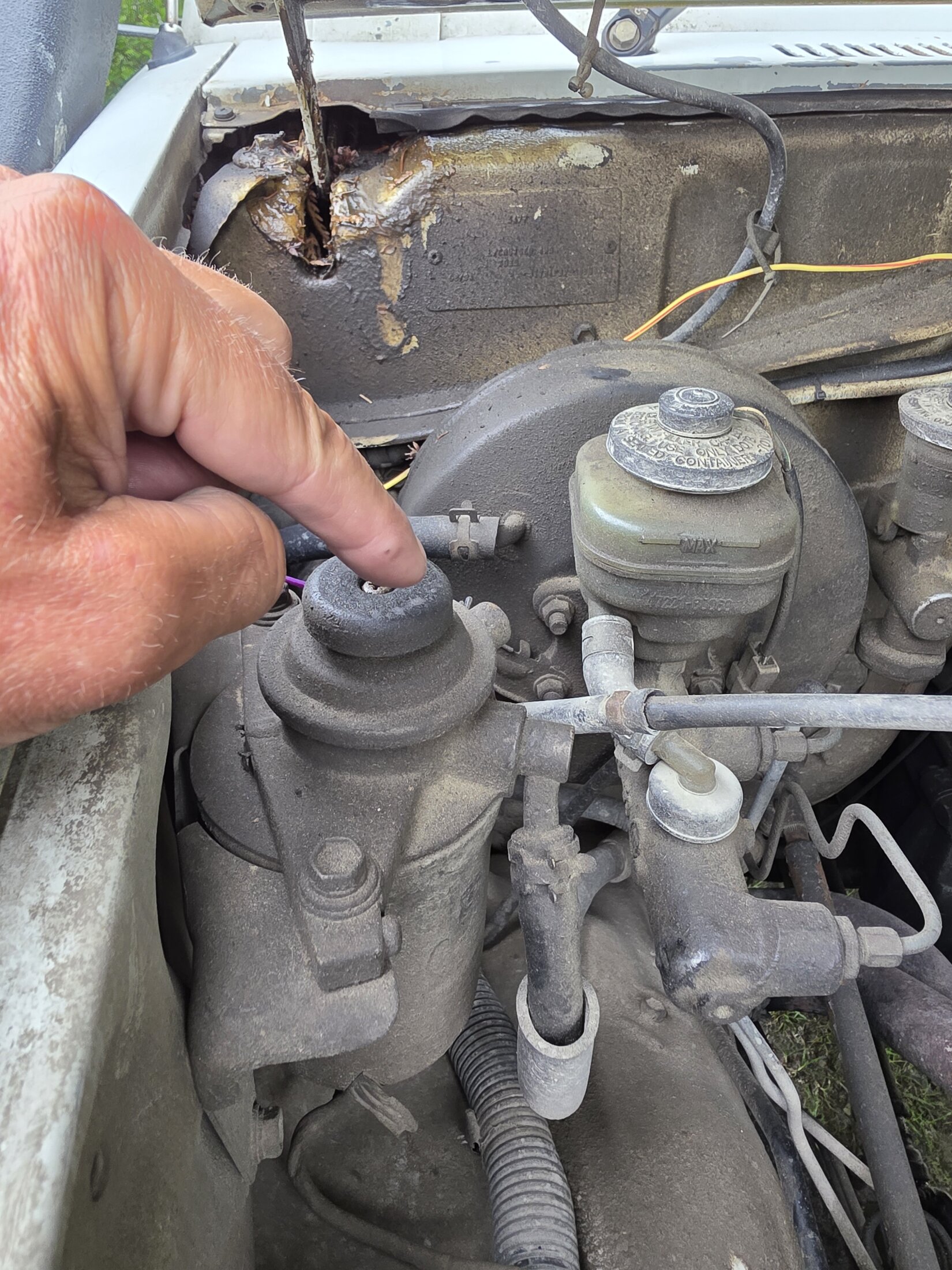

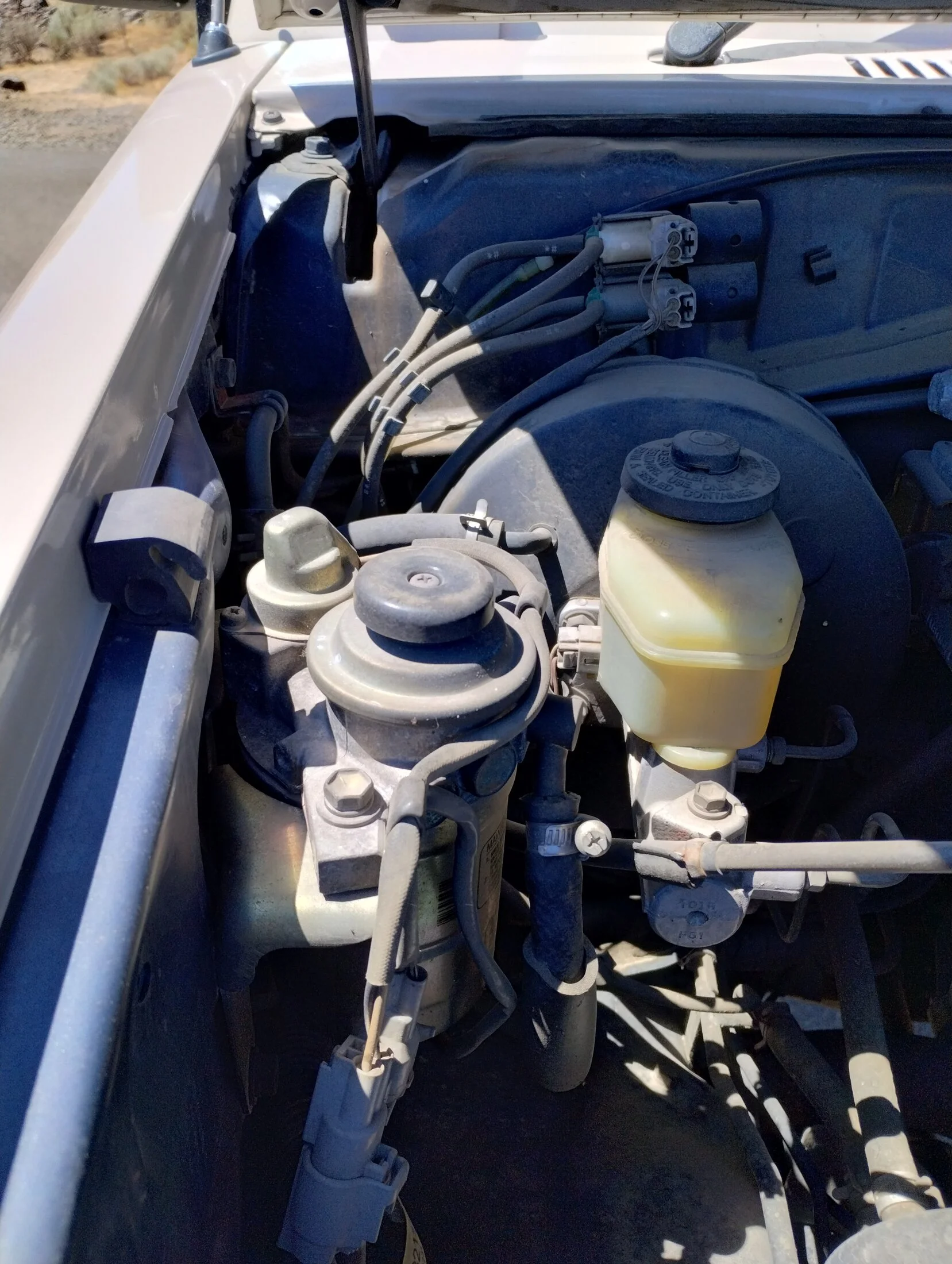

Is there a manual primer pump on the HZJ trucks? If so, I had no idea! You guys drive landcruisers around in the underground mines for transportation?
Yes we do. The longest living and toughest vehicle around.
I've had the pleasure since the early 1980's.
Just looked and mine has one of those too, never knew that it was a primer! 😂 Would that be for priming the fuel lines after changing the filter?
