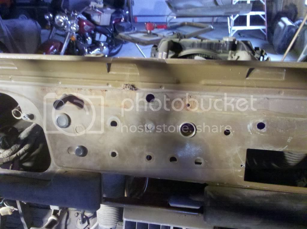

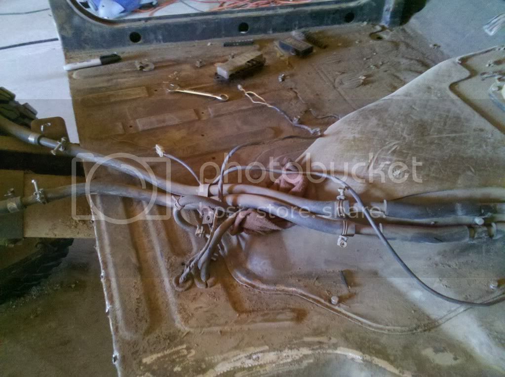

I was able to remove alot of the electrical today. got the main wiring harness and fuse box out. What a pain.
What a fluster cluck:mad:
thanks again for you help guys. Again let me know if you guys see something I need to do!!!

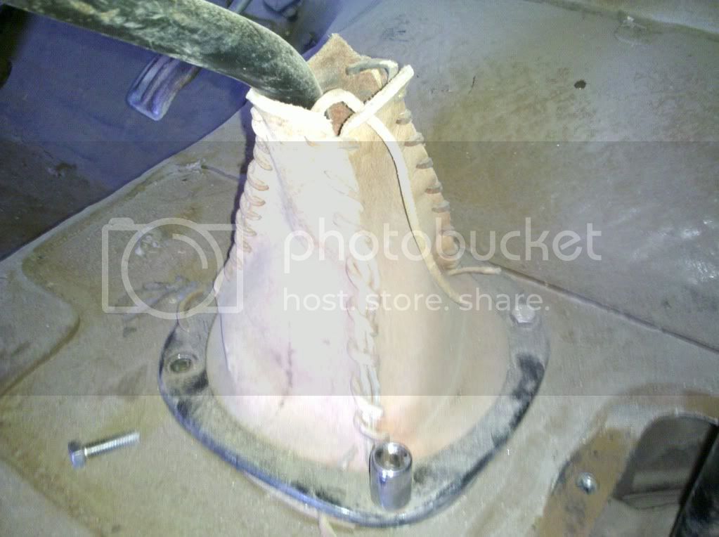

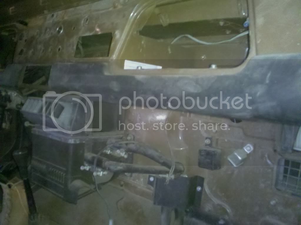

Hello again everybody. I had a pretty busy weekend but was able to get another good chunk done on the resto. first off I was able to find sacagawea's boot. It was on my shifter this entire time. lol. That will be swithced back to original!!

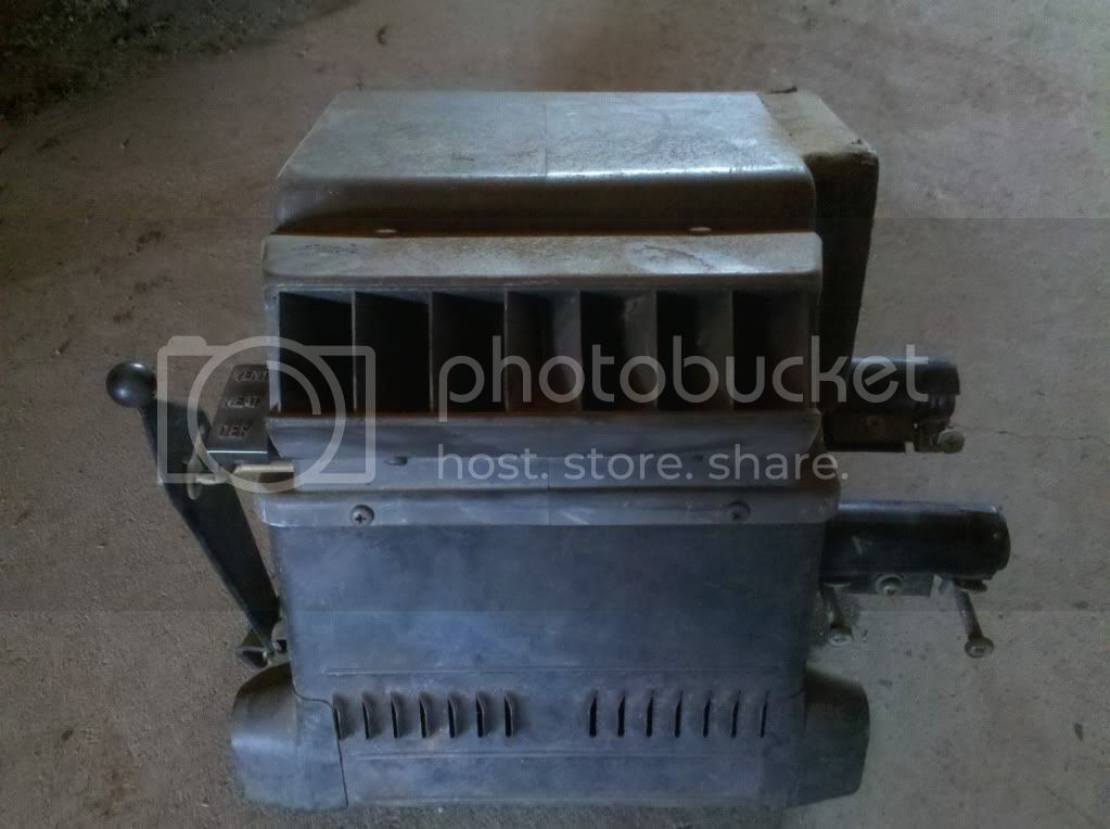

But not only that I was able to finally get the heater motor and lines all pulled as well.

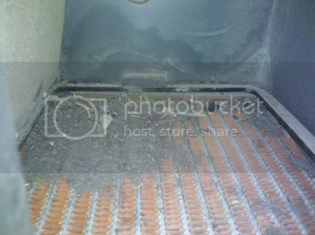

So after I got done doing that I was able to find out why my heater was not getting very hot. Look at all the junk :mad:.
So I will be going through and cleaning this entire system out. I was able to finish pulling the stearing column out to. The next step will be to remove the master cylinder from the fire wall and all the linkige. Not looking forward to that part. I have only removed one before in my life and I remeber it being a beast of a chore. So if you guys have tips on pulling it let me know :).

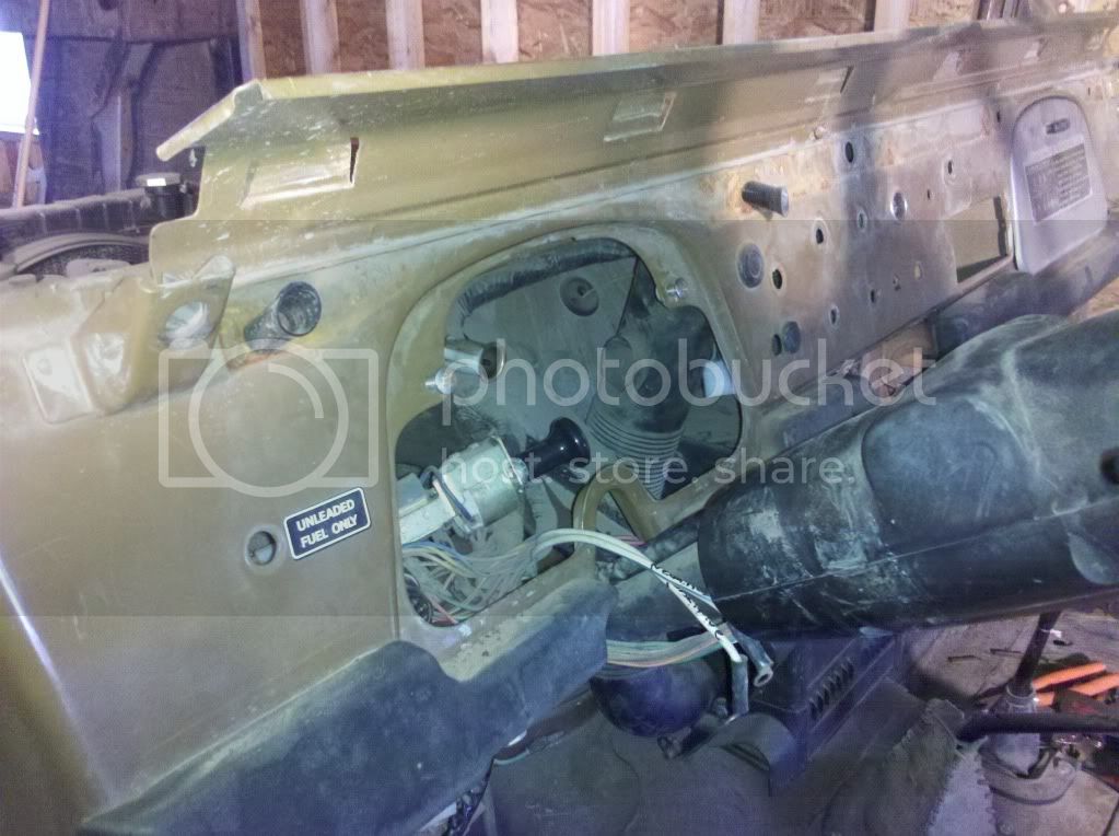

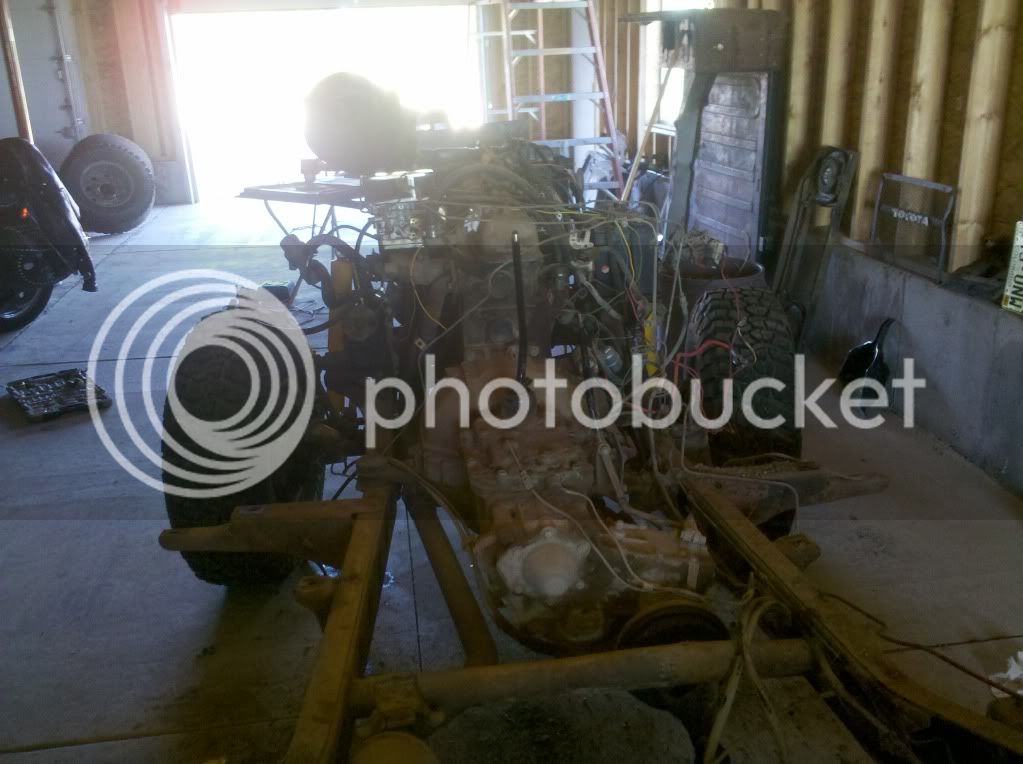

Well this moring I was able to get the body almost all ready to come off the frame. I have pulled everything off the firewall including all electrical and lines as well for brakes/clutch. What a pain. But one step closer!!!!
Thomas
Hey guys another question........What would be the easiest way to clean out the heater? Is it pretty easy to pull apart or should I just run a vacum and some compresed air through it? Thanks again for the help.
Thomas

I do have another question that I will need assistance on. Im getting ready to lift the front portion of the body off. (firewall back to were the tub splits) It looks like a can just lift it off and maneuver it around the gear shifts but it would be much easier not only to remove but install the new body as well. What kind of a pain would it be to remove the transmission shift leaver? Do I need a special tool or do I just push and turn? Or is it going to be a bigger hastle then just maneuvering the body around it? Thanks for the help again and I will post more updates soon.
Thomas
Taking the shifter off should be easy. You might need something to push down with on both sides as you spin (counter clockwise?) and it should pop up. I think I used a pair of channel locks to push down with while turning.
Cool, thanks for the help and tips. Should it take alot of down pressure? or should I feel if slip down a little before I start turning it?
Thomas

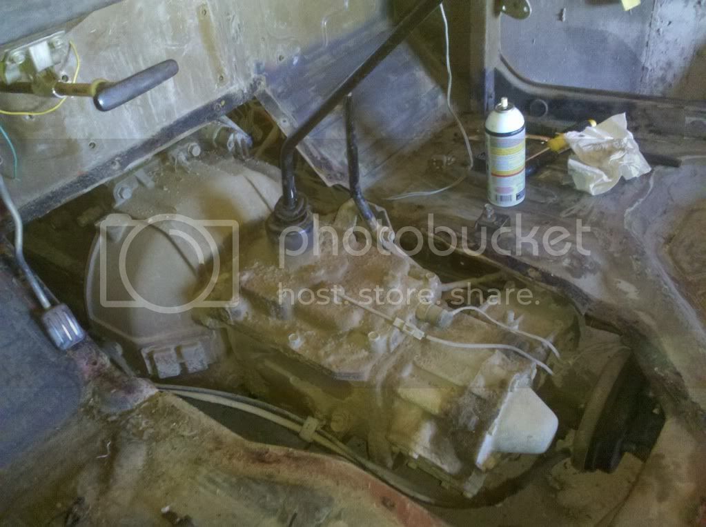

Well everybody I was able to finish pulling the rest of the body off......finally. What a process and a pain.
It was much easier removing the transmission cover and having to lift it up and over the gear shifter then removing the gear shifter all together.

Big T - your shift lever shouldn't take all that much to pop out. I'm not sure exactly which way it's supposed to rotate but if you push down and rotate it should pop out easily. Your brother should know, I'm sure he's done it before.
To clean the heater, go down to the hardware store and buy some muriatic acid. Also known as hydrochloric acid. Be careful with this stuff and don't let it get on anything except the copper. You can flush out the tubes using this. To clean the radiator portion I would just use compressed air/vacuum. Even once your heater core is clean, you will want to check your heat control valve (I'm assuming you have one) to make sure it works properly and your thermostat has the o-ring on top when you reassemble. That way your cooling system should operate properly. Good luck!

To clean the heater, go down to the hardware store and buy some muriatic acid. Also known as hydrochloric acid. Be careful with this stuff and don't let it get on anything except the copper. You can flush out the tubes using this. To clean the radiator portion I would just use compressed air/vacuum. Even once your heater core is clean, you will want to check your heat control valve (I'm assuming you have one) to make sure it works properly and your thermostat has the o-ring on top when you reassemble. That way your cooling system should operate properly. Good luck![/QUOTE]
Thanks for the tip.....I will deafanantly do all of the above. I like the acid trick as well. Thanks again
