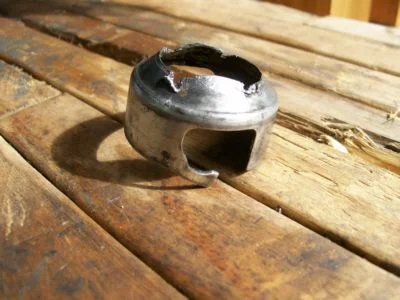

Matt, we tried pushing on the shifter to get it out and it was not depressing, I will search on how to remove.

Shifter help:
https://forum.ih8mud.com/40-55-seri...ion-shifter-installation-sst-tool-needed.html
And a picture of the piece in question:
attachment.php
Yes - if I recall you do NOT push on the shifter itself. You can use both of your thumbs and push down on the collar that you see in TJ's picture there. You push down and clockwise. Once that collar pops up (think small lightbulb, you know how to change those - you push down and turn...) you can then remove the shifter by pulling up.
Sometimes those collars get fouled up with goop, junk, and debris - but you can fiddle with them to get them out. Clearly the guy (hope thats not yours) in the picture above tried using a chain saw to get his out.
This is coming along NICELY - you are doing a great job.
Keep up the good work man,
dallas

LOL deafanantly not mine. Ya that one was hacked on pretty good. Its coming slowly but surely. I just wish you were here to help me. I have an HVAC guy coming to look at my shop to put heat in. pretty pumped for that. Thanks again for the help.

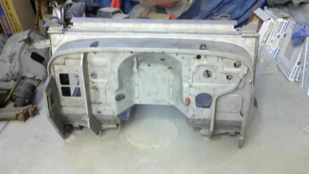

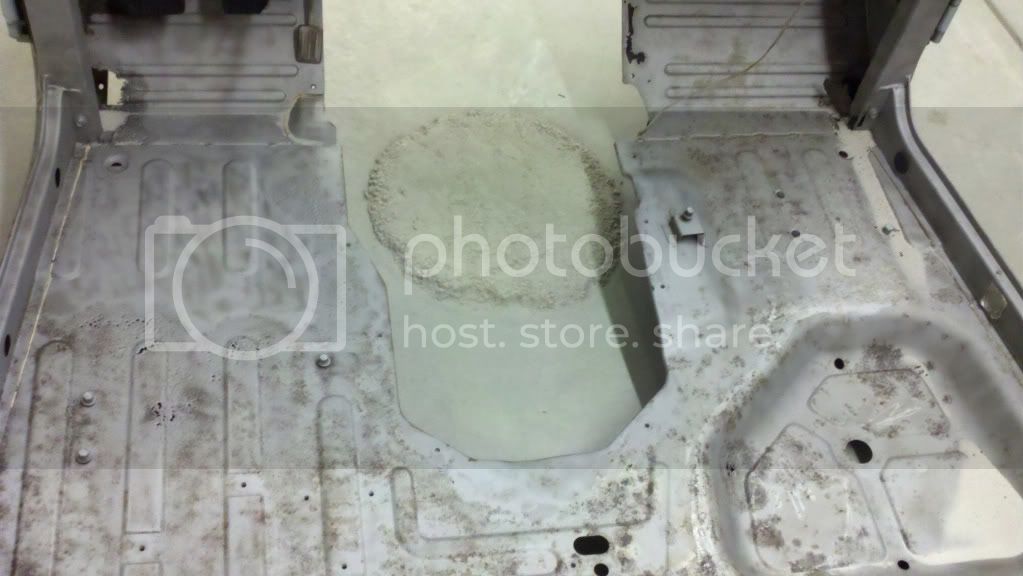

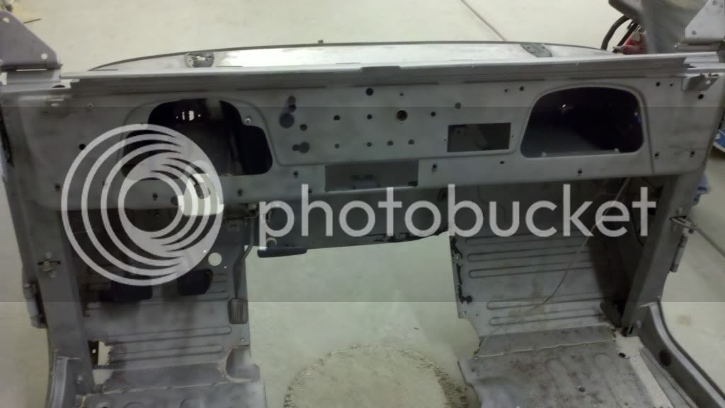

Got some updated pictures of the front end after being blasted. Looks good and is coming along.
Only a few holes got busted through that need patching.

Cool Thomas!
Who did the blasting?
I had dad's buddy Kieth blast for me at dad's place. Turned out really nice other then the rust holes. But Clarence should be able to patch most of them up.
Thomas
