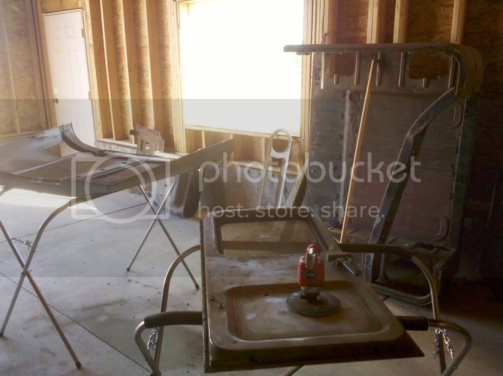

I started by disassembling the back half of the tub and then taking the fenders to the body shop. The hood is near perfect, and I'll post pictures of each item as I finish body work on them.

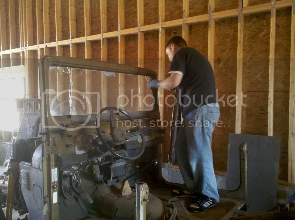

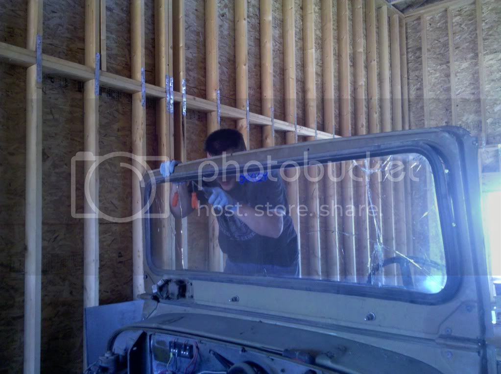

Here is my brother Dallas (dmaddox on the forums) removing the windshield glass:

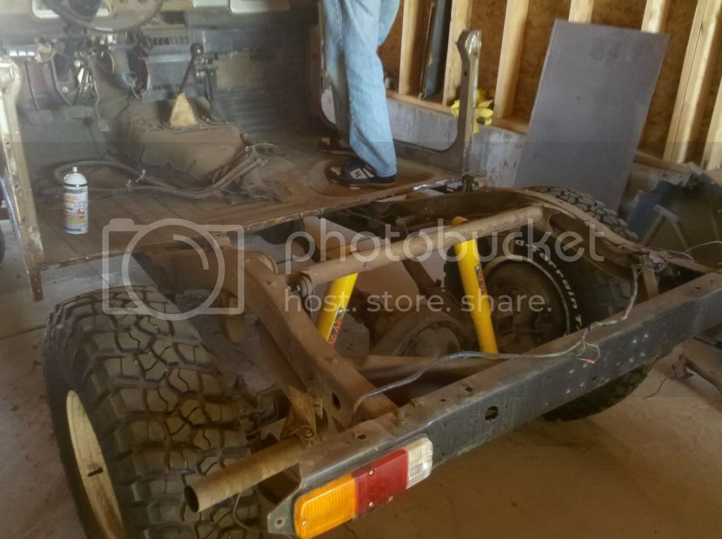

Tub removed:

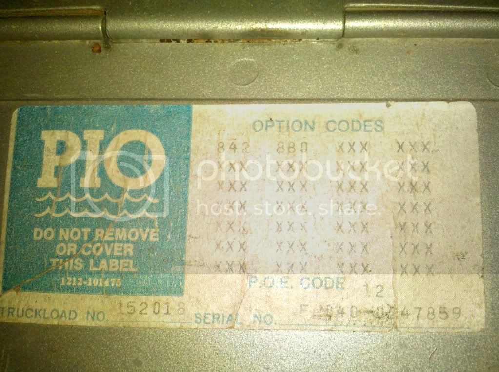

In the meantime I have a question for you guys. No one seems to know if this is a stock "build sheet" or "birth certificate" but it has very detailed information on my cruiser and appears to be very stock-like. Thoughts?

That sticker is not stock. It looks like an old shipping label. Like the truck was shipped by boat. Notice the POE (Port of Entry) code.
Good luck on the build.
:cheers:
The "PIO" sticker shows port installed options. Not sure what the 842 and 880 option codes mean, but it would be options installed at the shipping port where your cruiser was shipped, before it was sent to the dealer. I have seen these on a few cruisers, and if stock means it was there when the vehicle was first sold at the dealer, then this sticker is most likely stock.
I have a sticker like that on my 76. Inside the glove box door. Looks stock to me...
Maybe a sticker they placed on imports to smog states like cali, to make sure they had the right gear on board...?
Good start btw... And what are your plans for the rear tub? Pilgrim? Aqualu?
The sticker looks very stock to me, and why would a ferry or port care about options? I vote stock, as others have seen them too.

Im with you D. I think its stock as well. and BTW are you supposed to be paying attention to your class? lol

What is really strange on this cruiser is that all of the body panels were straight and virtually rust free except for the rear half of the tub!?
My recent acquisition (Marvin thread in my .sig) is similar. There's a lot of rust around the rear sill and lower rear quarters, and the bed floor is a mess, but the front floor is like new.
