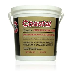

That grease above looks fancy. I use Coastal grease. It comes in white tubs.
True.
HA! Maybe fancy, but the price and operating range is good with me, $2.49 a tube and I like that it has lower/higher operating temps than most others. -10F to 385F range, the lower end means a lot to me here where we see -10 to -20F nights/mornings regularly in the winters. I just feel it makes a difference.
I think the Coastal has a 325F upper end, do you know what the lower end is by chance Johnny.

No clue what the upper end is, lol. I can check when I get home later.
