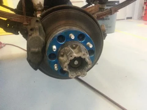

ok need help. I'm in the middle of doing the rotors and bushings and managed to get grease all over me somehow. When I removed the locking hub the gasket on the WARN hub tore. WHere's the best/faster place to order a new one from, I dont want this rig sitting for too long?

those look the same as the aisin hub gaskets so your (local) toyota dealer of choice should have them.

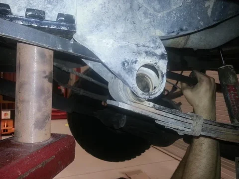

On a different note, the shackle holders (not sure of the proper term, It's the part that connects the shackle to the frame) are off. one is off by 2.2* and the other by 2.5*. It's noticeably crooked, Looks like i might get the welding guys at the community college to fix it. but that will be a few weeks down the line.
trying to avoid the dealership, they wanted $30 for my power steering cap, plus everytime I try to order from them it takes them a few days to get my parts in. I have plenty to work on while I wait for the stuff to ship.
That gasket is a Toyota gasket. Don't use rtv or gasket maker, has to be paper.

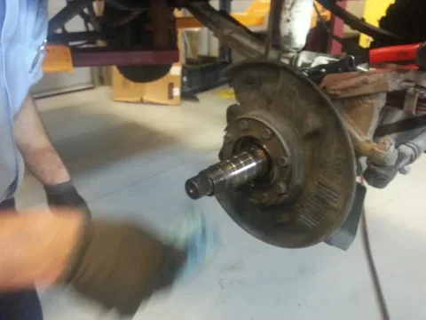

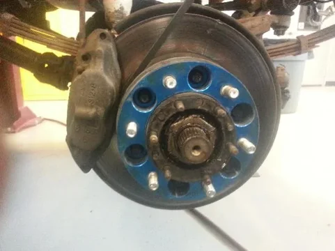

I didn't get as much done as I hope. I wasn't expecting the brake job to be a pain in the ass. I also had to order a gasket for the hubs. You guys make it look so easy in your write ups and your pictures. I spent an hour fighting with the last freaking bushing. All the other bushings cooperated, but this last one would not go in. I had to get some help.
anyway here's what's happened so far. This is where I am with the brakes. I took the rotors, calipers and hub off. When The gasket gets in I'll repack the bearings and reassemble

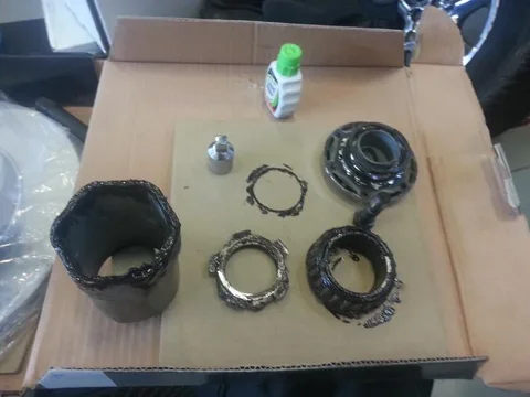

This wasn't soo bad once I was able to find the bent lock nut ( i think that's what it's called)
Cleaned them up, going to reuse the seal since it's nearly brand new.

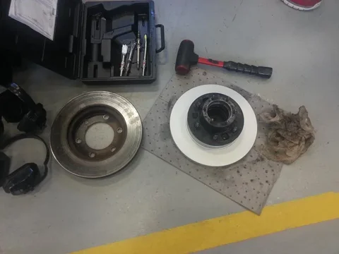

Here's the new and old rotor. There better be some improvement in braking for all the hassle this was.

I need to work on my handbrake. It only brakes on one tire right now. Will try to get the shackle mount rewelded better, but that might be two weeks away since I haven't yet tackled the shims to correct the caster.

I think I'm going to go ahead and replace the bearings for peace of mind. Where is the best place to get koyo bearings and races for the 62 other than the dealership?

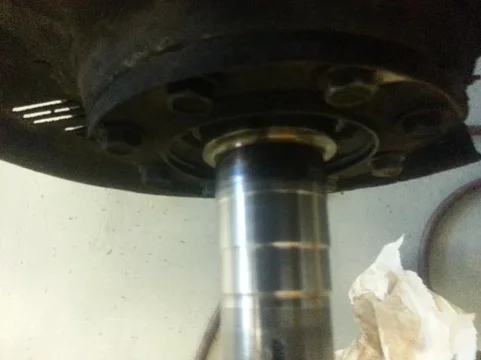

Also this side, the grease wasn't as red ad the other side, is that from humidity or water greeting in?
Plus the axles had slight burn marks on them. There's no pitting though. What causes that?

Maybe the grease is different from one side to the other? Or maybe it could have something to do with the burn looking marks on the spindle? getting too hot in there or something... of course, I'm probably wrong :D
No, you're spot on. Burn marks are either from the bearing preload being too loose, or being too tight. Either case would cause the bearings to overheat and discolor the spindle. If this happened (looks like it did), the grease would burn and change colors (darken).
So Patrick, you hit the nail on the head :D
good call Patrick. So the solution is new bearings?
In a perfect world, it would be a new spindle and new bearings. However, replacing the bearings and races would suffice.
thanks Johnny and Patrick. The spindle doesn't have any pitting or grooves, just discoloration. I guess right now I'm just waiting on parts to show up.
