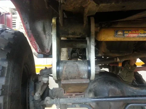

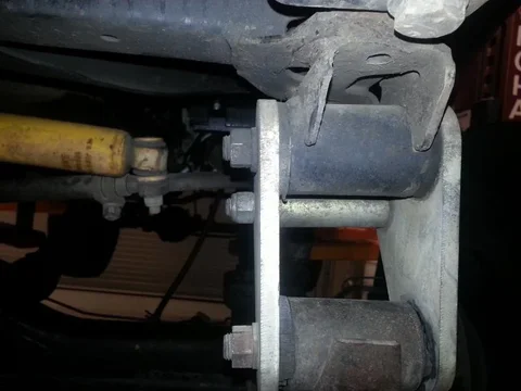

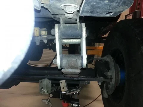

Nothing sexy to report. I already mentioned I'm getting most of my brake parts for free. I started on the bushings yesterday and did the front axle leafs. I had some trouble with the springs, it's definitely not a one man job. In some spots I could have used a bottle jack, but I left mine at home so we used a crow bar. The old bushings were stuck in there pretty good, so had to air saw them out and drill them. the left spot where the shackle eye is crooked, we hit with an air hammer. I have to get that re-welded properly.
the old right bushing
Drilling it out
The new right bushing. I'll take better pictures of the left side that's crooked and show you where it needs to be re-welded later.

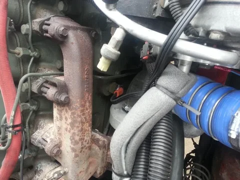

In a separate note. I got my block heater cable today. Came just in time, the weather is in its 20s today (that's cold as hell for Texas). The cable was about 11 bucks and seems to work well.
The cable fits nice and snug, might have to move it around a bit to get it to line up. I can already feel the different. the IR thermometer shows the blow at 16 degrees which the heater is in its 70s within a few minutes of hooking it up. I'll write more pros and cons about this cable when I spent enough time using it.
here's the old left bushings. You can see how it's cockeyed.
It's hard to tell, but there's a small broken welded bead. Need to get that fixed.
for now we straightened it out with an air hammer.
