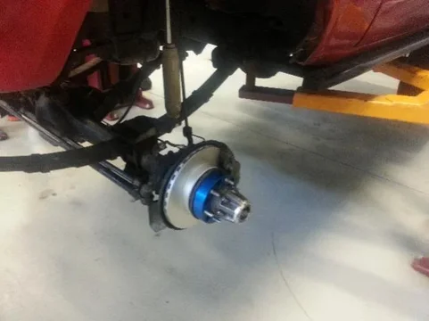

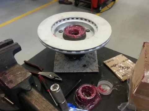

So quick update, I got my bearings in yesterday and was going to install everything and be done with it today. Well after I repacked the hub and bearings, and used new gaskets and put the new rotor in and everything, a friend decided to "help out". He ended up stripping the caliper bolt hole, so now that needs rethreading. Which means i have to take apart the hub again to do it right. The guy who lent me his 54 mm ( i think) socket had left and took it back with him, so tonight was done for. I was too pissed anyway so I walked away and will finish when I get more time, probably late friday. I am without a doubt the slowest working guy on this forum.
Here's some not so sexy pix.
Repacked bearings and hub
Put back together with new gaskets.

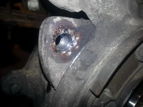

New caliper that ended up having a stripped bolt, and stripped thread hole

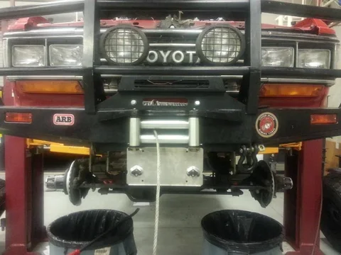

Upgrading the fairlead
Final product on the fairlead.

Bummer man. You can use a helicoil kit to repair the threads, or you can drill them out and tap for 1/2" fine thread bolt. Happened to me once as well. Good luck!
"help out", :lol:
Someone told me a helicoil eventually comes out, not sure if that's true or not. Either way it forces me to learn more about this rig. I'm looking very seriously into that rear axle swap. Will PM you when i get home tonight. Thanks for all your good advice.
I second using a helicoil kit. I have used them for my KTM 250 dirt bike when I would strip out the aluminum case threads. Never had one fail and those little 2-strokes vibrate ALOT! Hope you get it all fixed up!

Ok finally got my truck road worthy. Had to take the hub apart again to use the time sert.
It took a few tries as you can see, but it's done.

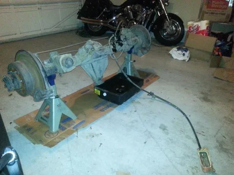

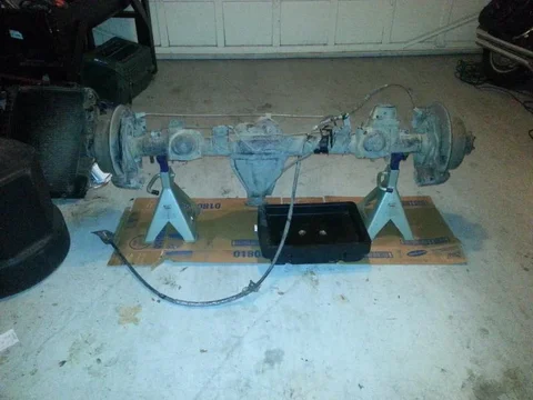

Wanted to say thanks to Jason from www.cruiseryard.com who personally delivered my own 80 axle tonight. I'm not gonna lie, that thing was heavy, not sure how he and his wife were able to get it in their truck.
After a week and a half of fighting with brakes and bearings I'm ready for some real upgrades.
Here it is

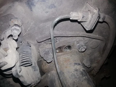

This is my only potential issue. That's where the abs sensor goes, and I'm not sure what's the best way to plug it. I'm open to suggestions.
