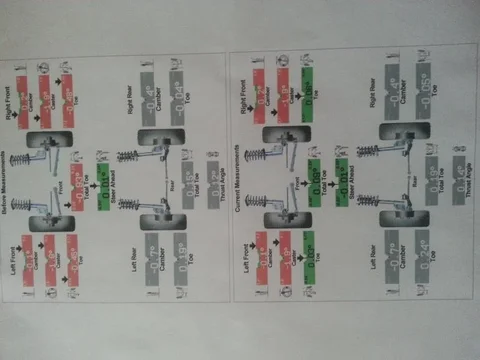

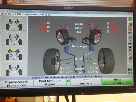

In other news I did a preliminary alignment this morning. Preliminary because I'll have to redo it once I add some shims and new bushings. My tie rod ends are good (there's 0 play) but the boots are not holding grease anymore.
Ok so this is how it goes, You input the make and model into the computer and it will give you the stock specifications.
then you hook up the reflectors onto the tires. Make sure you input the correct tire pressure. At this stage the computer will flash red because nothing on the rig is stock anymore
As you can see, my rig's toes stick outwards. The caster is also negative which means I have to add shims under the leaf springs to get it to zero or positive
Next adjust the steering linkage/tie rod ends to bring the toe to 0
here is a before and after print out. Notice the rear is slightly misaligned as well, but there's nothing we can do about it since it's a solid axle. This is probably due to differences in the leaf spring sag, either way it's negligible.
Once I install the bushings an shims I'll have to redo this process again. But I can definite feel a major difference in the way the rig rides right now.
