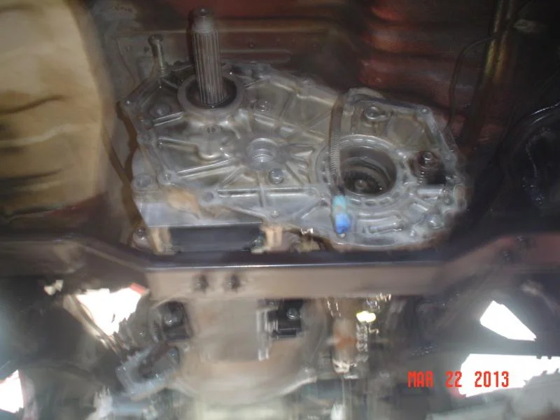

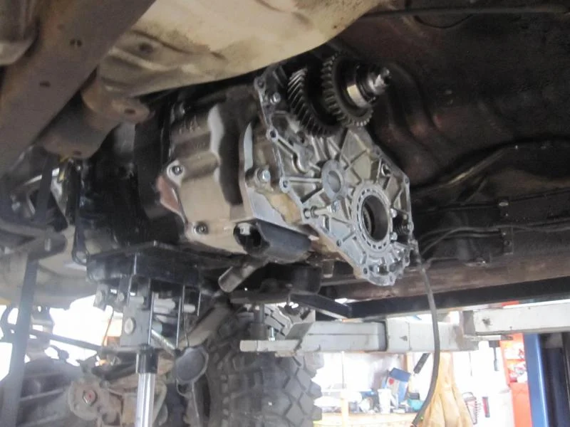

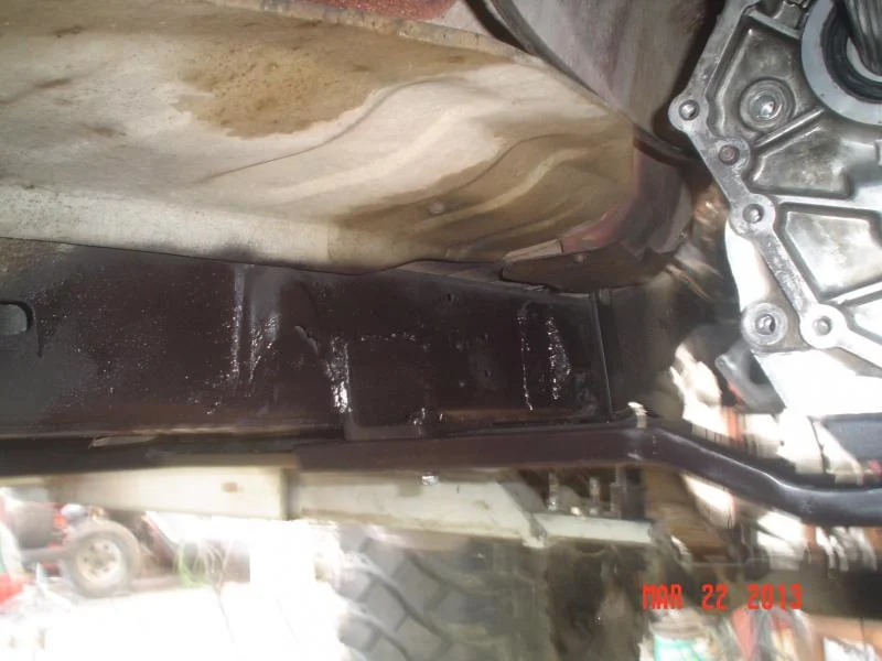

now the cross member,
He's going to weld some brackets for the crossmember and leave enough room so that when I get more funds, I'll have a skid plate protecting all the goods.
Another fast update.

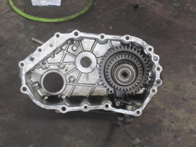

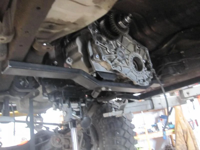

Mounted the transfer case, The TC vacuum was hitting the frame, so Edwin had to straighten up the engine for it to fit. He also ordered a few things for the TC and made a crossmember strong enough to handle the oncoming apocalypse.
Here are some pics.
waiting on parts, hopefully tomorrow
you cant really tell with this picture, but the vacuum pump clears the frame though it's still very close.

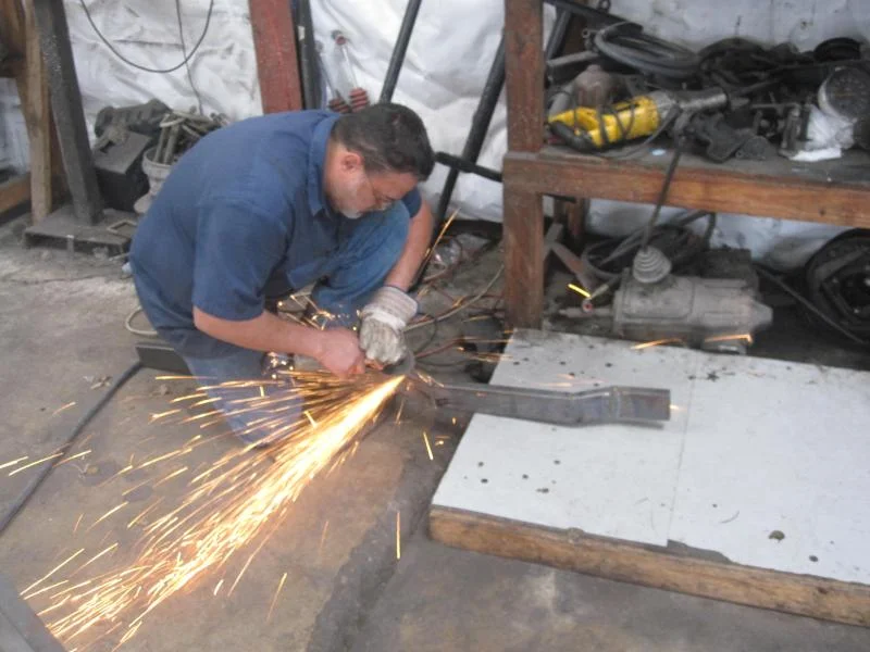

Here's today's update.

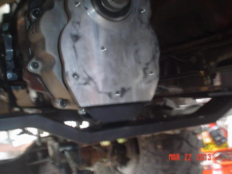

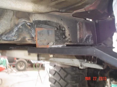

Use 7/16" angle iron to use as brackets with grade 8 bolts. Here it is mocked up, not yet welded.

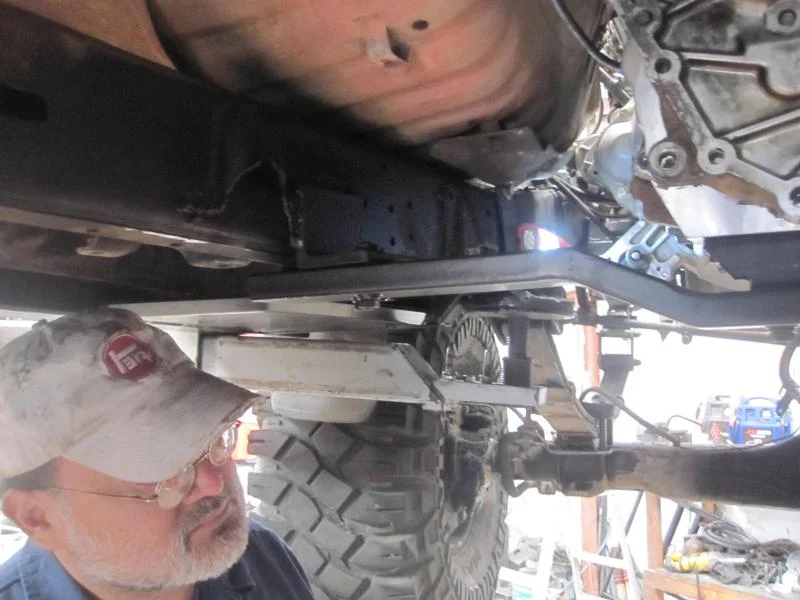

I got to take this moment to thank Edwin and his crew. Since I've come back from Iraq, they made this rig their priority and have been great about letting me hang around all day. I'm usually in the way and I'm asking dumb questions, but they are great about answering me and letting me just be in the way. Anyway here are the pics.
Sweet :grinpimp: That's the kind of angle my motor mounts are made of!

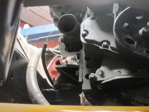

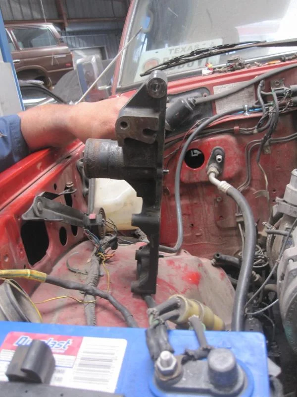

Anyway the AC/alternator bracket arrived and it looks like it will hit the PS motor mount. We decided to get back to it later after we look at how others fixed it. The rig can run without AC for now. I want it ready for April 12.

Alternator/ac bracket
where it would be hitting the motor mount

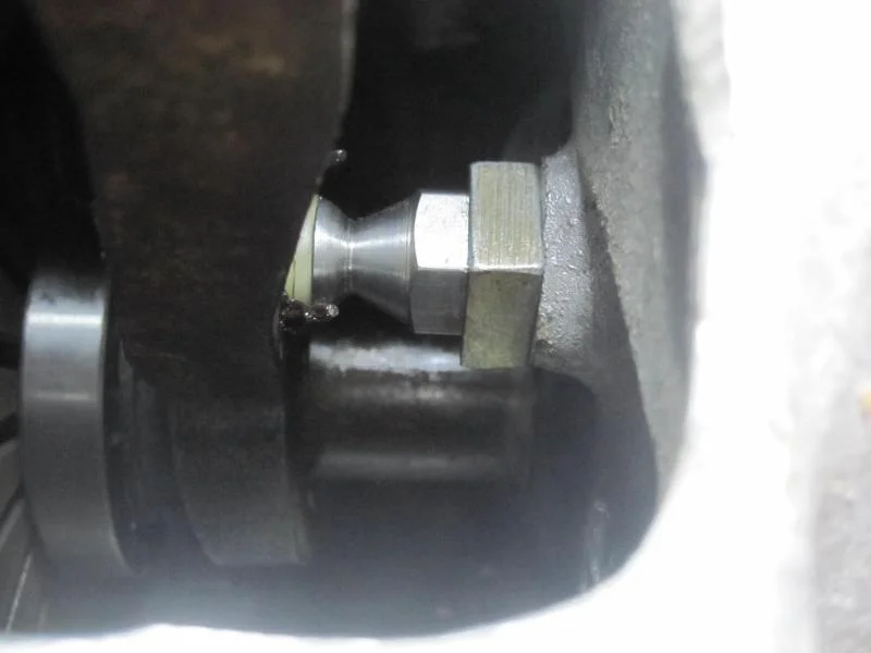

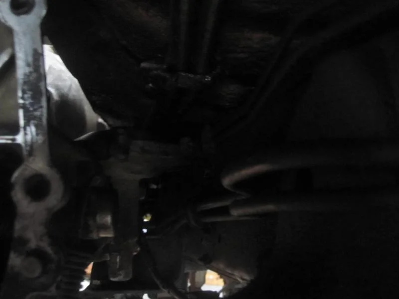

This one is of the clutch fork and pivot ball that gave us such a hard time a few weeks back. Ended up using the Toyota clutch fork and it seems to work perfectly. Fingers crossed.

This is Edwin and the cross-member he fabbed. It looks good and it's sturdy.
Dude, my bad. I completely forgot that you were using the front mount brackets. I'm using mid-mount brackets, so my bracket fits there perfectly.
I'm not sure if any of the PS mount AC brackets that don't use the front motor mount bolt holes. There are guys that mount AC brackets to the DS top head bolts, then run a v-belt accessory drive. Tons of possibilities for a custom mount setup though.

No worries. I was originally thinking of having the AC on the DS like you mentioned, but then the fuel shut off solenoid would be in the way. There's ways around it, it's not a show stopper. I just want this thing on the road soon.
Mine is up top on the passenger side, but you'd need to make the bracket. It also uses a Sanden compressor that is a little slimmer than stock. Edwin can get the hoses redone easily at a hose shop he knows about in town.

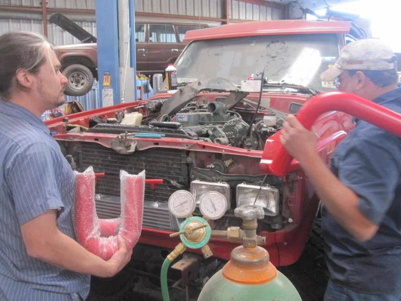

As far as work for the day, Edwin did the fuel lines, the shifter and took measurements for the inter-cooler. Afterwards I went to the local club meet and joined them. Met some great guys and looking forward to outdoor events with everyone. And now the pics
Shawn and Edwin deciding which is the best way to do this
Edwin drilling a 3 in hole in the body
Now it goes faster because it's that much lighter.

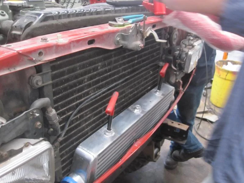

BTW, the intercooler instal looks pretty good!

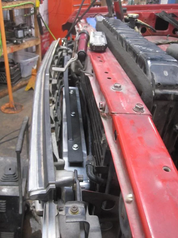

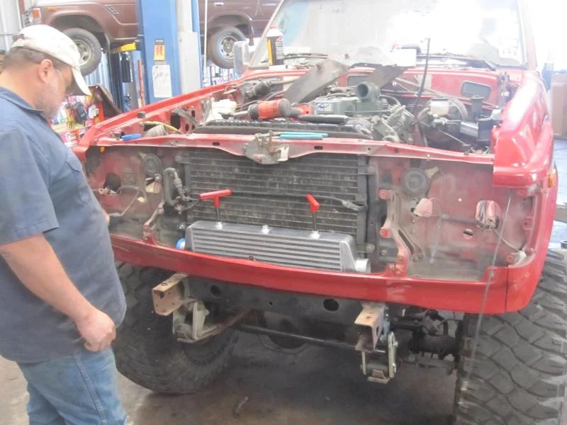

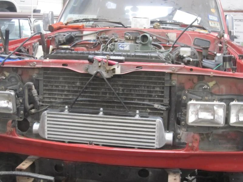

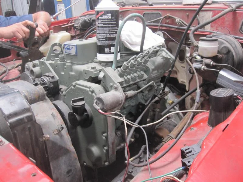

Got the t case and drive shafts installed, all in the stock locations, no lengthening or shortening needed. The fuel lines work and the inter cooler has a bracket to hold it in place. We finally got the engine running, fires right up, not as much vibration or noise as I expected. Anyway here are some pictures of the inter-cooler
At first I didn't see it
I like how it looks and fits
side view with the brackets. It has angle iron holding it from the bottom as well,
Here are the videos of the engine firing up for the first time in the bay. Technically right now Big Red can move under his own power, but we haven't added any oil in the transmission. The only worry I have right now and I'm praying to God that it's nothing is the transmission not shifting into 5th gear. It goes smoothly into all other gears but resists the 5th. I know this is a common problem and has a solution. I'm hoping once we add gear oil and get it moving it will sort itself out.
