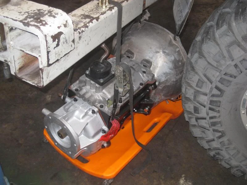

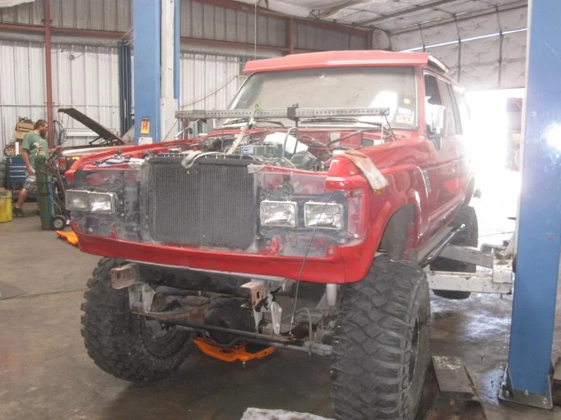

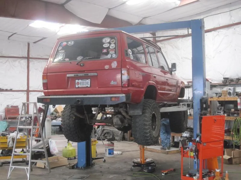

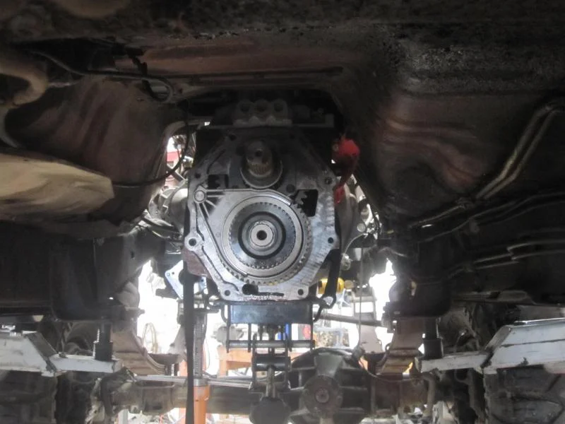

ok time for some updates. I went to Edwin's shop today to see the transmission installation. Edwin had to make a few minor mods to the output shaft for it to fit the adapter.
truck
tranny
before install

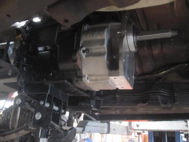

mating the transmission
line it up and bolting it in

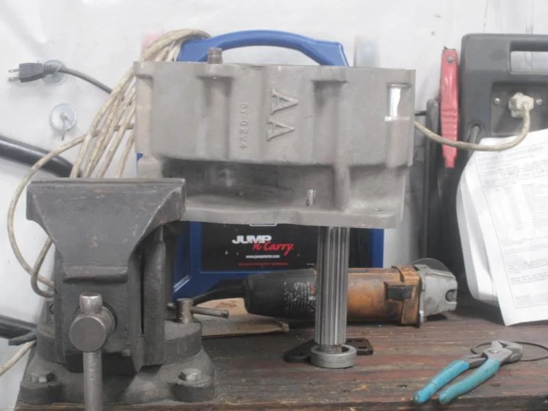

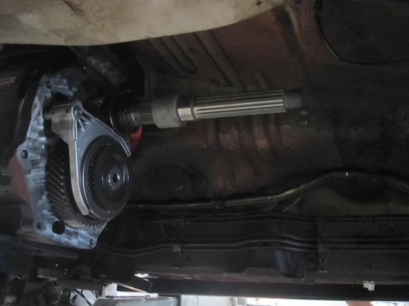

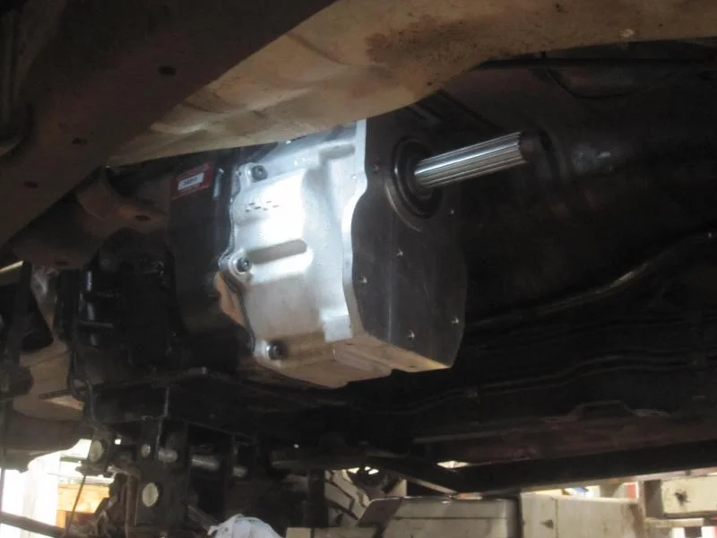

took out the back end to replace with the adapter piece from AA so that it will fit the Toyota transfer case
mock up of how the spud shaft will sit in the adapter.
Adapter and shaft

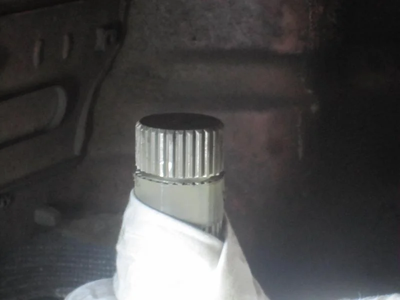

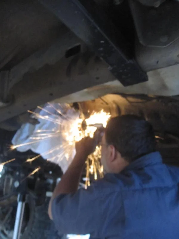

Here you can see that it sticks out about half an inch. So Edwin had to cut out that much from the transmission output shaft
so he measured it, marked it and cut it.

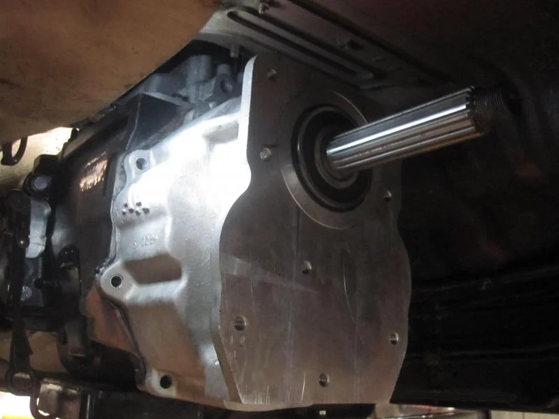

here it is up close
here it is after the cut and before the adapter piece installation
And now poser pics of Big Red
another one

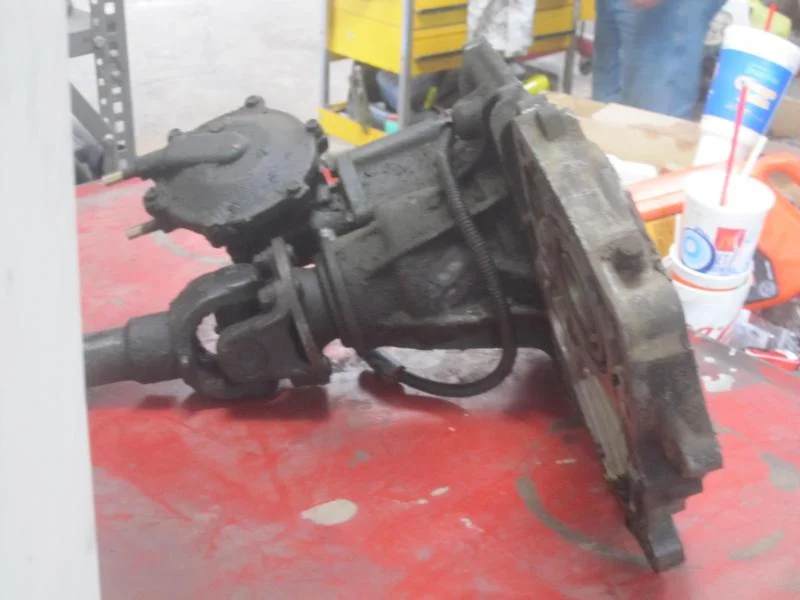

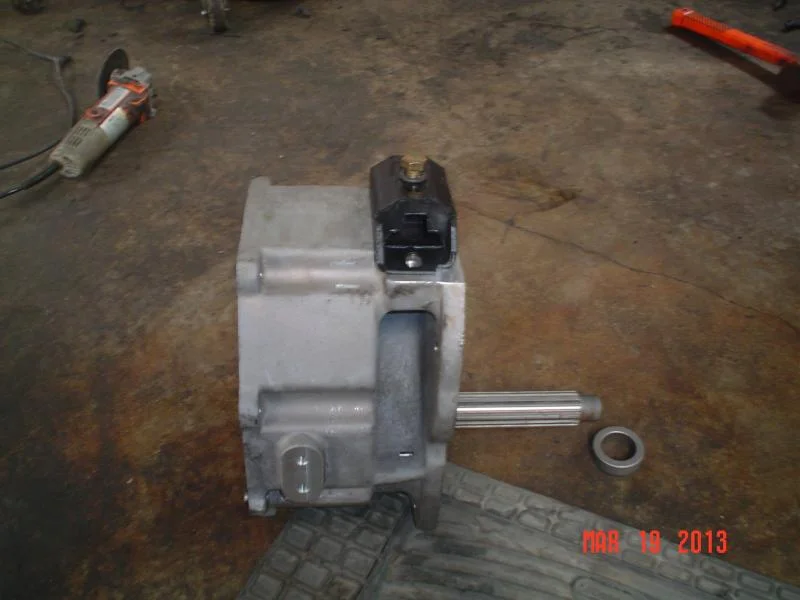

transfer case. This is hopefully be installed either tomorrow or in the next few days. Edwin will be making a beefy mount for the tranny.

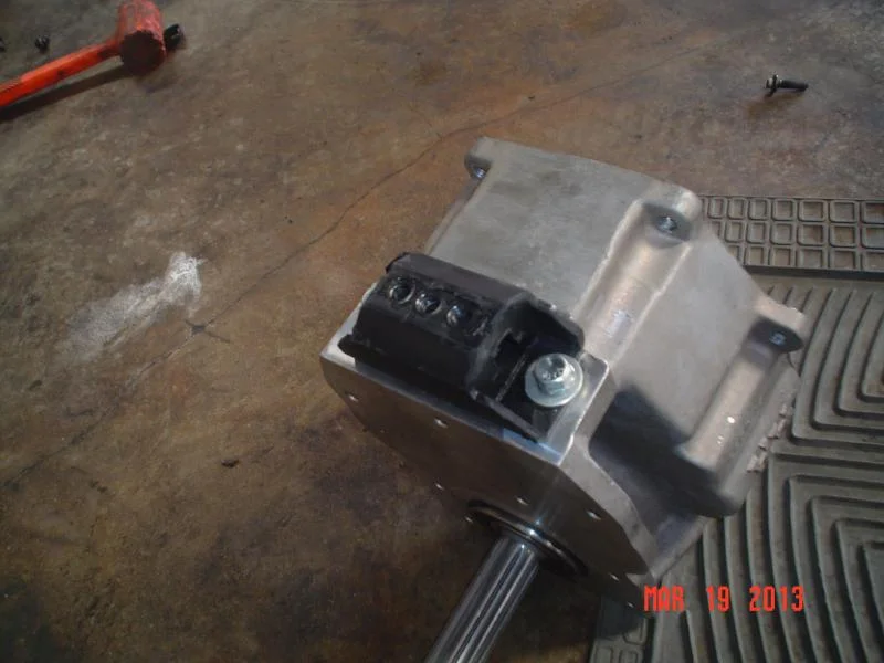

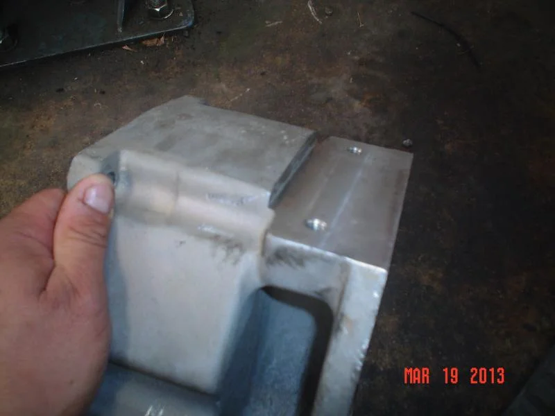

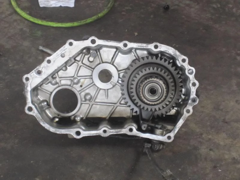

Ok small update. took the adapter piece back off to get the correct mount fitted. Will be attaching the transfer case on soon. Edwin is looking into making the transfer case manual instead of a vacuum activated. if it's gonna be time consuming and costly I'll just leave it the way it is. Here are some pics.

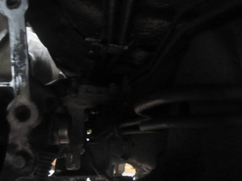

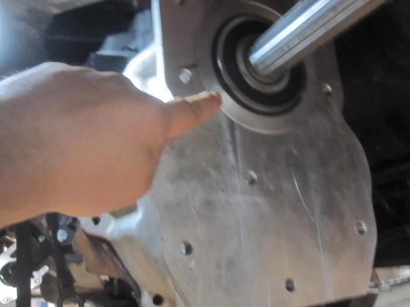

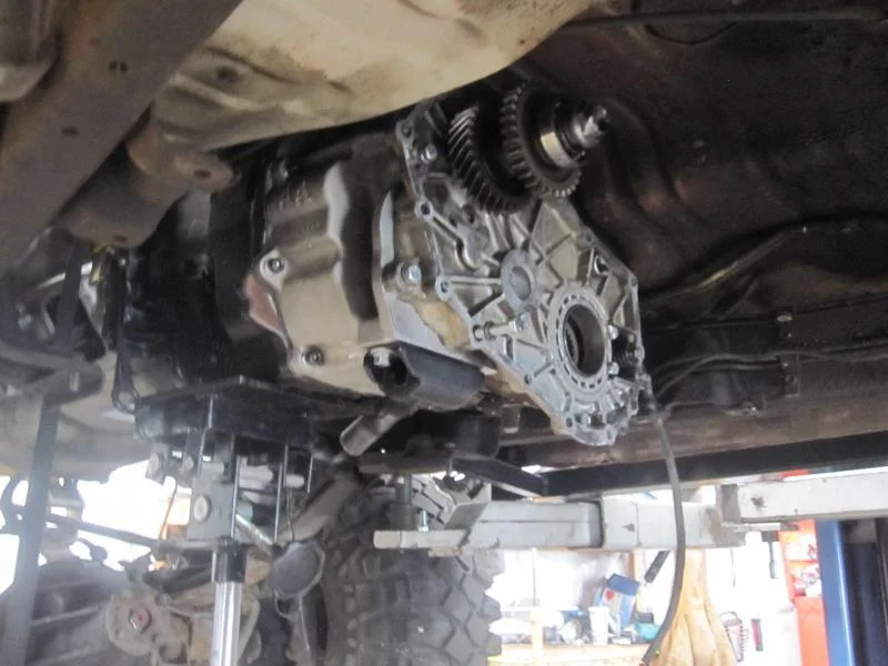

Another fast update.

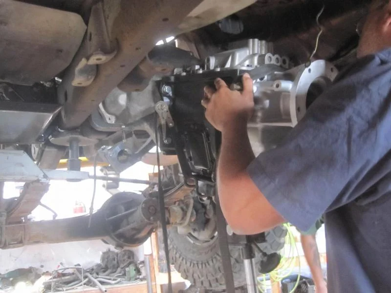

Mounted the transfer case, The TC vacuum was hitting the frame, so Edwin had to straighten up the engine for it to fit. He also ordered a few things for the TC and made a crossmember strong enough to handle the oncoming apocalypse.
Here are some pics.
waiting on parts, hopefully tomorrow
you cant really tell with this picture, but the vacuum pump clears the frame though it's still very close.
