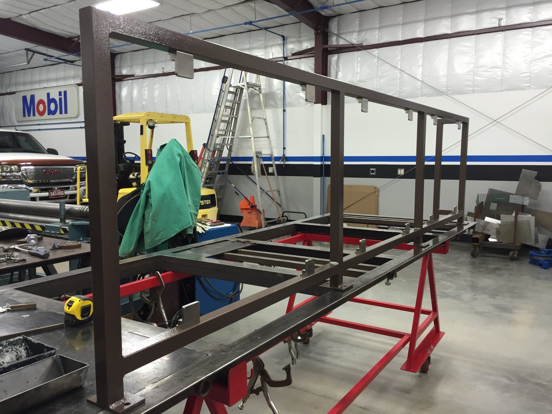

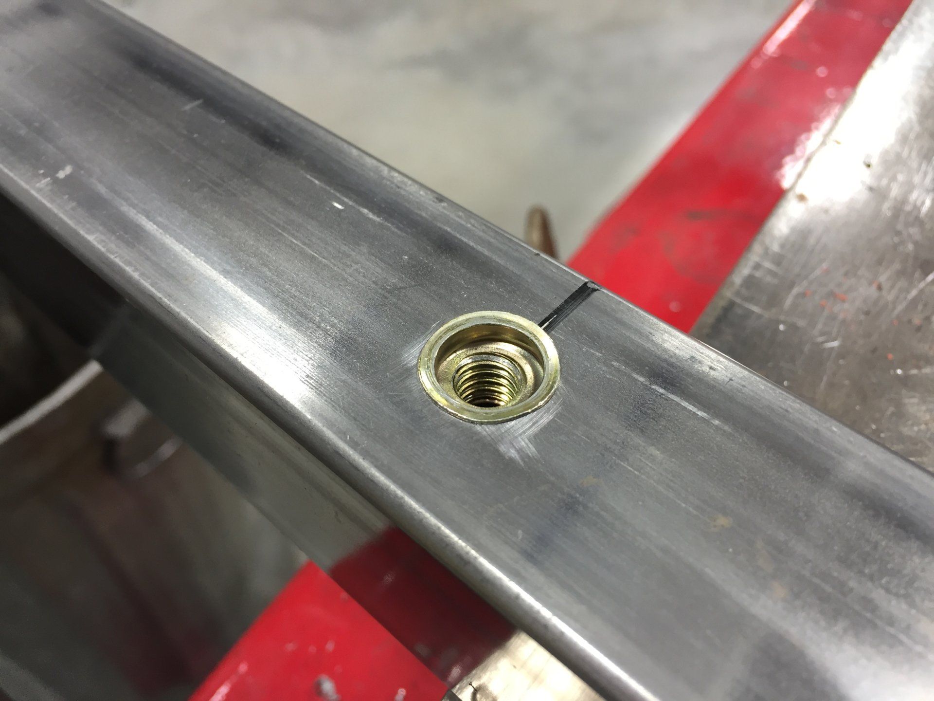

Used it to secure glass clamps on a rail I built some time back.
Pretty flush when installed.
Clamps installed.
Installed with glass panels.

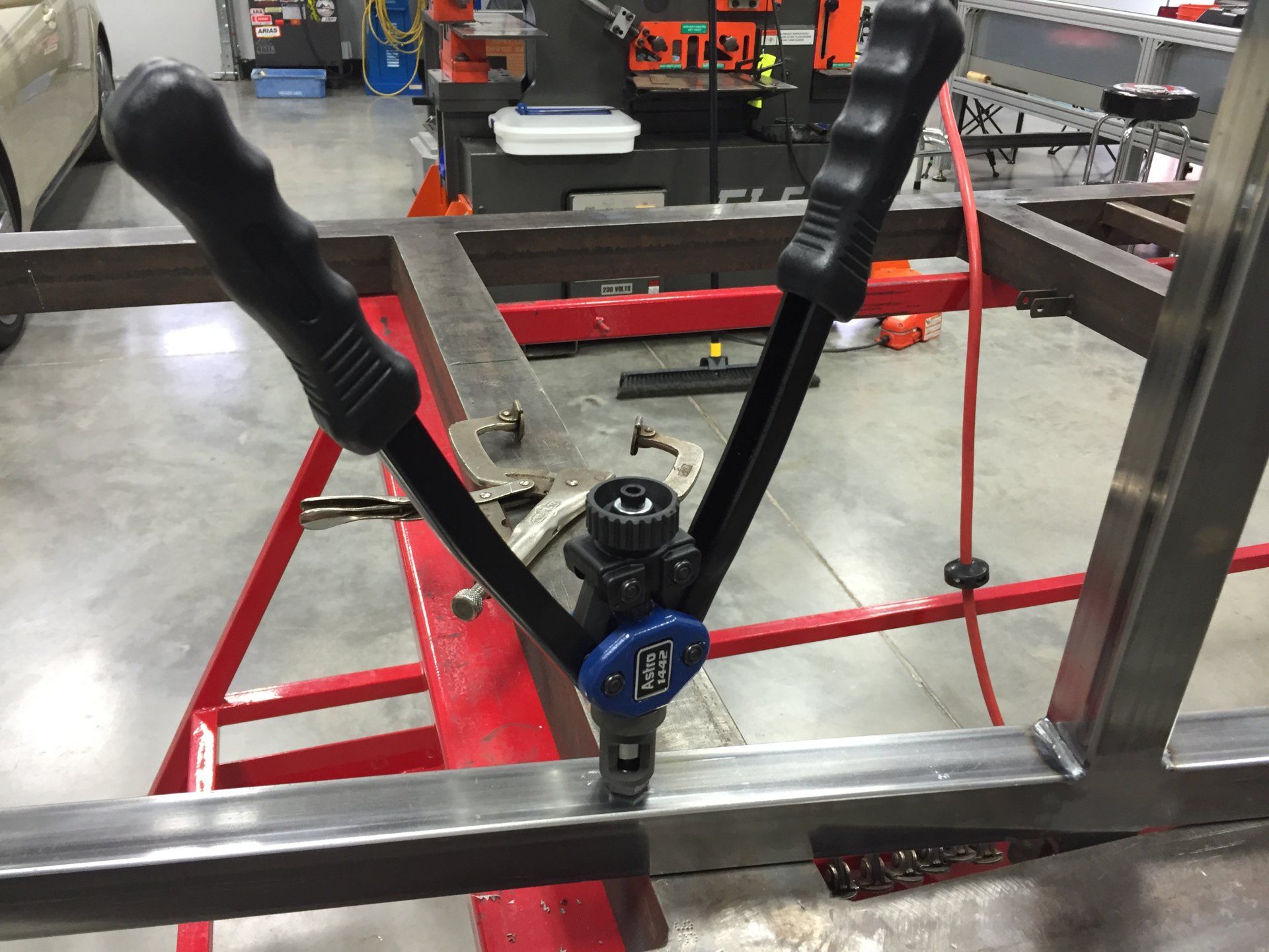

Not a tool used too often but certainly handy.

As to "second best after a welder" ... ? Not really IMO. Useful, yes. Maybe better for some very specific situations. (Although you can install the nutserts without a dedicated tool as well.) But the question in my mind is always how strong are the installed nutserts. Good enough for holding something in place to look at? Probably. Good enough to hold something securely that you don't want to fly off and maybe kill somebody? I would not take the chance. Judgement call, of course. But I would not sell those as a replacement for structural fastening.

Second place to a welder because you can bolt and unbolt, and I would NEVER use a nutsert for anything that had enough weight to fly off and kill anything.
I have used nutserts extensively at an old job of mine, but we used a pneumatic gun with a threaded tip to spin them into the metal and set the insert. Is this just a manual version or does it work differerentaly from the pneumatic gun I have used before. Marson Spin/Spin Rivet-Nut Tool 3,000 RPM SST-1

I use RivNuts, which I think fall along the same line as the OP's nutserts. Mine were used to install the aux fuel tank in the back of the 80, so figure on 15 gallons of petrol + fuel tank = 166 lbs / 4 = 44 lbs per RivNut. This was done back in 2003 and everything is still hunky dory with many miles of rough driving.
If installed properly, they work well!
