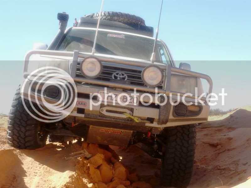

Photobucket back up, so, some pics.
100 IFS 35's Fox shox, slinky coils, diff regear, brake upgrade etc etc

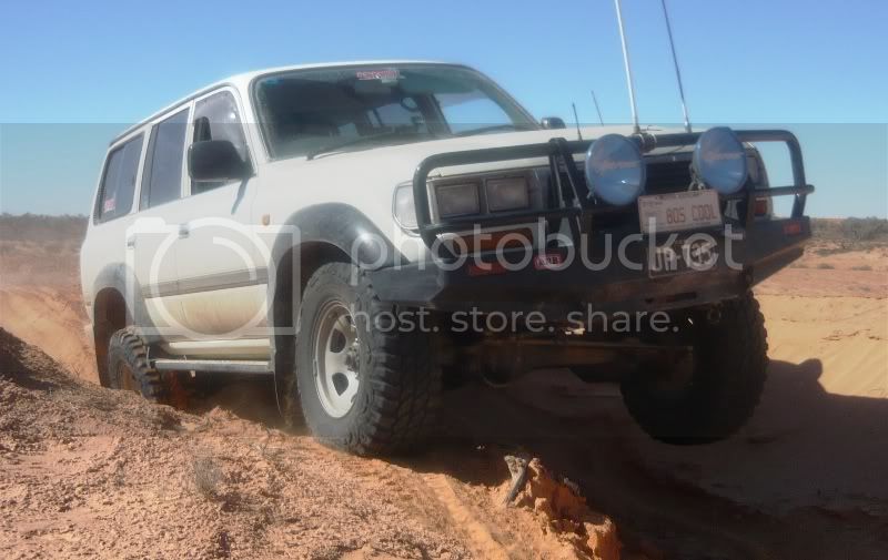

80 2" OME lift on 285's same place
ride height at around 8800 lb
front travel
I'd luv to see the "long travel front 100 suspension". There might be a SMALL improvement though I don't see it happening without chewing up parts unless there is a huge redesign! Plus, comparing the 100 Long Travel to an 80 front travel is just BLANK.
