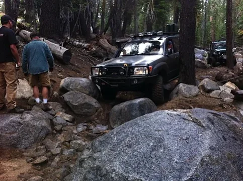

Wanted to drop in and say hello. Picked up an 80 about a month ago. New to the 80 world, but not to the toyota/ ih8mud world. I just sold my 100 (she will be missed!), and my father has a 40. Lots of mods planned and coming soon!
1997 lx450
142K miles
Stock.
Hope to meet some 80 guys around my area.... :beer: See ya on the trail!
Pic of the 80, my 100, and the 40.
