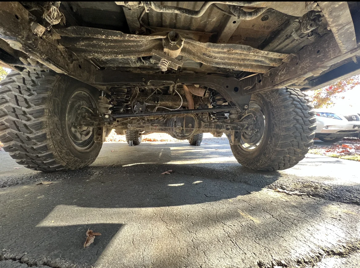

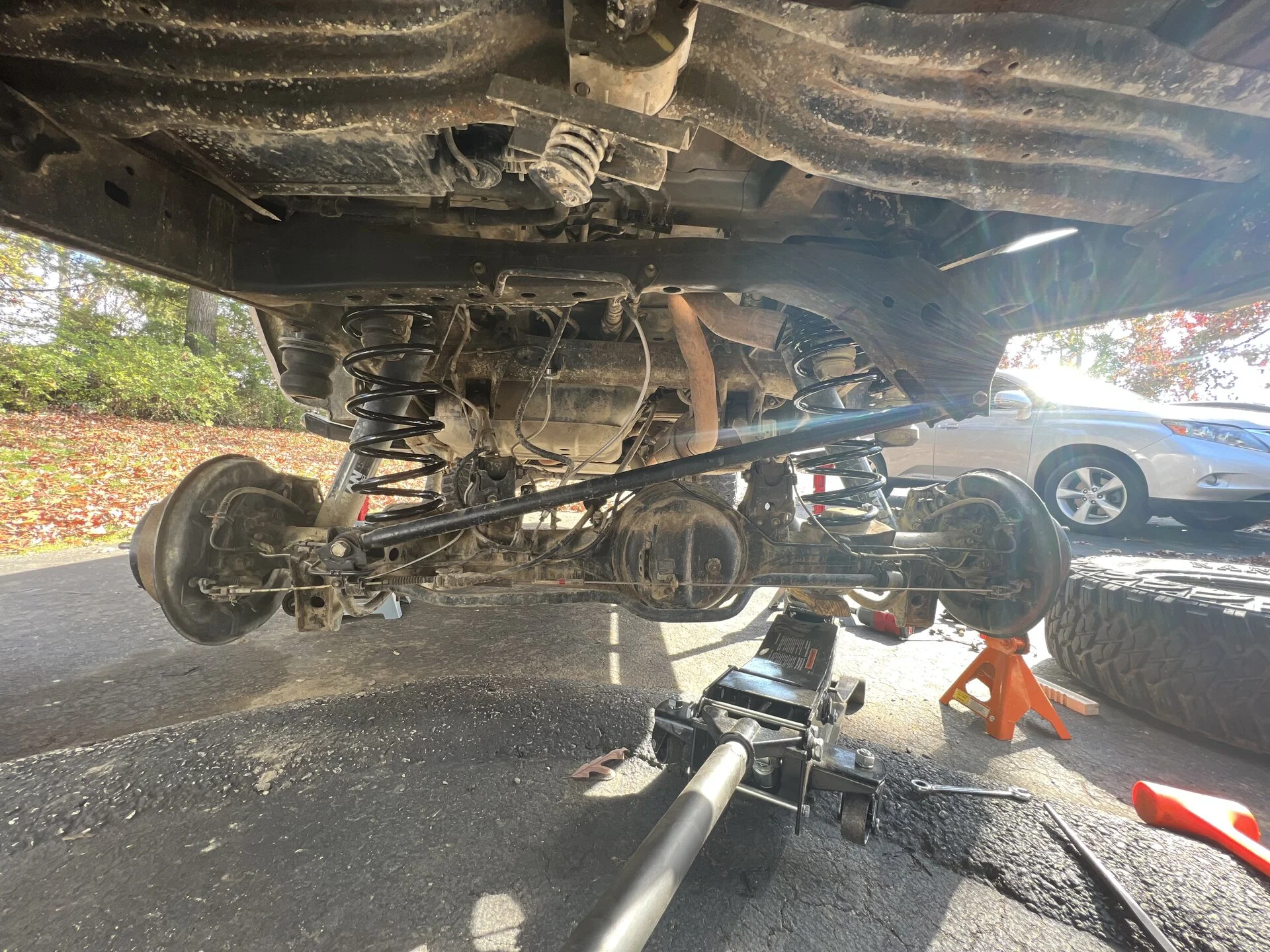

Hello all,
I decided to create this thread to help others and to be a one stop shop for any questions regarding the long travel set up I have in the rear.
I am not running sway bars. And I’m at -6 offset on 315/70r18 Yokohama geolanders. I’ve trimmed the front fenders about 1” and added 1/4” bump stop drops to the front.
Parts
Rear springs
Dobinsons dual rate springs in either 2.5” or 3.5” from an 80 series
Shocks
Ironman Foam cell pro shocks for a 80 series running 4” lift
Shock info
Stock Ironman Foam cell pro rear shock specs
For 100 series:
45796FE is 615mm extended and 401mm compressed
For 80 series
The 4” is 45862LFE is 670mm extended (26.3”) and 409mm compressed (16.1”) running this with a 2” Bumpstop drop and 2” axle shock mount raise
Kings are 25.11” and 15.27” collapsed and extended
Custom length id want 26” extended and 16” collapsed.
Another option is the icon shocks for a 100 series. I believe the specs were almost identical to the 4” IMFCP shocks.
Bumpstop drop (important)
Disclaimer: if you have the incorrect bumpstop drop length for your shock choice, you will prematurely ruin your shock.
If you leave the axle side shock mount alone, all you need is to add 3/8” bumpstop drop.
If you chop and raise the axle shock mount 2” like I did, you will need a 2” bumpstop drop.
I am running the delta 2” bump stop drop
Spring Retainer
Delta spring retainer, I believe cruiser patch is working on an option as well.
Optional:
Upgraded rear bump stops (I’d recommend Perry parts)
Axle side shock mount 2” chop and raise (this is why you would need a 2” bumpstop drop)
Another bolt on option for adjusting the axle side shock mount would be adding an AHC spacer from cruiser patch. I do not know how much this will raise the shock mount, but you will need to adjust your bumpstop accordingly.

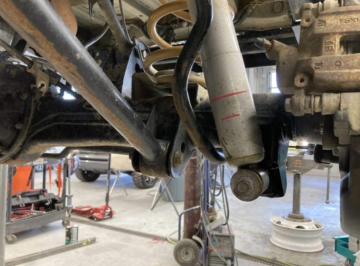

For the rear, raising the shock mount for me is 2 fold. 1) more clearance 2) more droop. I hardly ever hit the shock mount on rocks anymore and I’ve got 2” more droop (from the relocate)
The OEM design on the rear is for the shock to be the limiting factor, so I do not think it is bad for it.

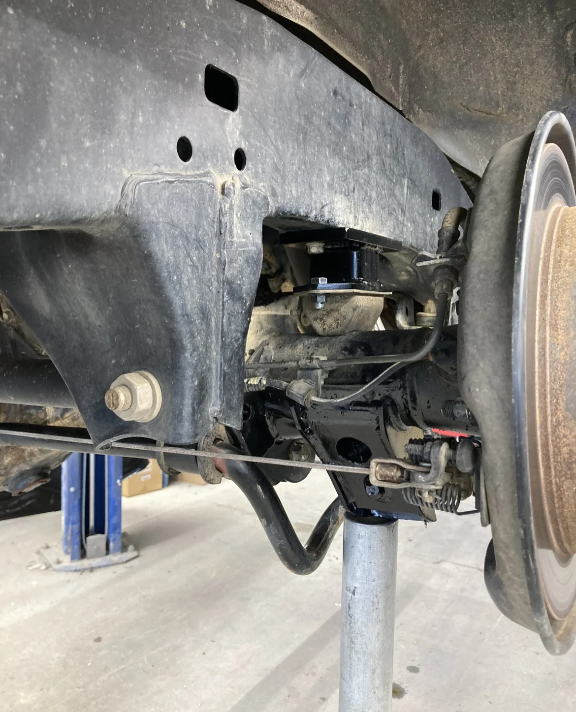

My buddy did the cutting and welding of the shock mount relocation on mine (no photos) and these are the photos of his truck. He did his first, and I liked the idea so we also did it on mine with the longer shocks.
And here are some close ups. I believe he ran a sway bar for awhile afterwards. He is running the tough dog suspension. Without changing shocks and just doing the chop and relocate and bump stop drop, he gained a lot of down travel. He has a 1998 model, and did not need longer lines but spaced up his brake line.
One issue I ran into with the sway bar, was it contacted the rear shock body on droop and limited down travel. No good.
This may have been due to the size of the IMFCP shock body. With Alex’s tough Dog suspension, I don’t think he encountered this.
