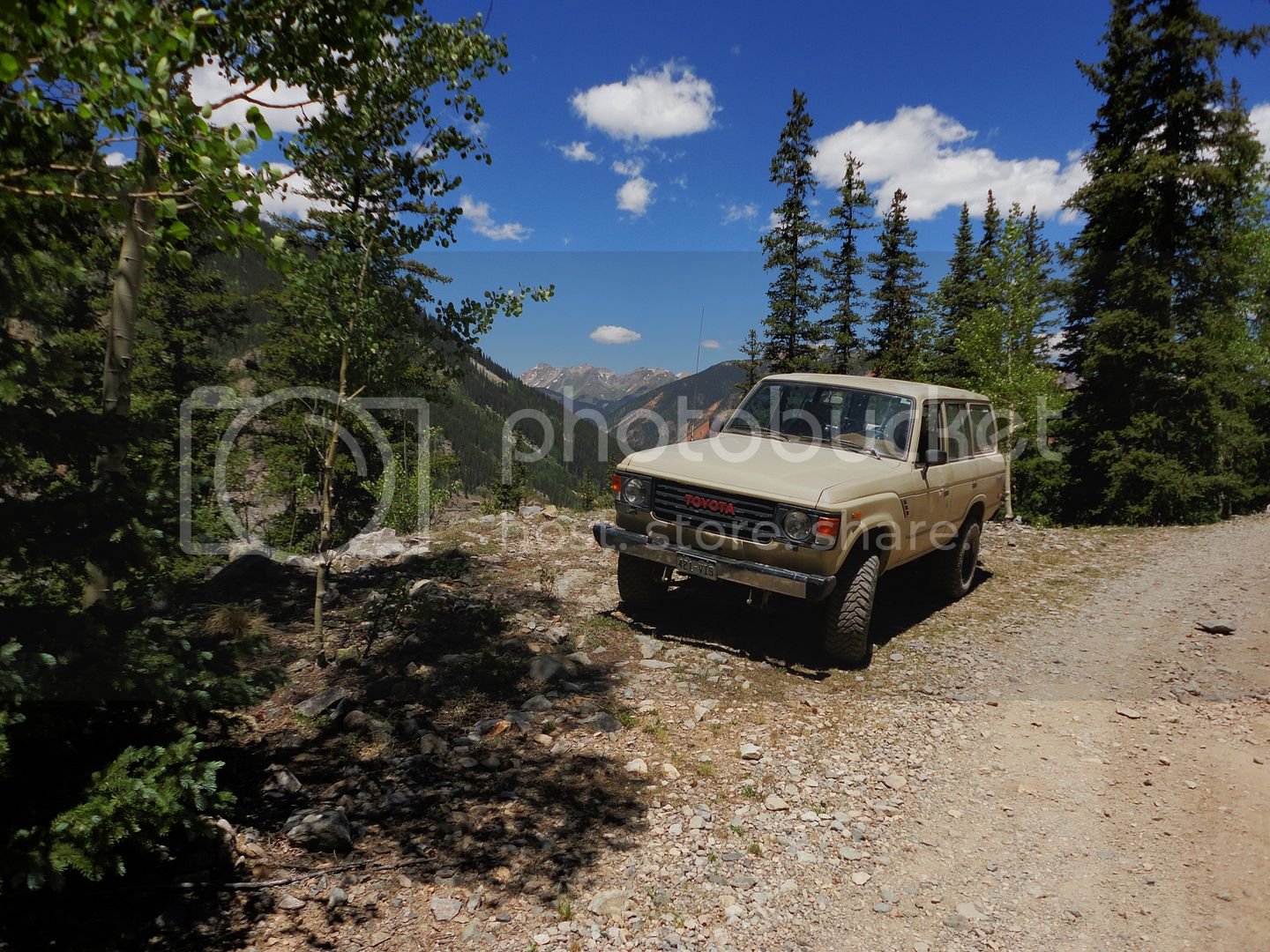

Probably in the '60, it's close, had it out a time or two already. Got the new shaved, rebuilt head; the MAF tri-y headers and exhaust system and the recurved dizzy in the garage. . . all so I can go here:
On the Kendall Mountain road near Silverton Colorado.
