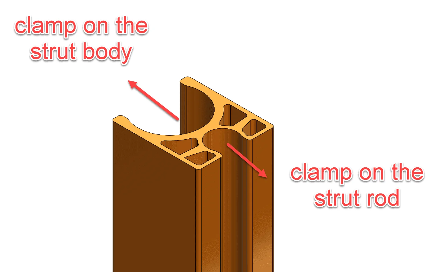

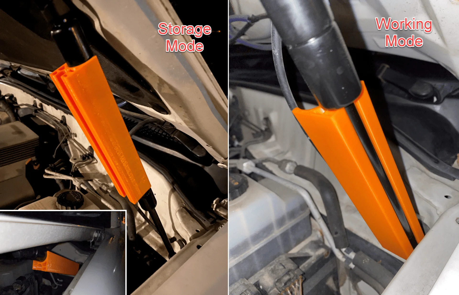

Being stored in the engine compartment is a great idea. The follwing diagrams and pics show one of the possible solutions.
Will leave the prototype in the engine bay for a few days to see if it can stand the heat.

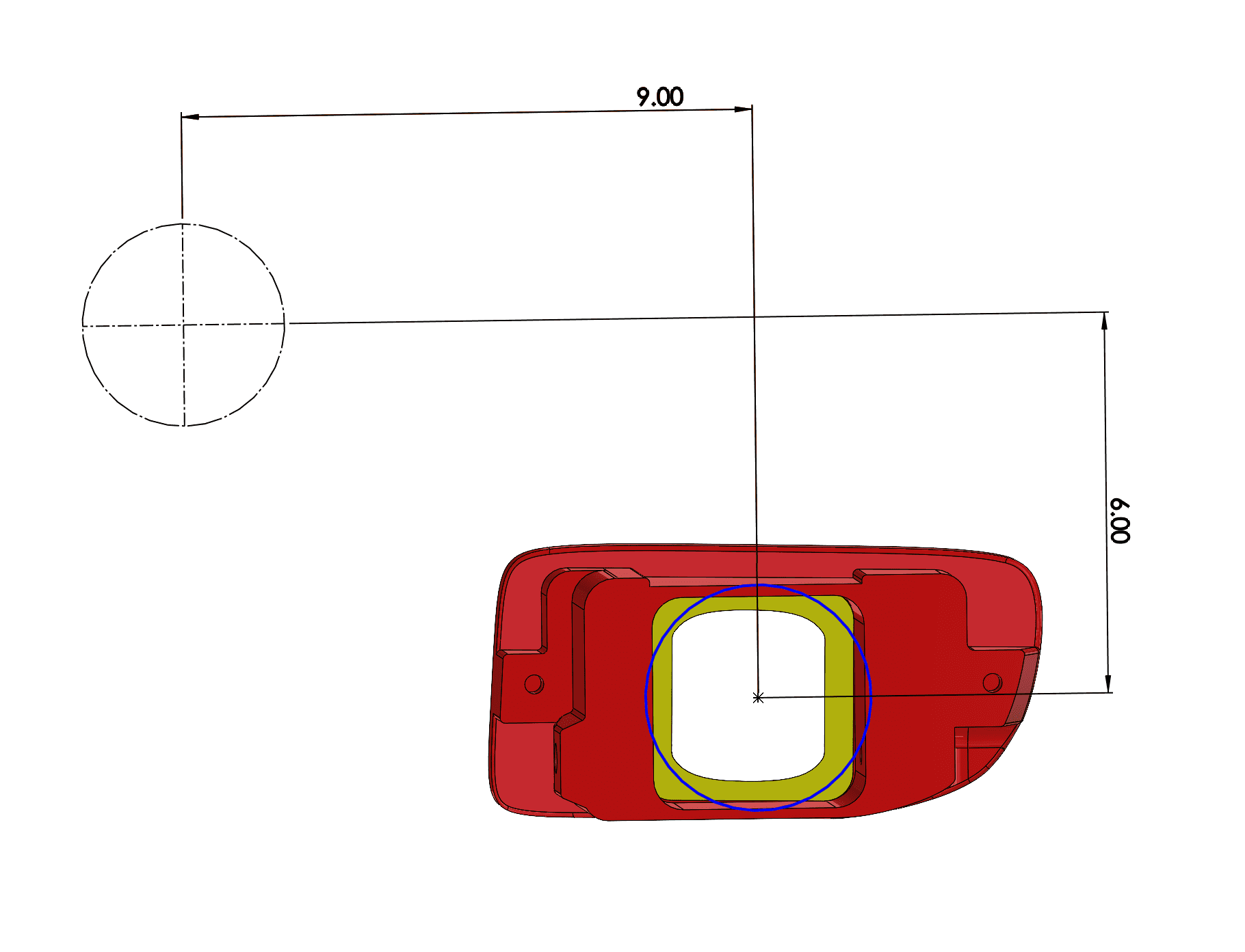

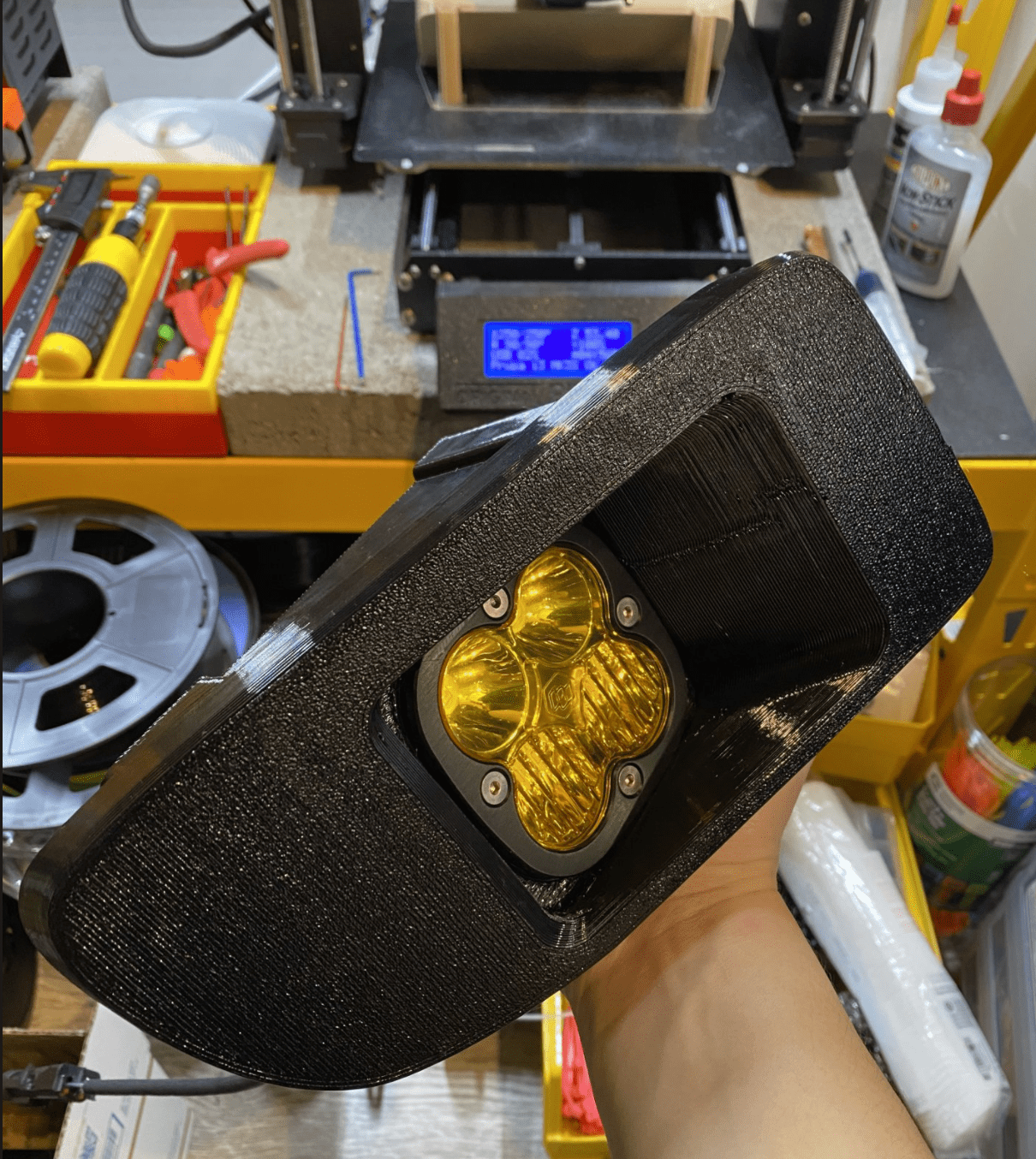

Updating on the Baja Designs Squadron mount
Mailed this to @TLCOVERLAND
He measured the pattern. It should point 9 in to the passenger side and 6 in down from 10ft away.
The adjustment is done in CAD.
Now printing a pair and will send them to TLCOVERLAND for more testing.

This prototype was in the engine bay for the last two days. Nothing was wrong. But it is still cold in Ohio. Anyone in Arizona or hot places want to test it? Let me know.
