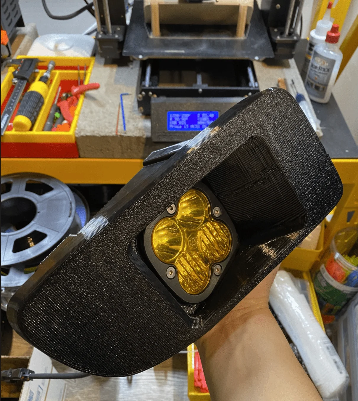

Updating on the Baja Designs Squadron mount
Mailed this to @TLCOVERLAND

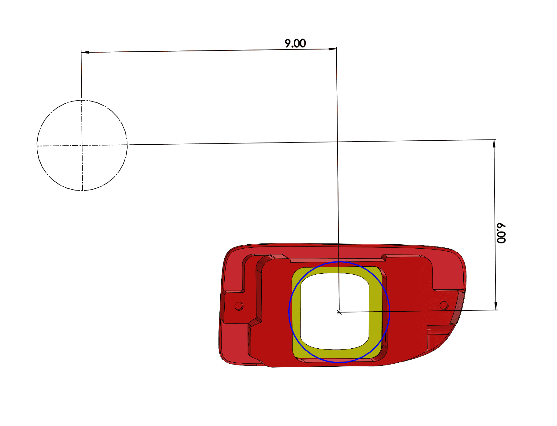

He measured the pattern. It should point 9 in to the passenger side and 6 in down from 10ft away.
The adjustment is done in CAD.
Now printing a pair and will send them to TLCOVERLAND for more testing.

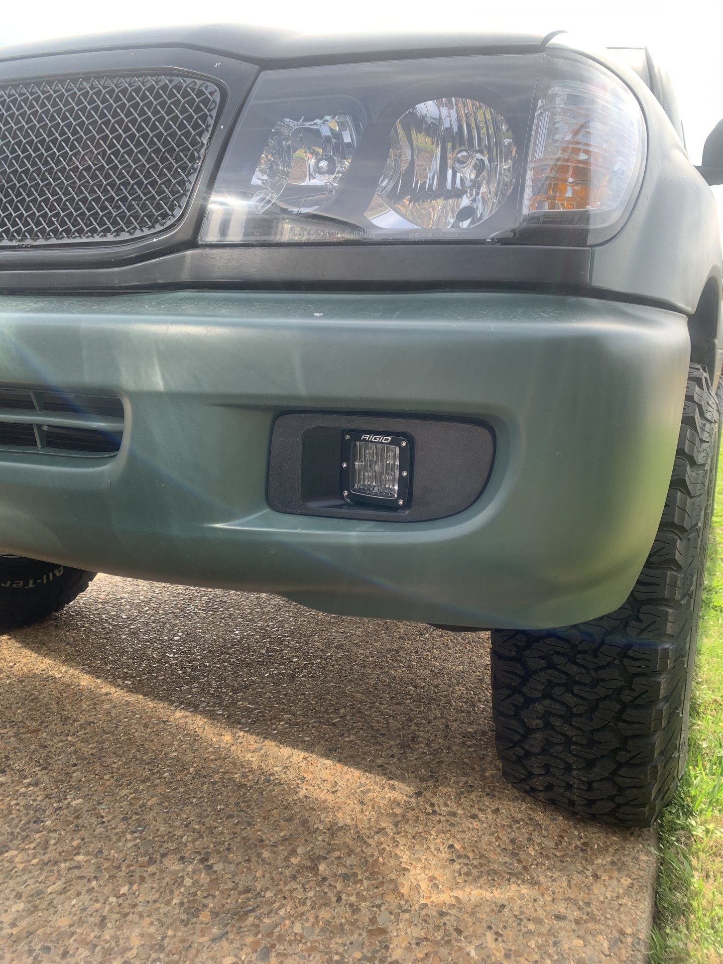

I got mine last week and will try to get them installed this weekend. Impressive printing on these, @BenCC, I was impressed with how well the RIGID lights seat into it and mount securely!
I see. I am also aware LX foglight housing is longer. It may have the space for two Squadrons on each side.
2 Squadrons would be awesome,if u can't fit two than the s2 would be great too.I will be converting my lx to lc turn signals anyways,can't wait for the results.
