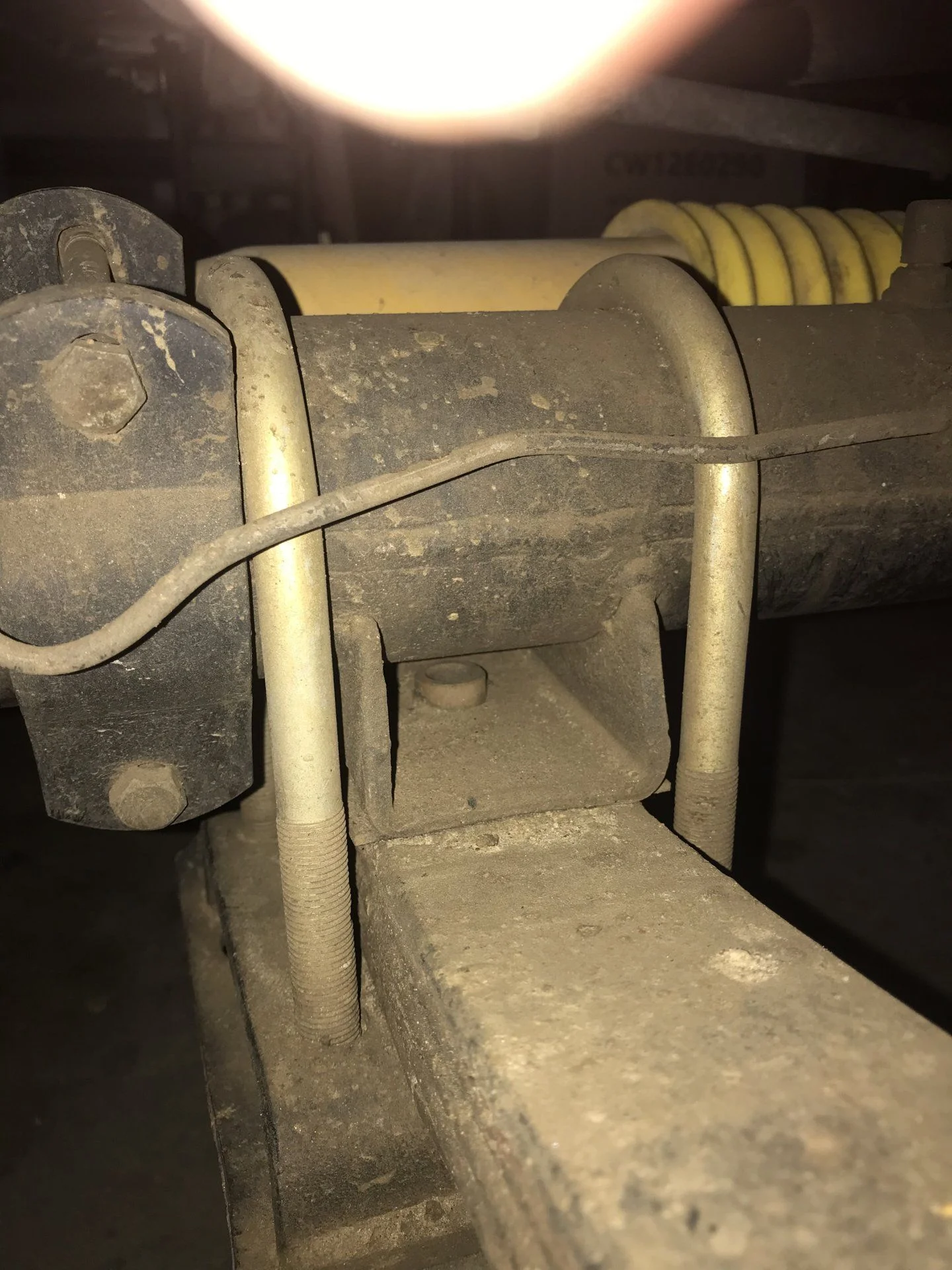

What are my options to fix wallowed out holes in these spring perches?
Looks like Ruff Stuff Specialties sells new perches. Is it best to just cut these off and weld on replacements? Thanks.

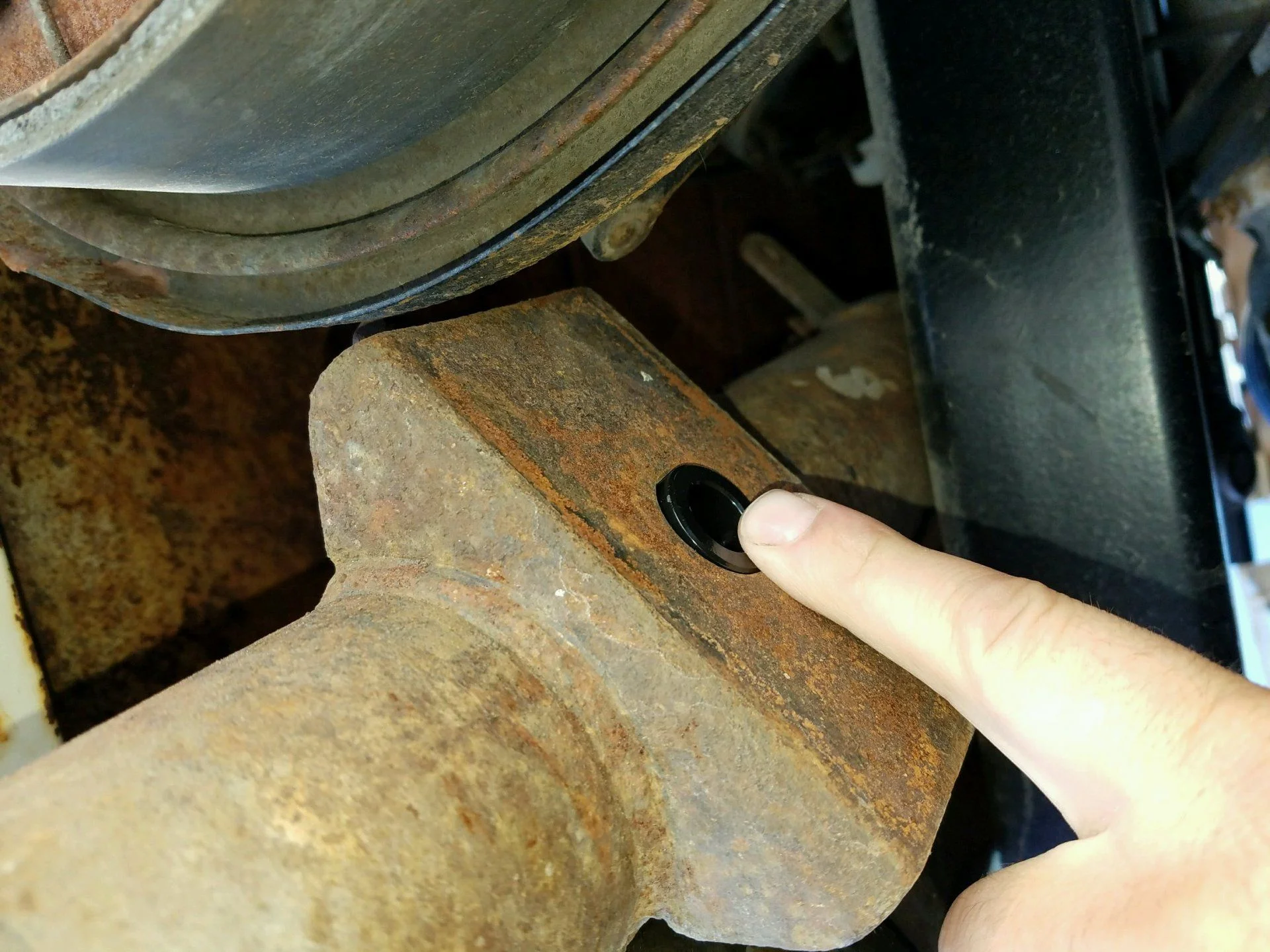

I machined out my elongated perch shackle pin holes and installed hardened drill bushing that seemed to work fine. Also keep your ubolts tight, like real tight and you will be solid again.
Got a picture?
Here’s a pic of my repaired hole. I would suggest a little longer bushing, these were .500 long, so maybe .750 long and then they would stop at the axle OD.
I think the dom tube spacer sit on the axle tube
OK. I was thinking it was just a sliver of tube the same thickness as the perch.
We are talking about a short section of tube that would be the same length as the distance from the axle tube to the perch, plus the perch thickness. Then it can't fall out.
