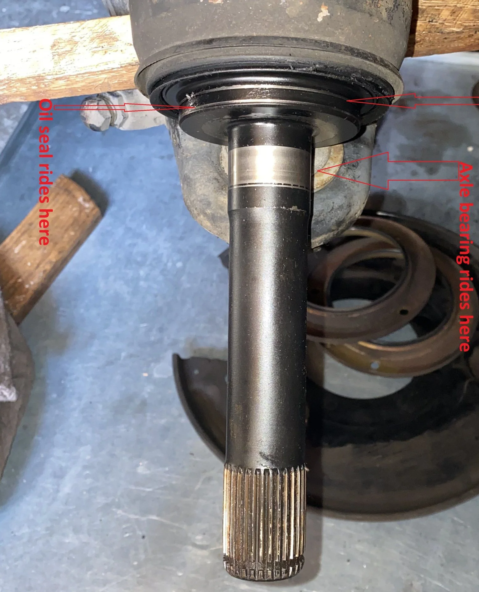

Here is one case in which a rebuilt FDS (front drive shaft, AKA CV) was used. The re builder paints all axles when they rebuild. I've remove the paint before installing, the best I can. If not removed, the paint rubs off on seals, bearings and hub flange splines.

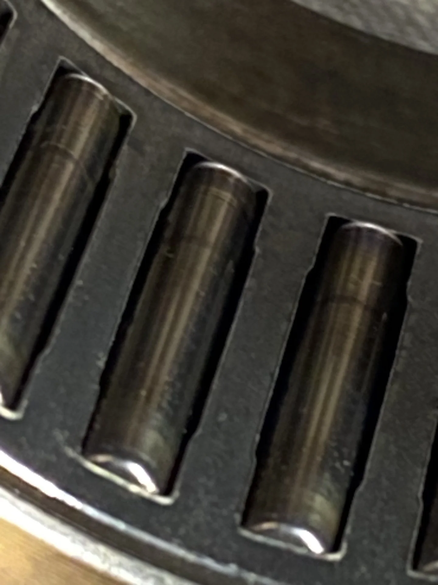

I'm not sure on this set. Do I replace or are they fine. Seems paint has stained the bearings, and likely races. Is this going to cause more or less fiction, heat, vibration uneven wear. Or protect and run smoother?
Thees feel smooth and roll nicely. My fingernail does not catch as I pull across.

Here's one of the rebuilt FDS (PS). You can see they painted the axle. Paint has rubbed off where axle bearing oil seal rides.

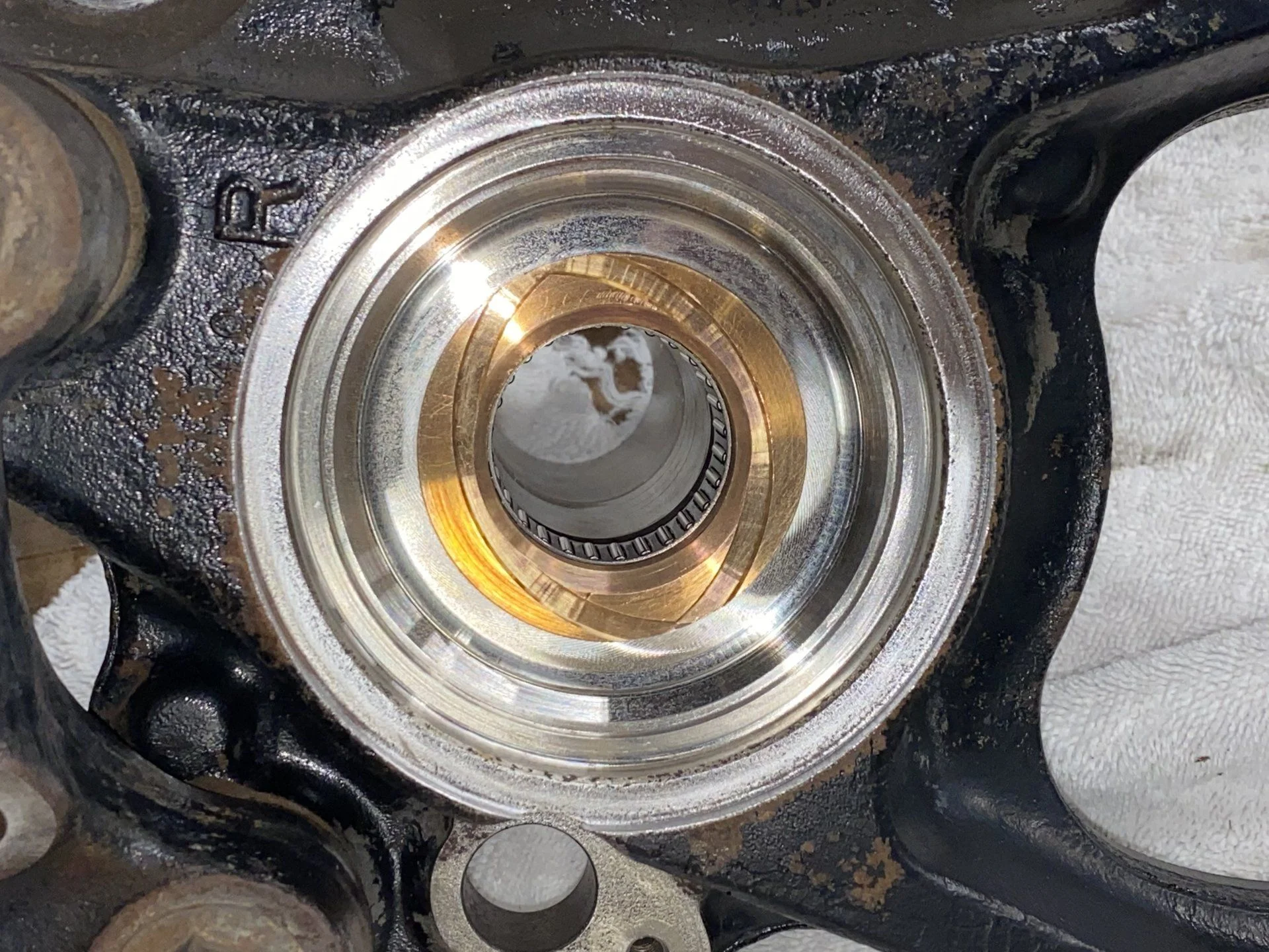

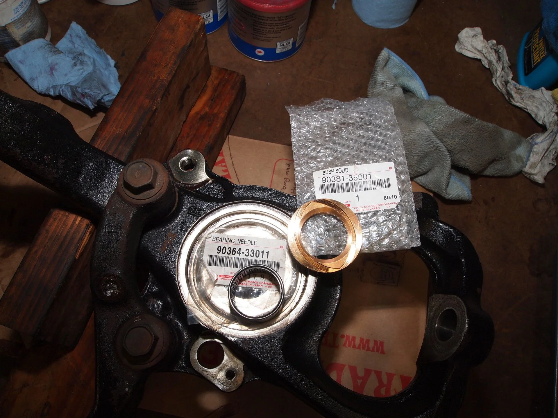

Here is brand new Toyota supplied.

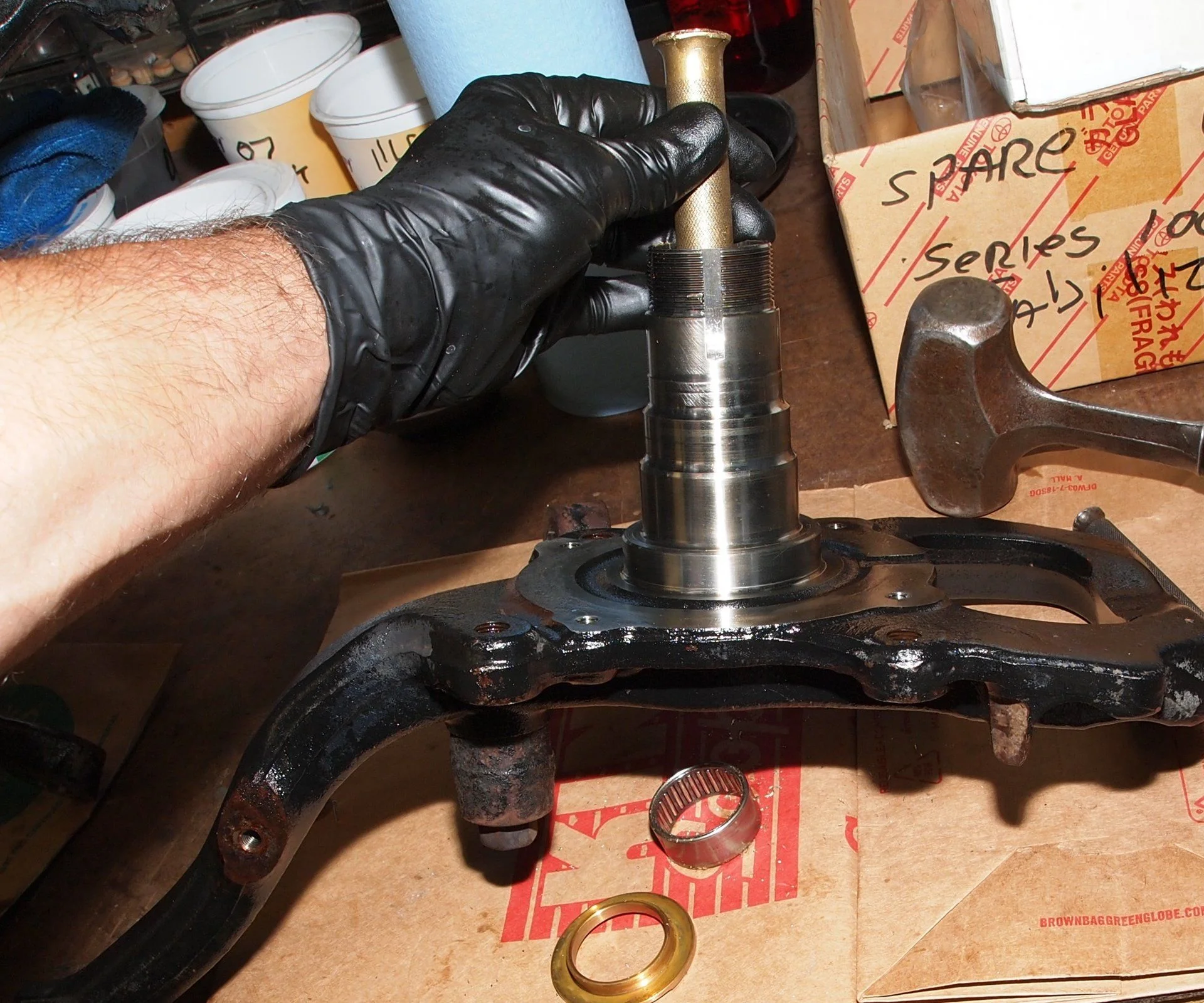

What is the process of R&R the needle bearing? Do you need a blind puller to get them out or is there a lip/race that you can get a tool on and work it out?
There is a lip that can be hit with a long brass drift from the opposite side. I used the old ones to tap the new ones in. No specialty tools required.
Smaller puller would work. I just use a brass dowel.

Those look fine to me. Needle bearings are exceedingly tough by design. RUST is their nemesis. With even the slightest amount of lubrication they last a LONG time. The bushing looks fine too.

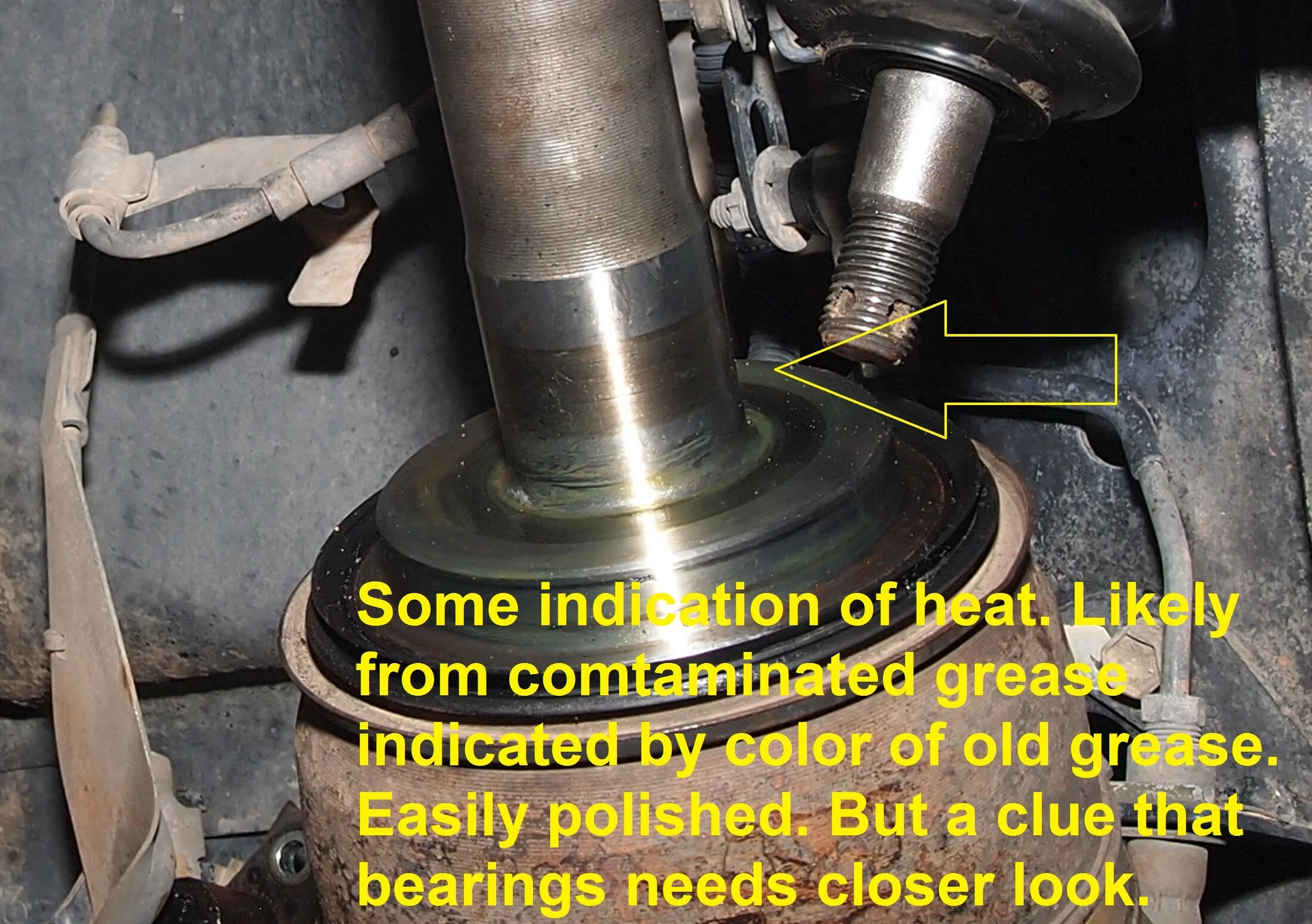

Here's how I inspect:
Inspect axle where bearing rides. I look for scoring, discolor or any damage that indicates a bearing issue.
Clean bearing and inspect. I look for scoring, pitting, discolor or damage. I feel how smooth or not they roll.
The set in OP, is unusual. Because the rebuilt FDS (front drive shaft) were painted (hate that). So I've a supper thin layer of paint or so it appears. Making it difficult to inspect. Also I'm a little uneasy using on new OEM FDS. But at same time I do not like to waste parts.
Considering the cost, I would replace just for the peace of mind, due to the contamination. Probably it doesn't have negative side effects, if the rebuilder does it to all, but then i would rather grease my bearings than paint them.
Comparing the pictures of the new cage and bearing against the one youre questioning- Id leave them in and move on to the next item on your punch list.
Originally I thought the leading edges on the cage looked rough- pitted but looking at the brand new cage it looks the same. In fact I dont see much difference. I think you have enough consensus to leave them in.

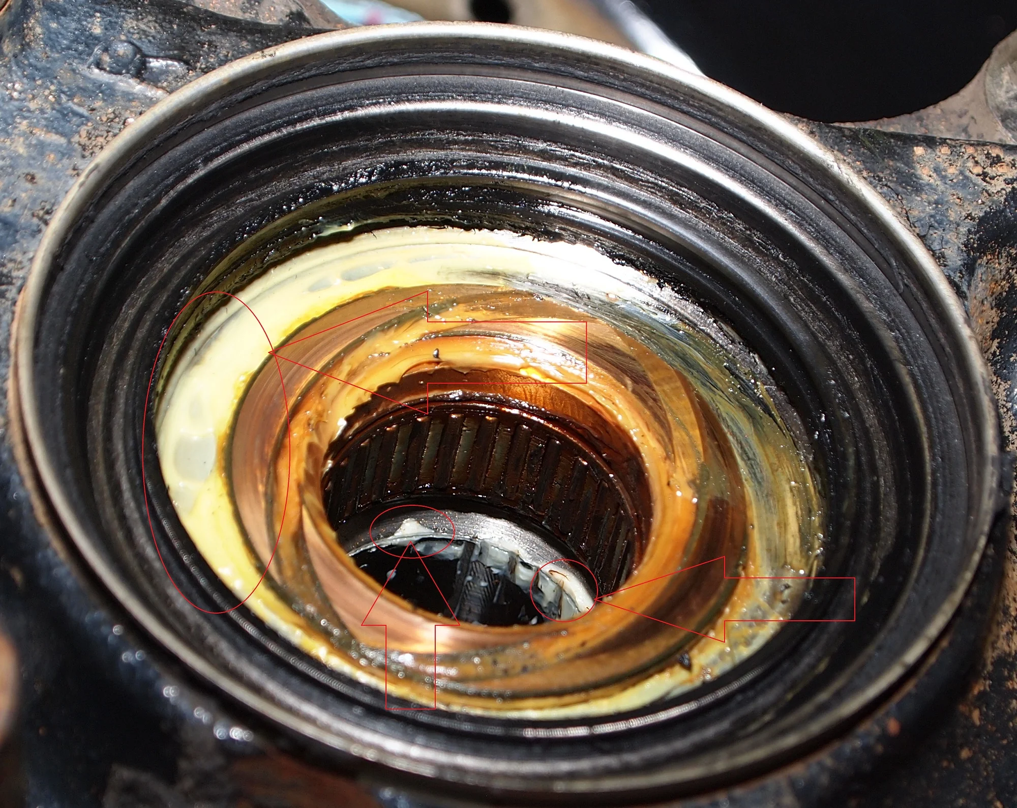

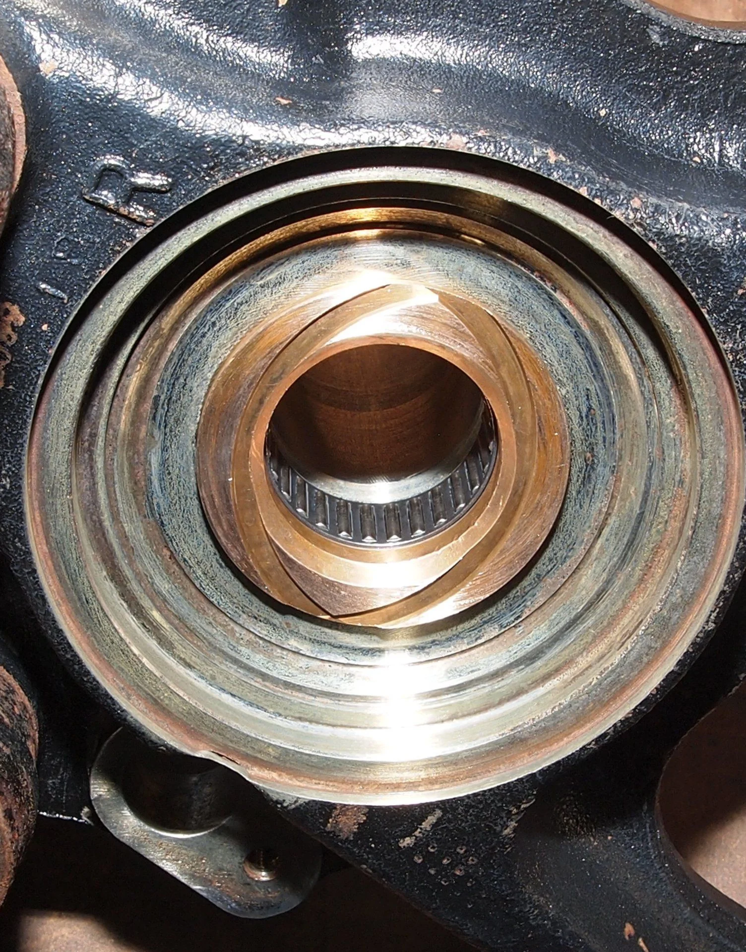

I'm in process of rebooting my CV shaft and noticed a decent amount brass shavings from the brass knuckle bushing. Is this caused by incorrect CV snap ring gap allowing the CV to move in and out prematurely wear the bushing?
New brass bushing are 3mm thick, with a 1mm grease canal depth.
Excessive movement due to large snap ring to hub flange gap, it not much of a contributor to brass wear. Under lubed (greased) and or contaminants (sand) eat them fast. Unless you wiped grease out, yours had no lube.
Snap rings, come in various thickness (increments of 0.20mm from 1.8 to 2.8mm. Factory installs a 2.2mm) to compensate for wear of components.
If gap becomes to large, it also may allow contaminates past the seals (knuckle & axle). Additionally, a wide gap allows axle to move in and out, past design limitation. This act like a file/saw. Sawing away at axle splines and those of hub flange. If wheel bearing also loose, they chatter (vibrate). The combinations, turns axle/hub flange into a power saw.
Needle bearing is often difficult to determine if good or bad. First clue, is condition of axle where it rides. Second, is any scoring of rollers. Third, feel. If they've been run dry and dirty, Just replace them.
Factory gease, is white.

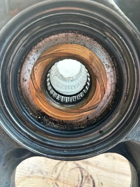

Thanks @2001LC. I didn't see too many contaminates in there other than the brass shavings, but the brass bushing was bone dry so that is probably the culprit. The needle bearings did have grease and felt smooth, but since I'm already in there I'm going to replace them as well, along with the knuckle seals.

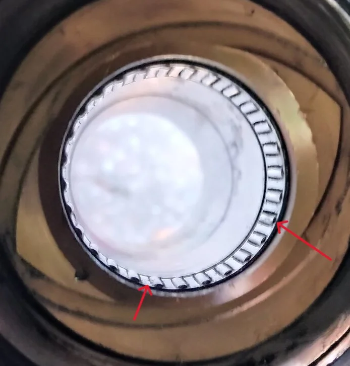

Having some bearing noise on front DS. Here is the story and curious about input from @2001LC

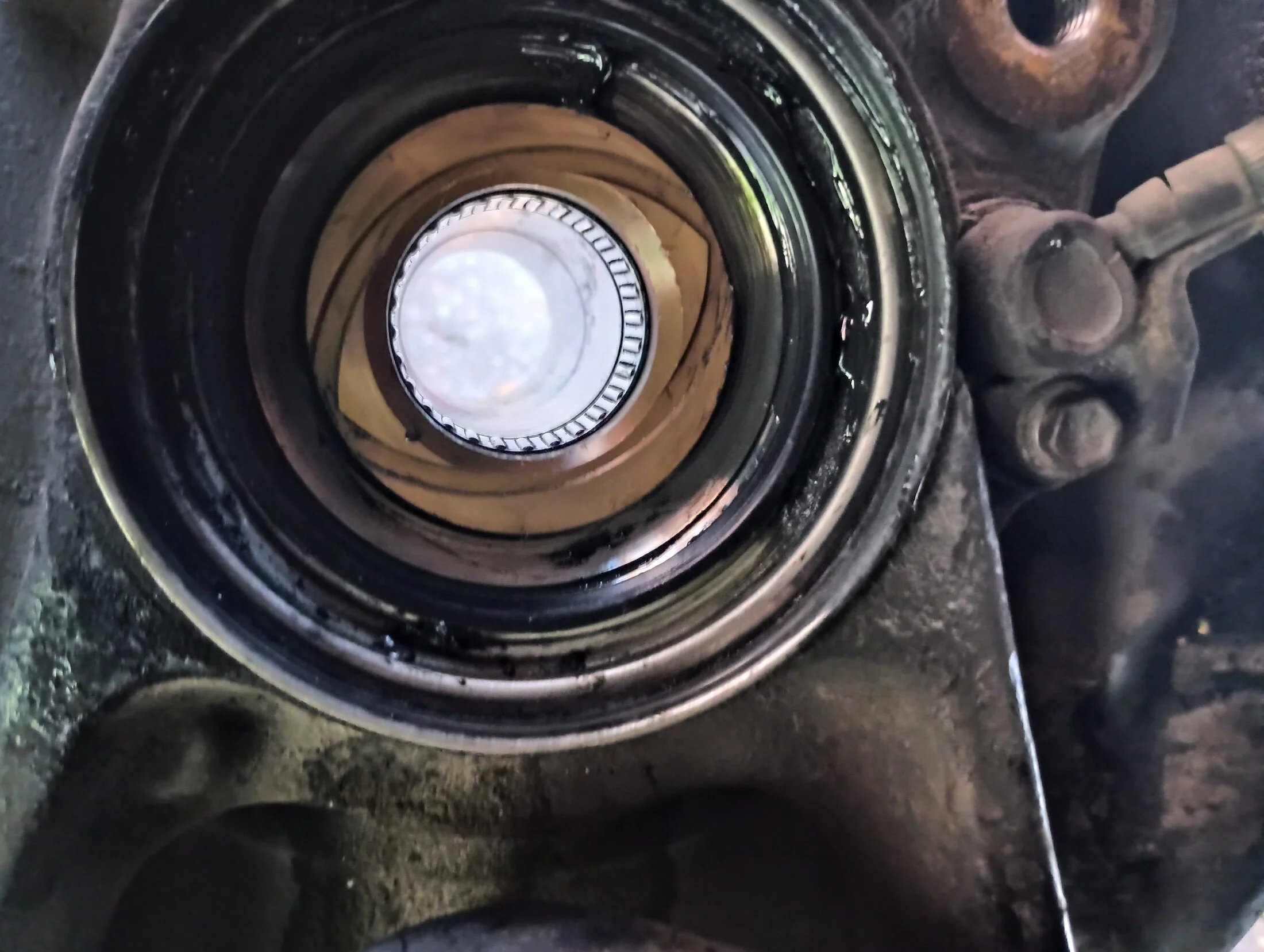

2003 LC with 280k miles. Noticed grinding noise at speed (20 mph and greater) coming from DS front. It was more pronounced on right turns and sometimes would trigger the traction control and startle me!!! So this needs be addressed. I installed a rebuilt axle about 15km ago (I know...that was dumb, should have used OEM from Toyota). So I thought that was the problem. I swapped in my back-up after rebooting that was originally in that spot and had no issues before (the boot just ripped and thought I would try a rebuilt). This didn't fix my problem...still there. I eye balled the needle bearings and they were still flooded with grease (I grease the bushing and needle bearing per maintenance requirements), but didn't look closely (dumb...need to re-pull shaft and have a look).
So...next step is pull hub and look at bearings. I pulled them tonight and they look fine!!! (Plan to replace with new since I don't know the mlast time they were replaced and torque required to meet fish scale was pretty high last time I repacked).

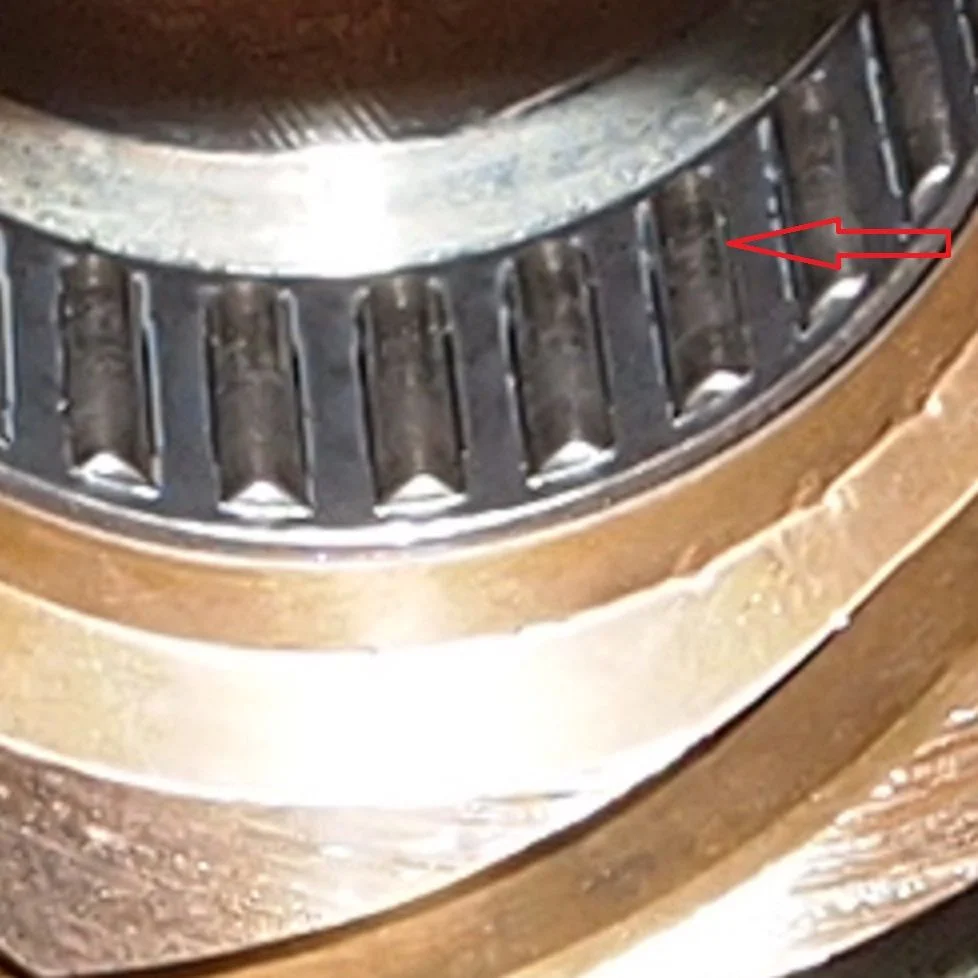

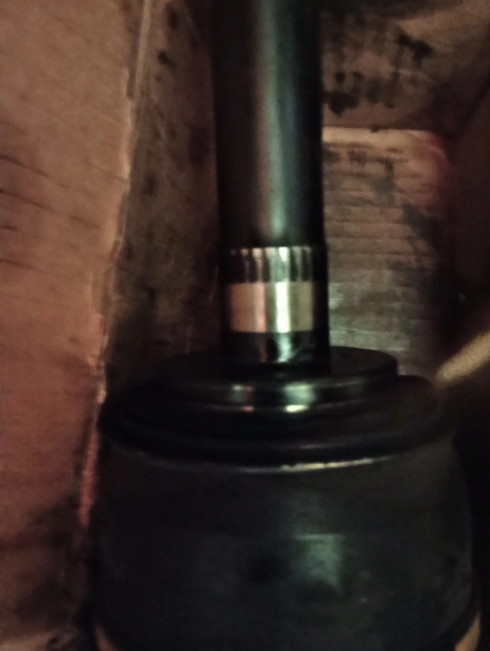

Lastly, I noticed needle bearing marks on the rebuilt axle that I pulled. Is this an indicator that the needle bearings are toast and would cause grinding noise that triggers the traction control?? The black spot is grooved (weird) and the bare metal spots are higher than the black spots.

The axle needle bearing will not affect ABS (traction control).
CVJ here in Denver does a good job, with remain FDS. But with a few issues, like cheap boots. Another issues is the wear on the reused axle splines.
They also paint black. The paint, helps, add volume to the splines. Helping to reduce hub flange to axle clunk. One of bad the issues with their painting. Is, paint gets into needle bearings. Seems to coat bearings, often unevenly. Which is a bad thing.

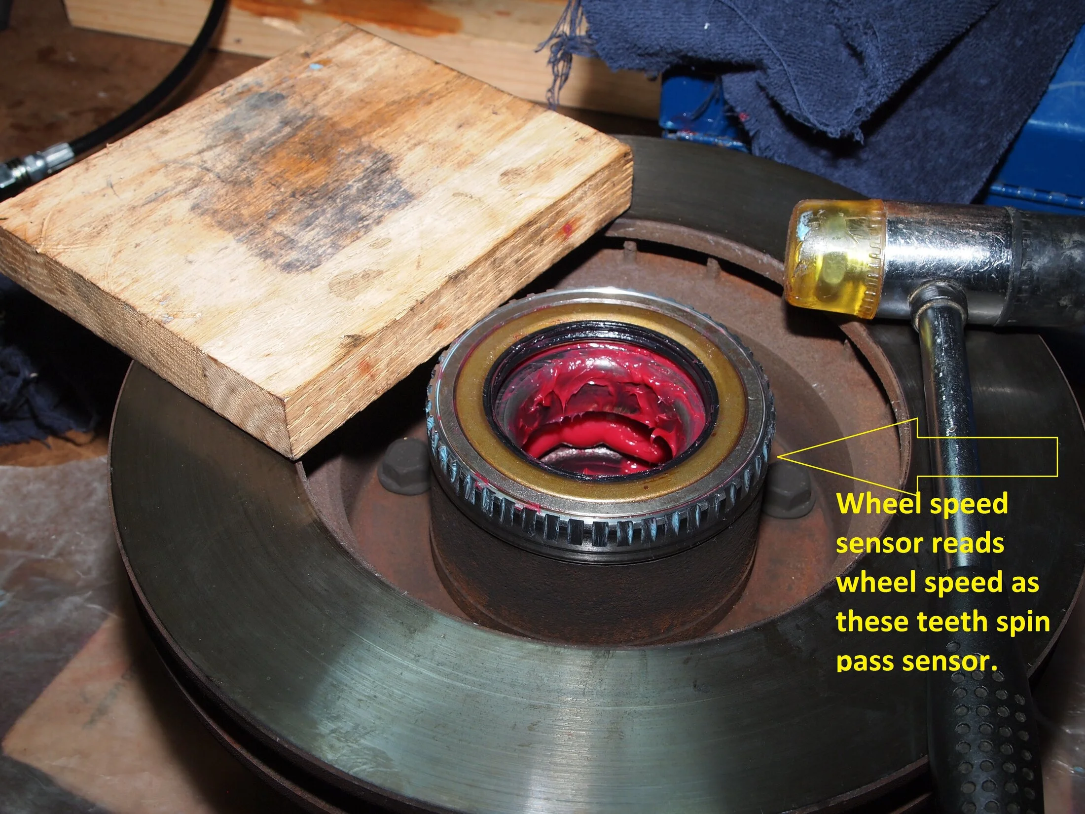

The number one cause of a false ABS (TRAC) activation. Is, loose wheel bearings. I've seen more than once, where someone thought they had wheel bearing preload set good and tight. No wiggle at all, and very high breakaway preload. Then wheel hub/bearings loosen fast. This is most often do to hub's rear seal installed backward. The lips stick out, and rubs knuckles' spindle. As this seals metal lip wears down, for rubbing. Wheel bearings loosen.
Another reason wheel bearing loosen after service. Is, lock washer not properly installed.

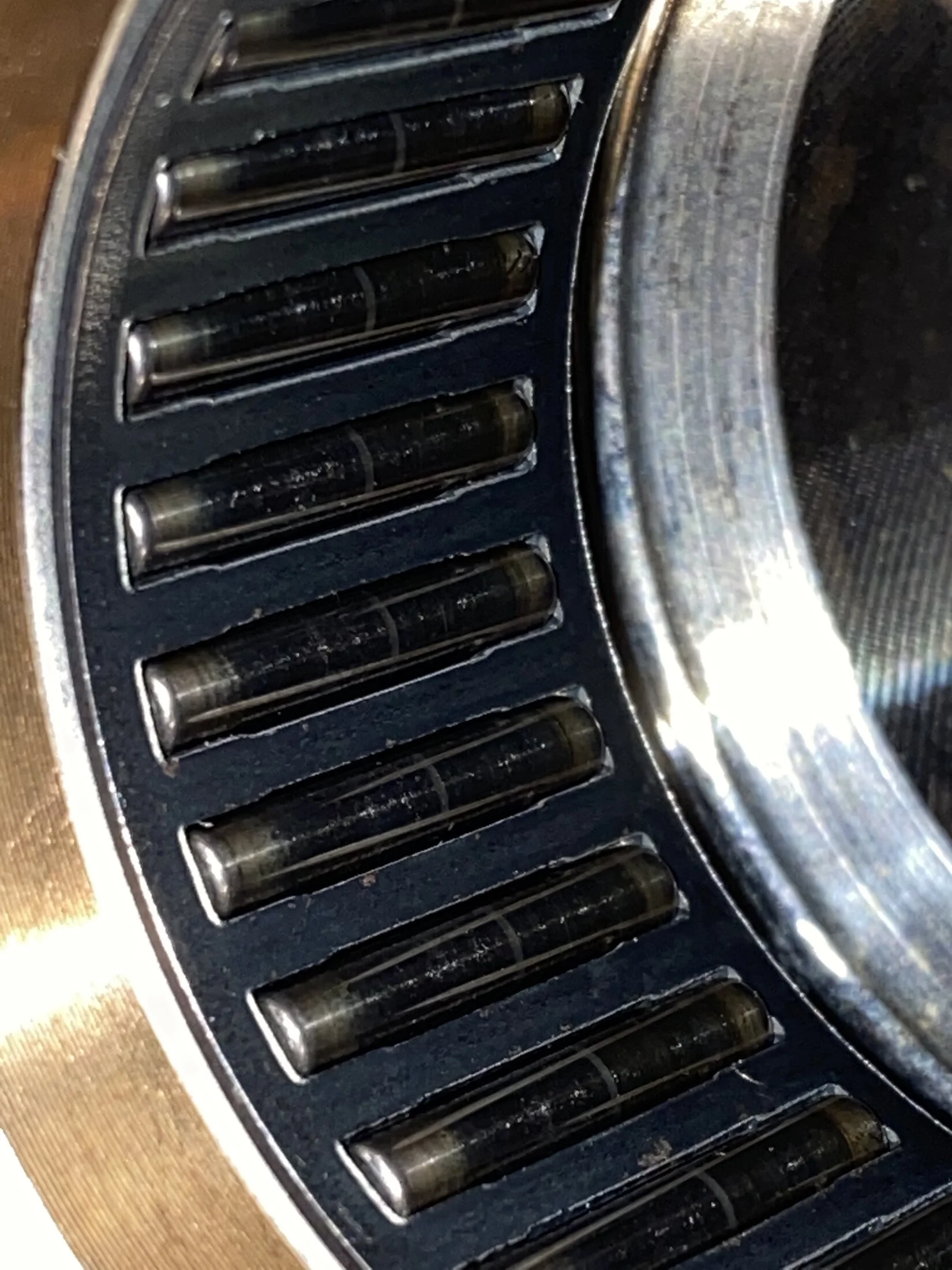

Thanks @2001LC . I did not complete the job this morning, but pulled the axle back out to look at the needle bearings. Seemed okay to me!! I did use a CVJ rebuilt with black paint coated everywhere.
Instead of replacing the bearings (had a commitment pop up), I cleaned and repacked the wheel bearings. Set the preload to about 12 lbs and buttoned it back up (needed lots of torque to get that). Still have the bearing noise and triggering TRAC sometimes on right turns. The TRE are new and the steering rack bushings have recently been done. I will replace the wheel bearings next weekend...have to wait.

Bad wheel bearings, are not likely going to be so bad they's set of ABS. If they were that bad, preload would be high with very little torque on adjusting nut.
Needle bearings are difficult to look at and make the call. That's why I use axle condition to help make the call.

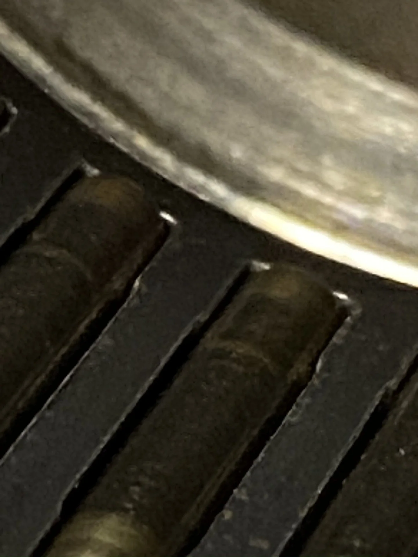

But I do see something on yours
Form my file. Bearings after trying to clean black paint off, not looking good.
