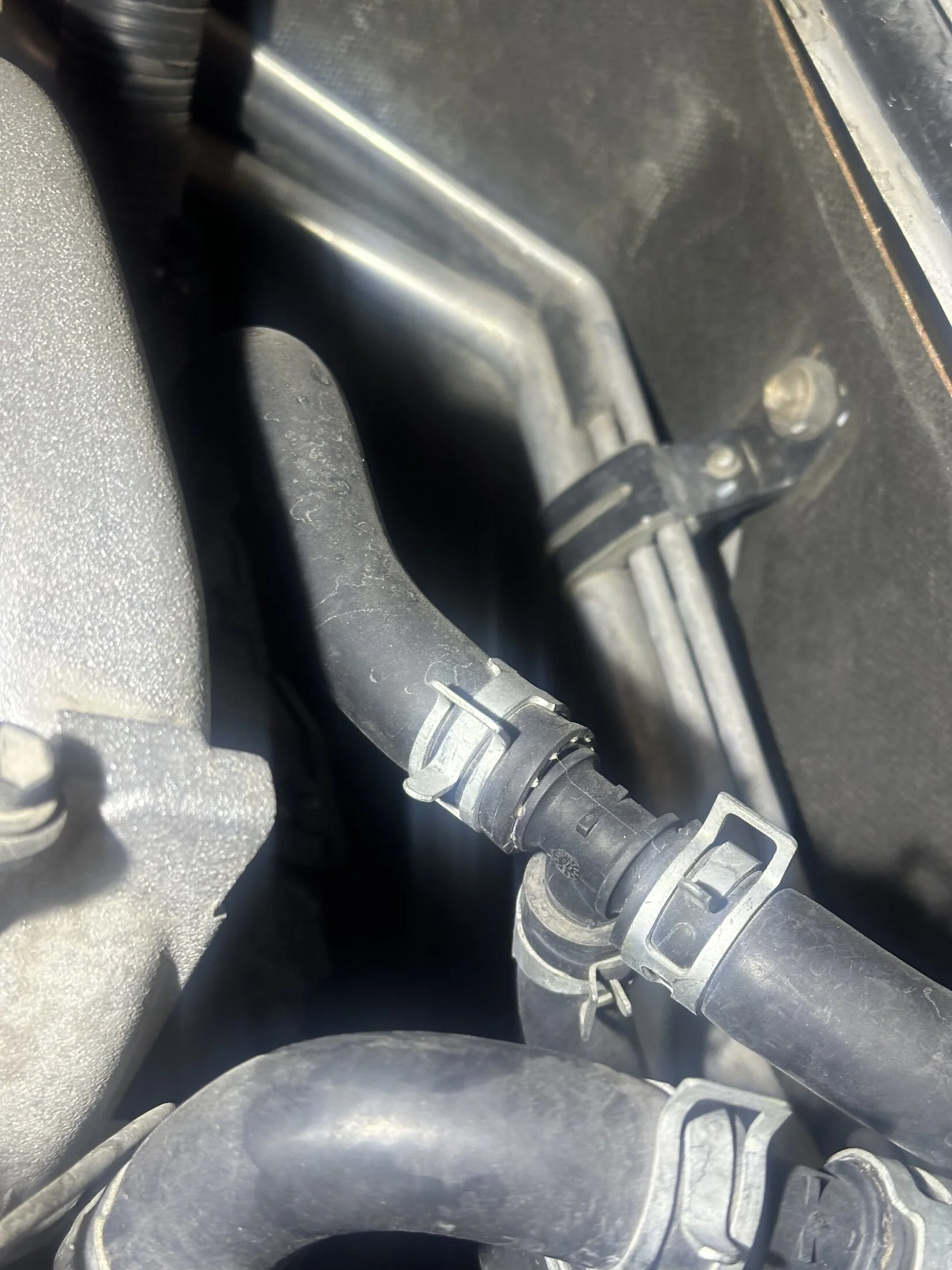

Should I replace these heater T’s?

I was examining the heater T’s today. They look pretty new. What do y’all think ? I have all new oem heater T’s and new oem hoses ready to put on. But looking closely at the truck ….even my existing hoses look pretty new.
Please advise. Would you even waste time replacing this stuff ? View attachment 3946151View attachment 3946152View attachment 3946154
The T's on my 01 LC "looked" just fine, as yours do. One crumbled as I removed it. The other had welded itself to the hose. Had to crush it with vice grips Install some metal T's.
