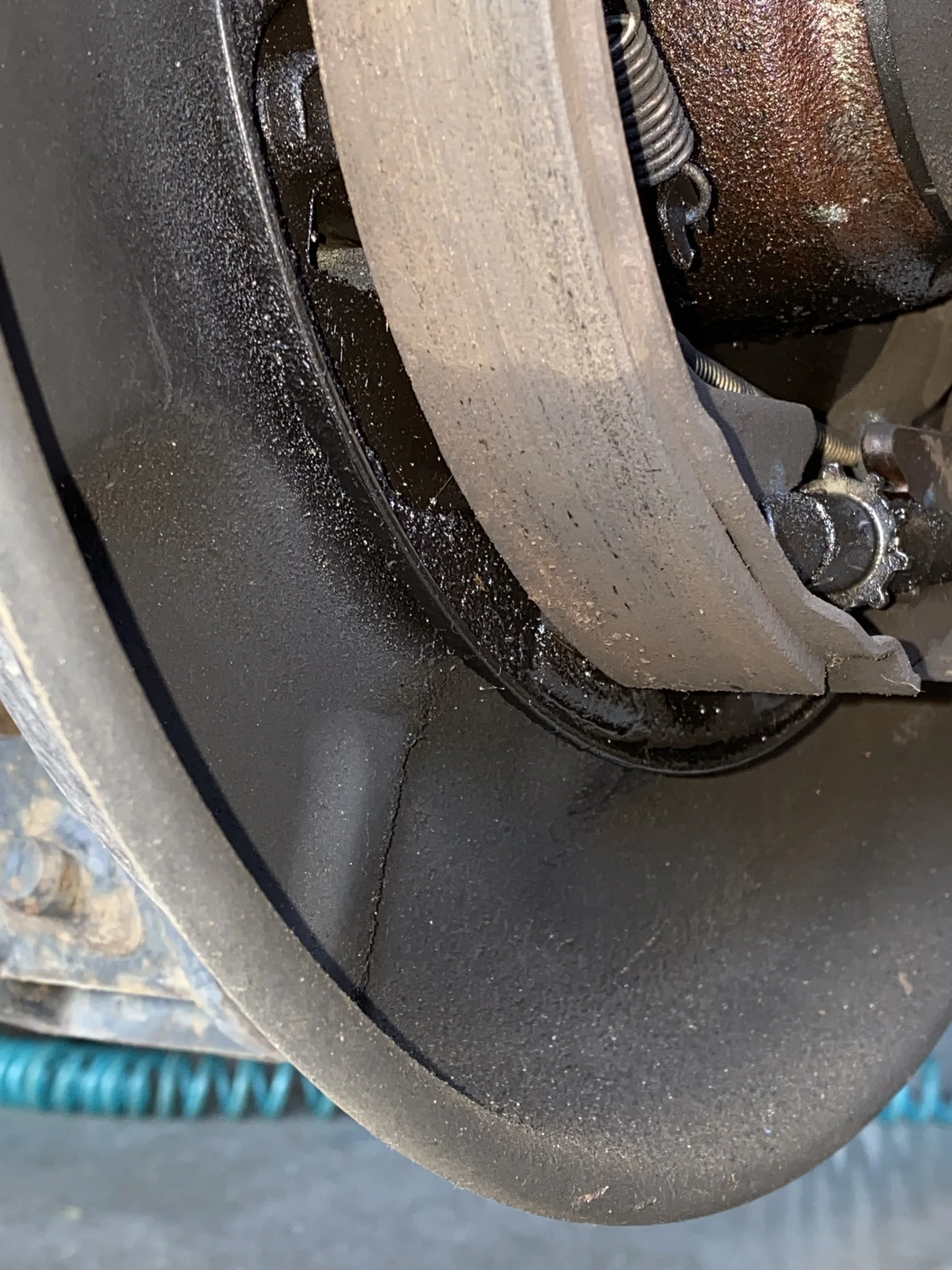

Other indicators of rear axle bearing failure:
1) Gear lube found past rear axle seal, getting to and passing through axle bearing.
a) Seen: In drum. Where axle housing bolts to brake dust shield. Inside cavity of axle housing, by removing wheel speed sensor.

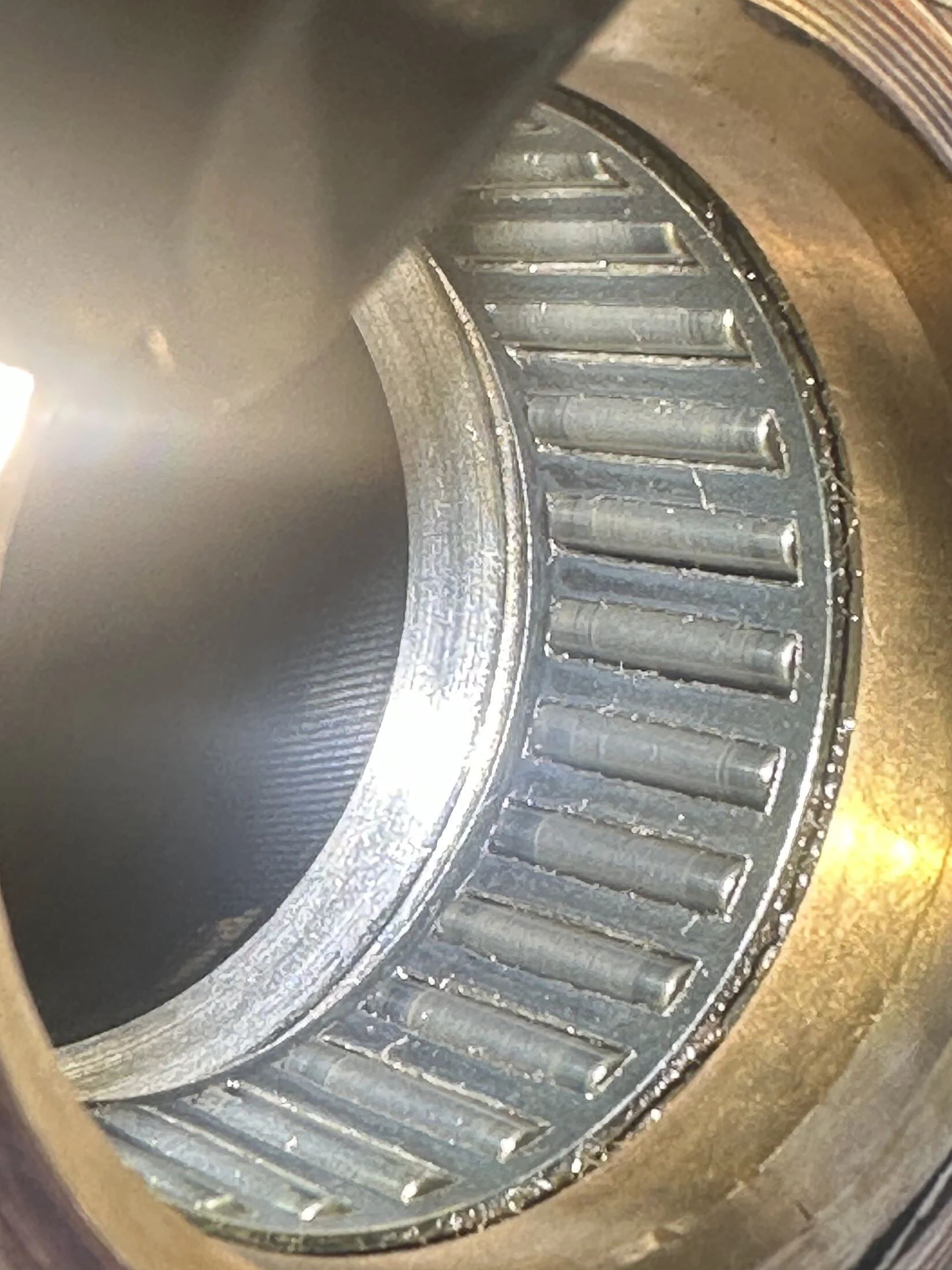

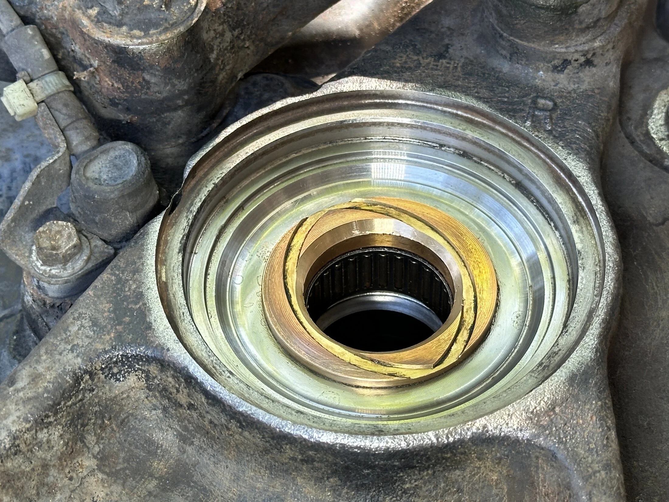

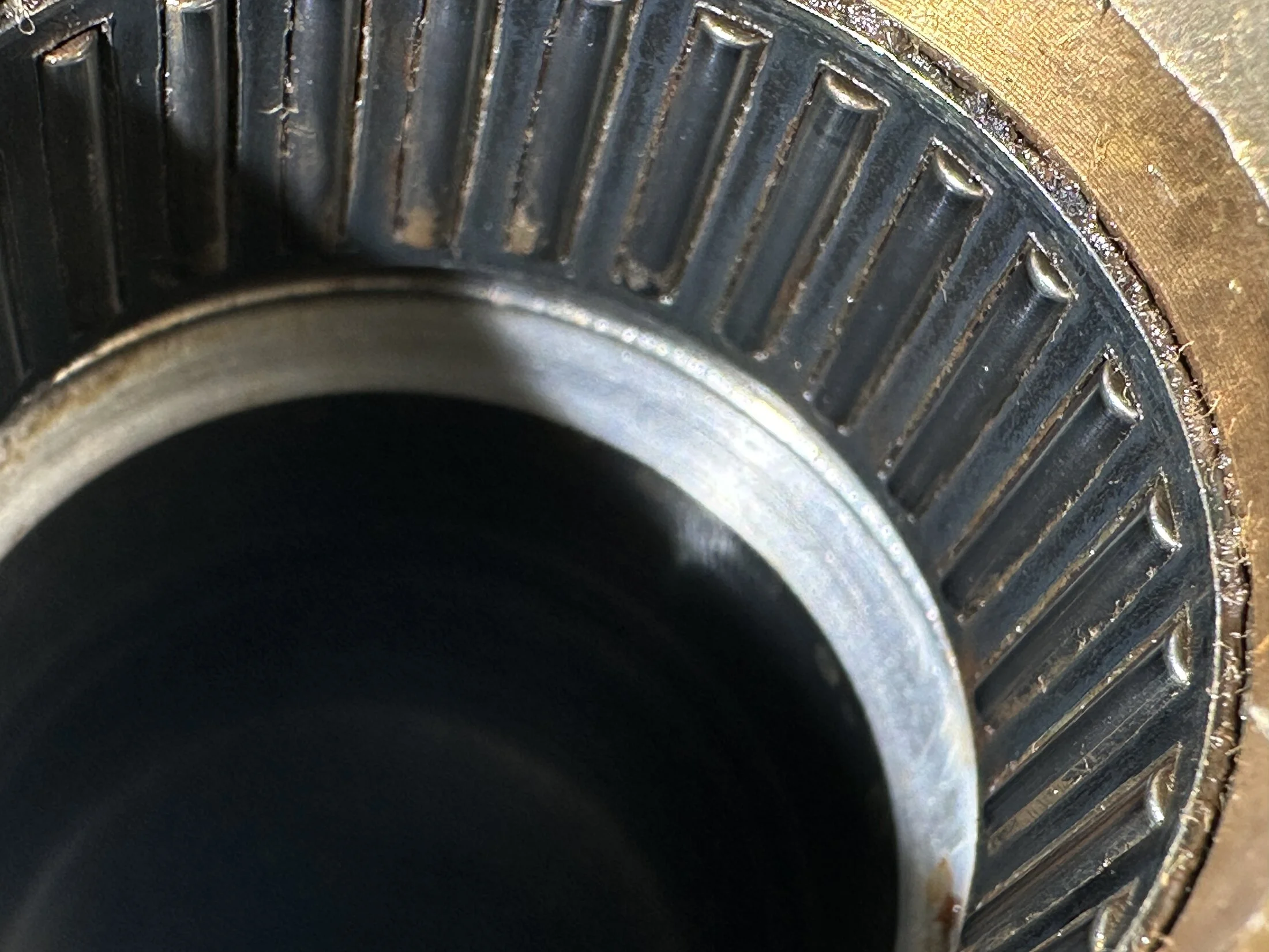

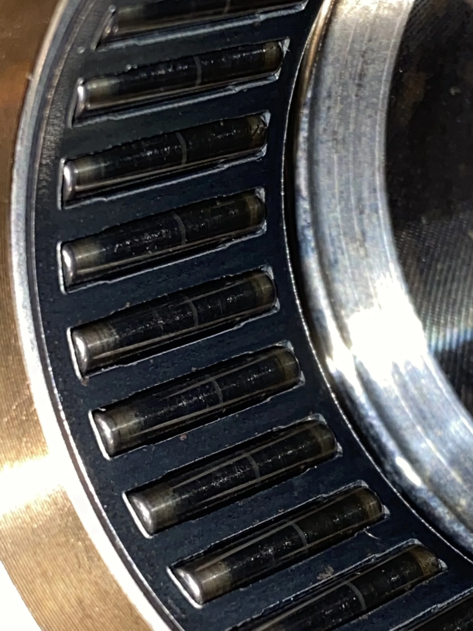

I'm in progress with a big front end overhaul and just wanted to share another data point here. My rig has 255k on it, and my needle bearing on both sides didn't appear to have been serviced in quite a while if at all.
But the good news is that they were also in good shape and rolled well and didn't appear to have any major pitting. So I cleaned them out and put in fresh grease and am going to run em. Hopefully we can go another 250k!
All cleaned up before a new seal and new grease:

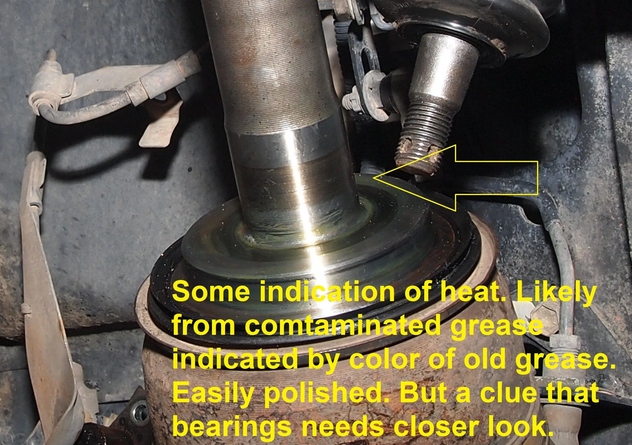

Although no "major" pitting. I do see scoring ( lines along with color & texture variation), across needle bearings. If you see scoring on axle of front drive shaft (AKA: FDS. AKA CV), also. It's time to replace them. If replacing FD, with new OEM, I'd absolutely replace those.
Oh man, I might have screwed this up then. Reading early comments in this thread made it sound like these are otherwise tough bearings and as a result I wasn't really prepared to swap these out. And yes, I'm putting in new OEM FDSs as well. At least the old FDSs that came out looked very clean where this bearing rides with no scoring.
I didn't really want to cut any corners on this job, but I might let this one run for a while as I'm at the finish line (yes I know, not really the right mindset)

If axle where bearings rode, looked good. Then you'll be okay.

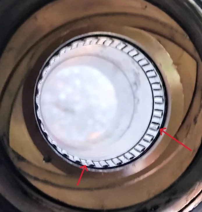

Needle bearings are difficult to look at and make the call. That's why I use axle condition to help make the call.
But I do see something on yours
Form my file. Bearings after trying to clean black paint off, not looking good.

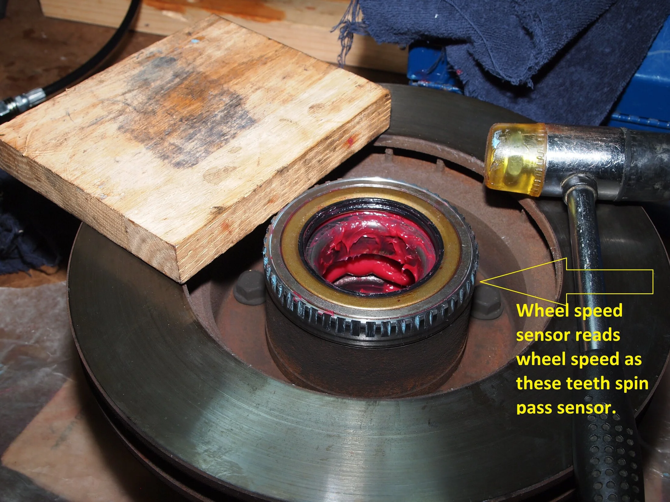

In the last photo that 2001LC posted, he showed the rotor and hub assembly sitting on the floor, with the rear side of the rotor facing upwards - this being the proper position to install the inner bearing and the seal.
Performing the exact same procedure myself, I noticed that, after installing the inner bearing and the seal, when I reached down into the hub to add some additional grease, that I could actually lift up on the inner bearing, just slightly. This caught my attention due to the shape of the seal itself. The face of the seal that goes into the hub has a lip, whereas the outer face is flat. My thought was that perhaps that lip was there to sit firmly against the bearing, preventing it from lifting so slightly as I had noticed. And maybe I’m completely wrong - that perhaps that’s exactly how it’s designed to be.

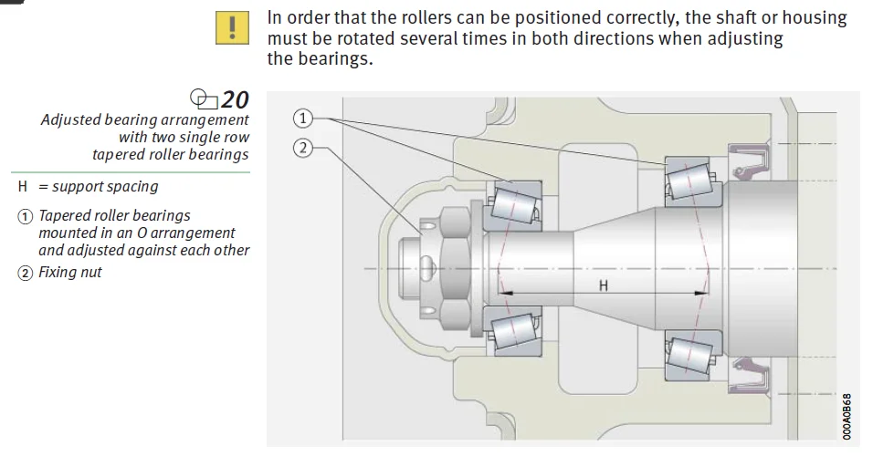

@BW100 oooooh I understand your question. Nothing to worry about. Your wheel bearings are tapered roller bearings that work in a set. When you tighten the lock nut you apply preload to the bearings (force them together, against their opposing tapers) by pulling the shaft. Until there is preload, the outer race, rollers, and cage are just sitting in there loose... nothing to hold them. These are called separable bearings, since they are not held together as an assembly.
Here's an example of a wheel bearing hub cross section from Page 584 of the Schaeffler HR1 bearing handbook:
And for anyone that wants a ton of extra information on bearings, the manual is free to download:
Great explanation, thank you. That cutaway drawing is really helpful as well.
In this last photo, showing the inner bearing and seal (correctly) installed: if you reached in and pulled upward on the inner bearing, should there be a small amount of movement between the inner bearing and seal? I noticed this the other day when I installed new bearings. I thought maybe the seal wasn’t pressed all the way in, but in fact it was - and looked identical to yours. I assume if that small amount of play is normal - prior to installation - that once it’s installed on the spindle this amount of play is eliminated by something… perhaps the shoulders of the spindle itself?
You've answered yourself. But yes, "normal". Seal doesn't hold in bearing.

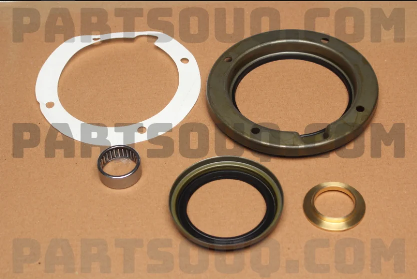

If you're looking to do this and don't mind FEBEST. You can get KIT UZJ100 "Steering Knuckle Repair Kit" from PartSouq. Everything pictured is about $41 out the door. If you go OEM, the "Type K Oil Seal" 90313-99001 is $70 by itself, and that's the discounted price.
