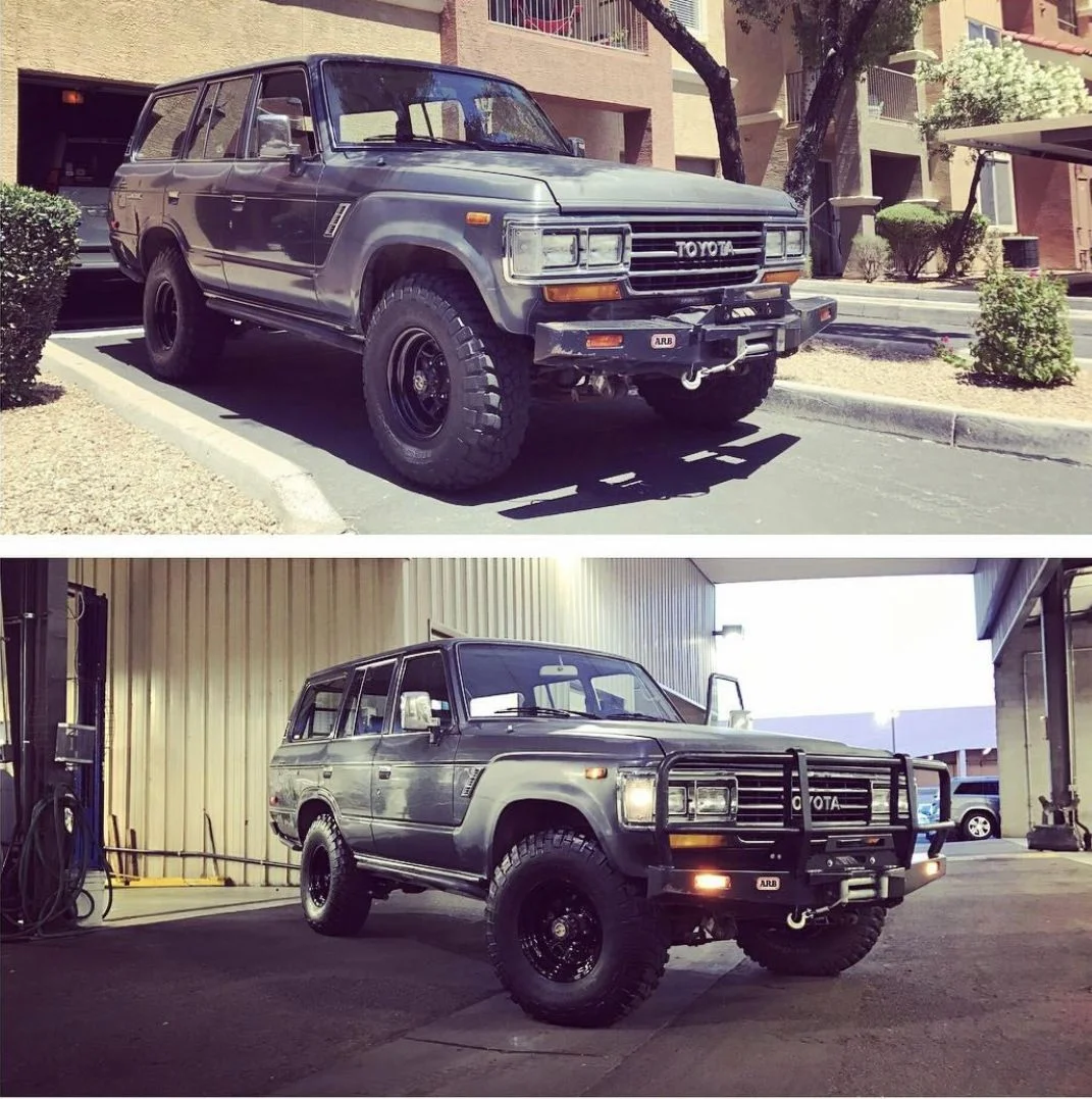

I want a lower profile bumper but don’t want to spend money on something else and have to sell my ARB. I’ve found some old images and random people doing it, but wanting to cut the bars off of my ARB and create a cleaner look.
I like the integrated turn signals that the ARB provides. I would like to add a decent recovery point up front, and I could possibly just run the recovery points that @TRAIL TAILOR sells.
So does anyone want to watch what I do, or give me some input before I get out the sawzall?? I’m also thinking about coloring it a gun metal gray. @ddelong6767 blue 60 is basically bad ass, and his front bumper looks awesome

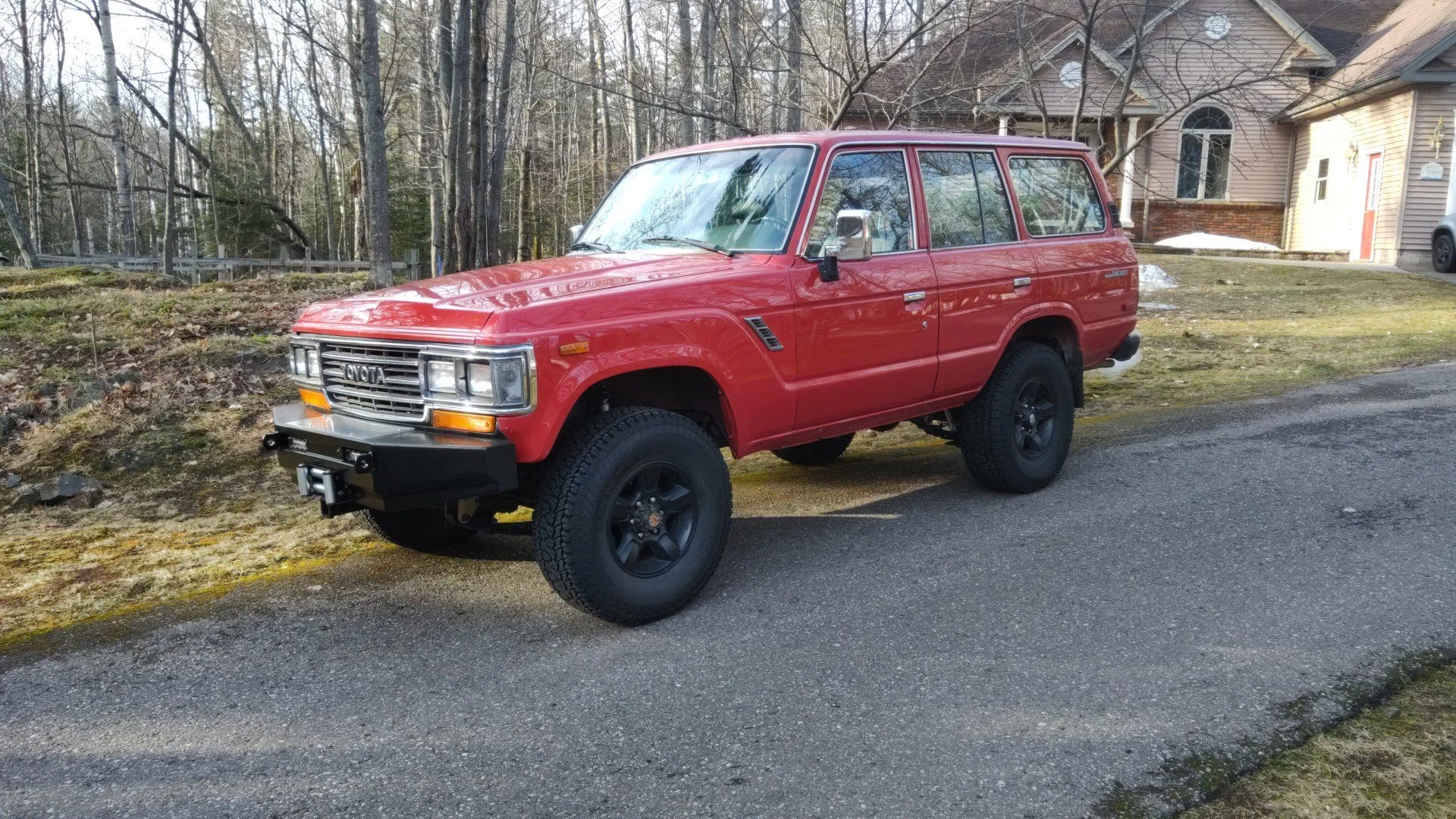

I cut them off my old 62. On the old style bumper, the bars are welded to the plate at the base, making it easy to cut and grind them smooth. On the new style, the bars go thru the plate, so you’d have to patch.
It looks good, but I don’t think I could bring myself to cut mine...even though it clearly killed Bambi at some point.
It’s a “late” one

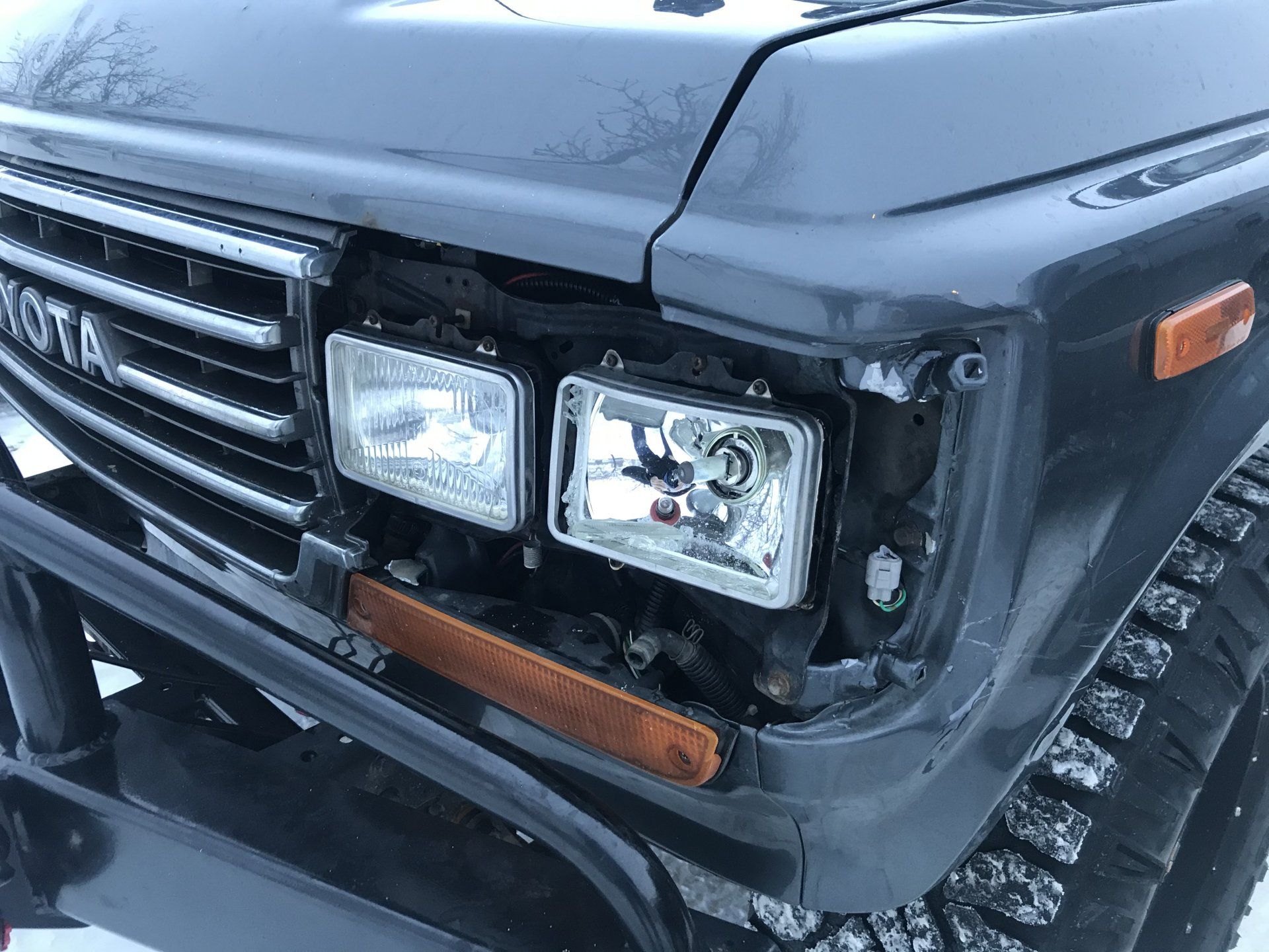

i have a 4plus bumper that looks awesome but i hit a deer at highway speeds last winter and the head went off the angled bar and into my headlights. bumper did save a lot of damage but the ARB would have saved more. the body of the deer still came around though and folded my drivers door pretty bad.
I understand that some people are going for a certain look but for me, it's function first. I'd be keeping the bars.
