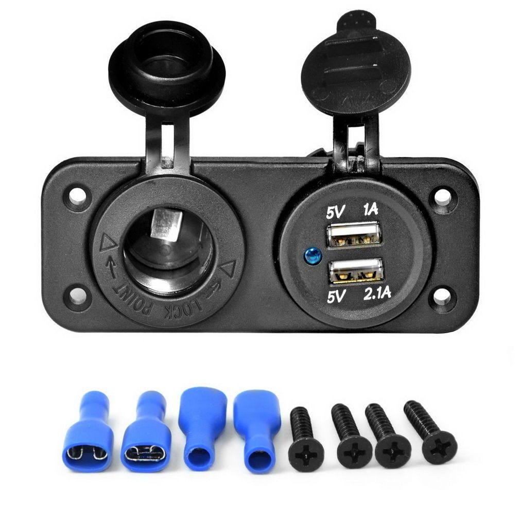

Anyone have a setup like this? I'd like to find one with a metal face plate, if possible.
Anyone have a setup like this? I'd like to find one with a metal face plate, if possible. View attachment 1297805
I have two of those in our travel trailer. The face plate and socket assemblies are plastic. They work fine - my kids use the USB ports to charge their cameras, and the 12V socket has a small 6" fan plugged into it. My only complaint is that the sockets will rotate in the face when you tighten the plastic nut behind the plate, so you'll probably want a dab or two of super glue underneath the lip of the sockets when you install them.
i have those in my golf cart and they seem to work fine. They often get wet (light spray) and they don't seem to be bothered.
Look at the available amps on that unit though. I would prefer a second 12V outlet, and simply plug in a USB charger such as the one I linked to below, that gives full power. It has four full 2.4 amps on all four USB plugs. -So you can charge up to four iPads or large tablets at full speed...or phones at very fast speed. Many adapters do what that one does...one 2.1 or 2.4, and another that's only 1.0 amp. Nearly all recent USB-charged devices are able to handle (and charge faster from) 2.1 and 2.4 amp units, and charge super fast when they do..
Another tricky spec claim to get past are chargers that boast a higher output, but that SHARE their total amps, so if you try to charge two larger devices (iPads), it splits 3.4 (or whatever) and you are really getting too little juice. They'll say 2.1, 2.4, or more, but you have to read the fine print to find out that the more outlets you use, the less power you get.
Here's a solid 12v USB charger that gives the full and reliable 2.4 amps simultaneously on FOUR outlets, for a total of 9.6 amps available. Only $17.99:
Amazon.com: Car Charger: Anker 9.6A / 48W 4-Port USB Car Charger with PowerIQ Technology for iPhone 6s / 6 / 6 plus, iPad Air 2, Samsung Galaxy S6 /Edge / Plus, Note, Nexus, HTC, Motorola, Nokia and More: Electronics
Now that second outlet is ready for other 12v doodads...or four full-speed USB chargers, etc.
My 1.5 cents...
Good info, thanx.
