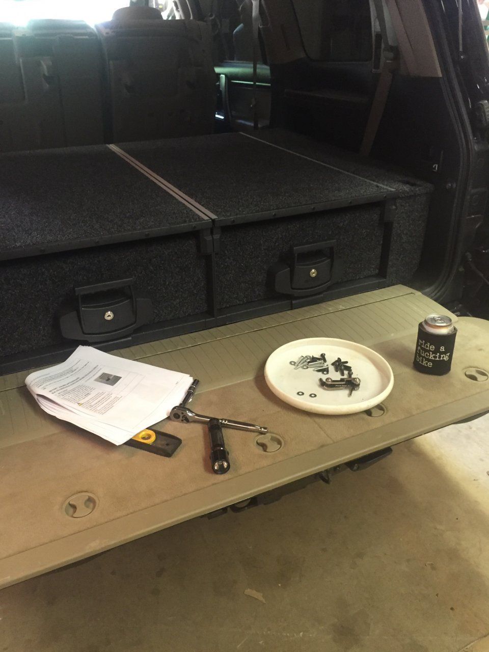

Drawer stop/lock isn't holding a drawer when fully opened. Guessing the clip snapped off.
Just thinking of taking the tops off to review/remedy has me pissed off.
Likely... Takes just a few minute to pull. If you have a RDRF you just open the slide to resolve.
Another Q:
I've got rolling floors and want to remove a drawer completely for access to side screws...but I can't see what releases the drawer for slide-out removal. ??
IIRC, you can't pull the drawer all the way out unless your remove the stops.

Another Q:
You have to pull off the two stops. One on each side of the drawer, two 10mm bolts per stop. Be sure to keep track of their orientation.
OK. Thanks. I guess they can't be accessed/removed by simply sliding the roller floor after all, then...?
Why can't they? Slide out floor, remove 4 bolts, remove drawer.
