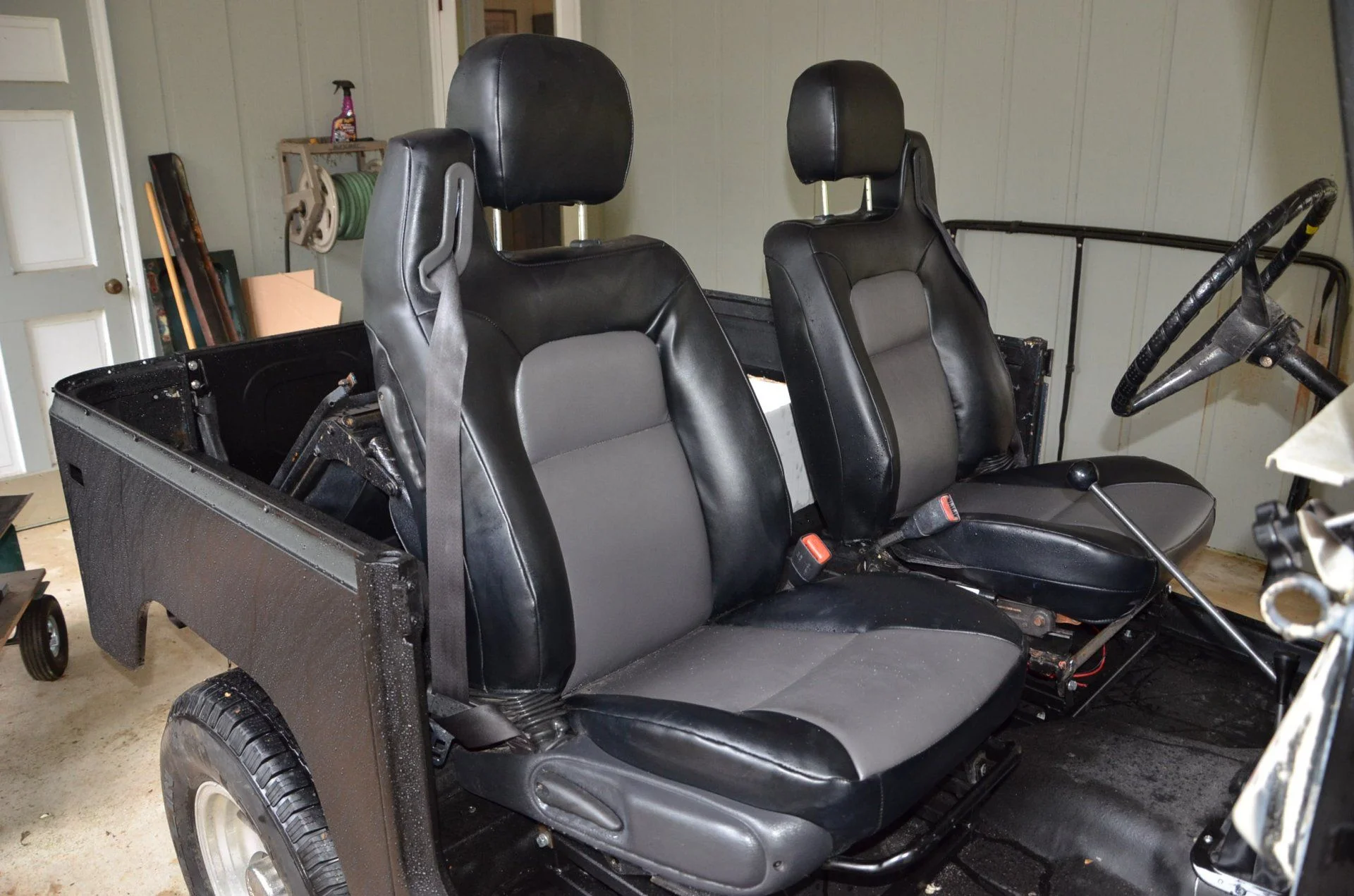

Look for seats from a Chrysler Sebring convertible. I have those in my 40 and I like them. The drivers seat is electrically adjusted abd both are heated but I don't have that wired in yet. Here is a photo taken just after I received it back from the hot rod shop who altered and installed a new front floor and sturdy seat brackets for the Sebring seats.
