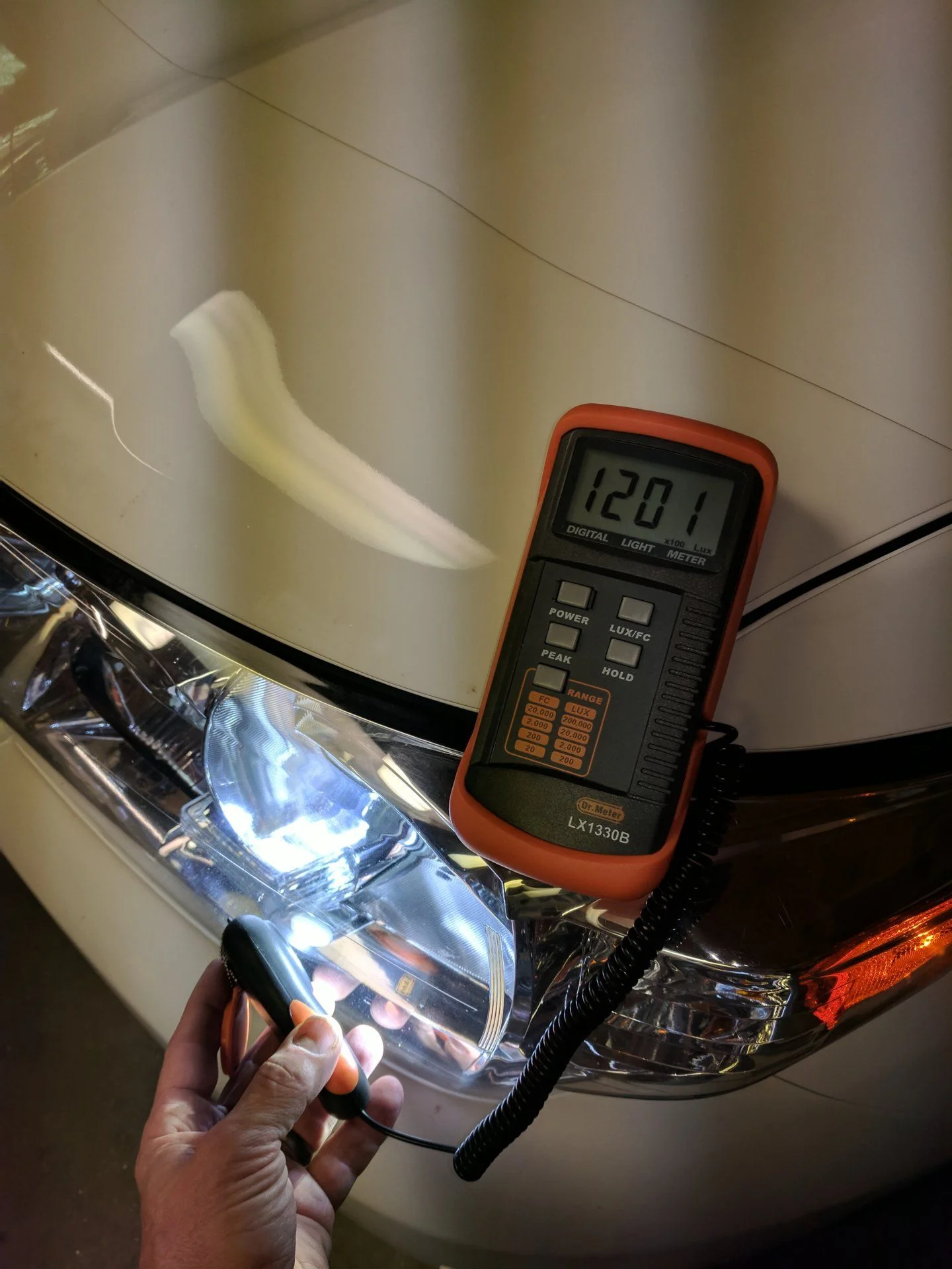

Since we both have the same light meter, it would be great if you could measure light output at the surface of the headlight housing and compare it to what I measured in this thread: HIR1 High Beam Bulbs - Which Are the Brightest?
I can't tell exactly from the photo in that linked thread, plus the difference between '11 (mine) and '13 (yours) headlights, but I think you are talking about the little bump on the inside of the lens at the center (centroid?) of the light beam. I measure approx. 120,000 lux, this is with the engine running this time.
Yes, that's exactly what I was talking about. Your LED's at 120,000 lux compare to the 9005 (High Beam) halogens I measured as follows:
Sylvania Silverstar Ultra 9005 bulb:
168,800 LUX
HIR1 bulb from HIRHeadlights.com:
181,300 LUX (7.4% brighter than the Sylvania bulb)
HIR1/9011 bulb from Amazon.com:
>200,000 LUX (>18.5% brighter than the Sylvania bulb)
The upper measurement limit of my Light Meter is 200,000 LUX.
Color temperature of all three bulbs was subjectively the same - very slight yellow/brown tint compared to the HID low beam light.
I don't know what a low beam halogen would measure, but even the Sylvania Silverstar Ultra halogen at 168,800 lux was 40% brighter than your LED's. The HIR1/9011 bulb was more than 67% brighter than the LED bulb.
I think that the IPF LED bulbs for Low Beam and High Beam applications are both rated at 3600 Lumens. If that is the case, what I can say is that for the High Beam (9005) application, halogen is probably the better choice. And based on my previous testing the best halogen for the High Beam application would be the HIR1/9011 bulb from Amazon (https://www.amazon.com/gp/product/B00480J5CW/?tag=ihco-20).
Gotta love basing decisions on real data :clap:
HTH

Holding your meter against the headlight housing ignores about 95% of the rest of the light as cast from the rest of the reflector lens and onto the landscape/road. Measuring a half-inch spot a few inches from the plastic cover is not going to indicate the degree to which the scene is illuminated effectively. Judgements of usable light need to consider the entire field of vision and swath of light as actually cast on the full view, rather than one bright point cast an inch away. You are measuring only that tiny portion, without regard to scene illumination.
It's about like sticking a meter in front of a laser beam...and judging its effectiveness as a headlight based on that tiny bright point. Lasers are bright, no doubt...but we all know they'd make crappy headlights.
Meanwhile...my neighborhood is lit up with these compared to originals. It ain't even close.
Umm... I think you missed the point of the meter exercise. The meter measures light INTENSITY, but you are talking about volume of light output.
Think of the headlight like a firehose, spraying water. The meter measures the pressure of the water as it comes out of the nozzle, that's all, and at only one small spot. In order to determine volume of coverage, you need a flowmeter, measuring something like gallons per minute.
My intent was to remove all the variables from the system and just measure the light pressure change, before and after, and at the same exact point and distance from the lens.

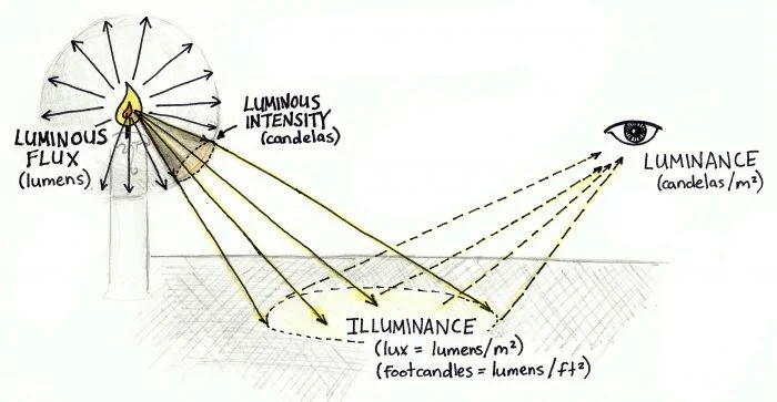

In case anyone is still thinking about this... ( :deadhorse:), this graphic illustrates what I've been attempting (and failing) to communicate about measuring the source...vs. what we can actually see as a result of various light source/reflector combinations.
Lumens emitted at the source (Luminous Flux above) may...OR MAY NOT indicate how well a scene is lit/made visible. Source comparisons that don't take into account well-distributed Illuminance and finally Luminance could render a misleading verdict about what offers the best vision at night.
A bulb or LED might have tremendous luminous flux (lumens) at the small source, but it may or may not translate to useful illuminance off of objects that we detect/see as luminance, as effects of the interaction with reflectors and spread translate. If it doesn't align with the reflectors, or take full advantage of them, it's bright output may be wasted.
Here's the article it came from in case anyone wants to geek out...
Not about headlights specifically, but it points to some of what I was referring to in my lame, laymen's language.
Measuring Light Levels | Sustainability Workshop

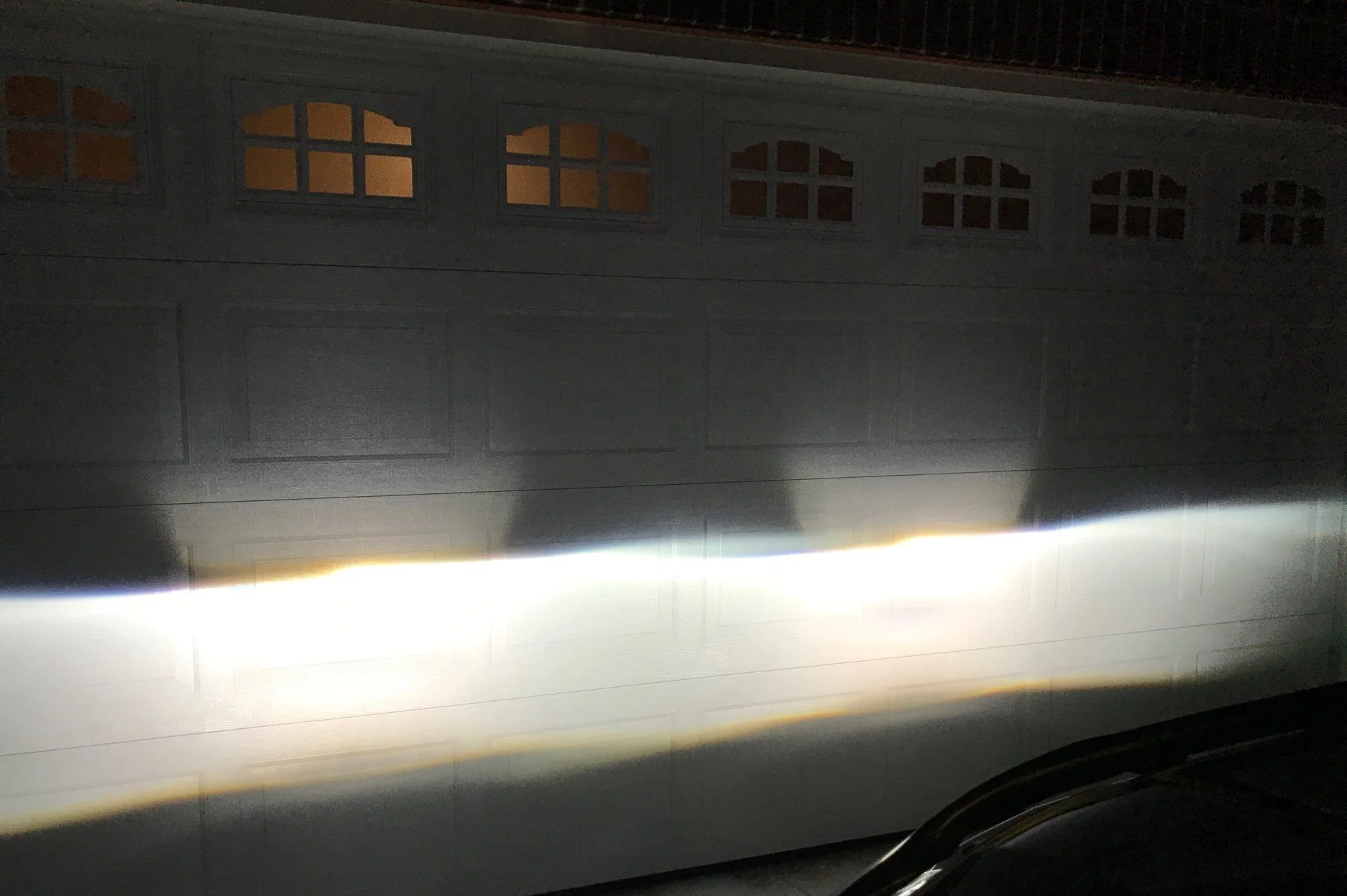

Stock low beam HID - good cutoff thanks to a shutter in the stock housing.

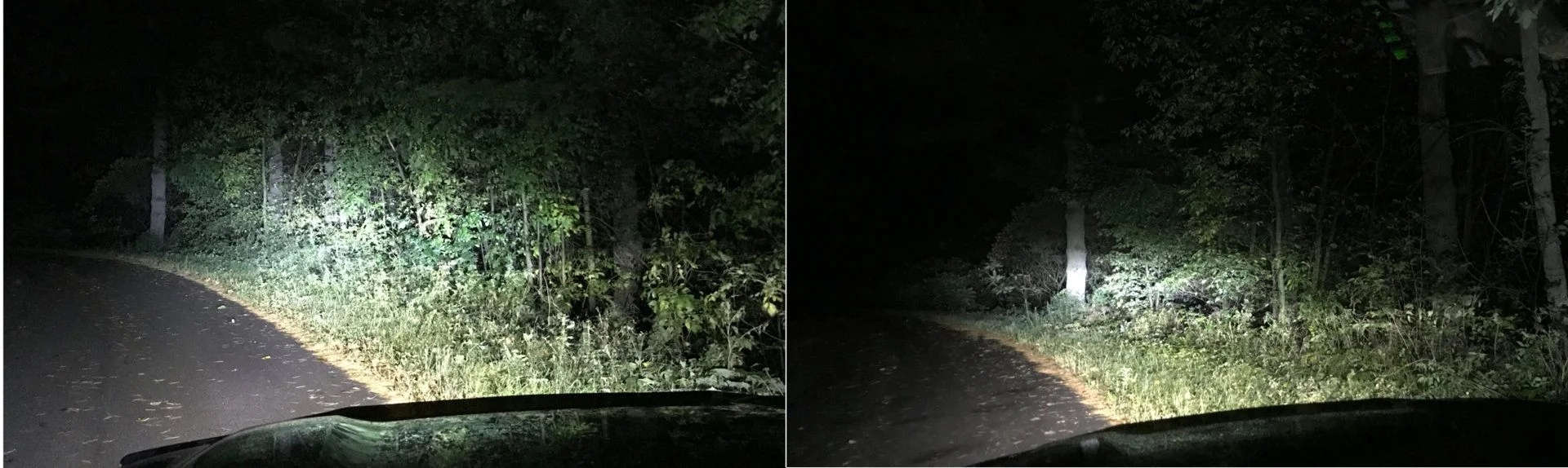

Throw comparison.
Left pic: BeamTech on the left, IPF on the right.
More throw upwards on the BeamTech.
Right pic: Both IPFs installed as high beams.

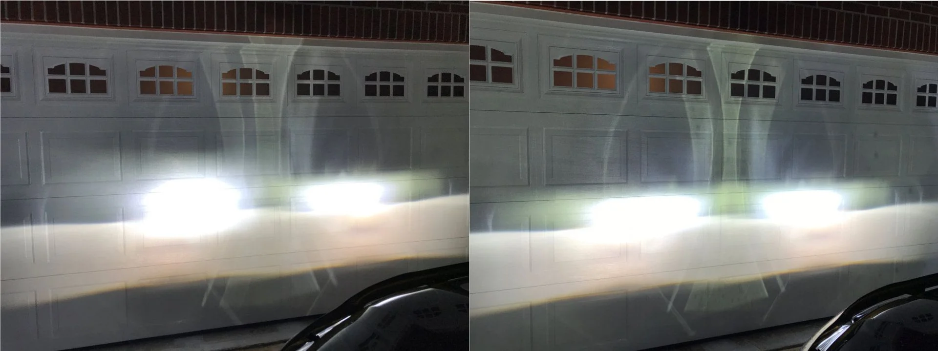

Beam comparison.
More light scattered upwards and less definition/cutoff on the BeamTech.
Very defined, good cutoff.
@NC237 thanks for the visuals.

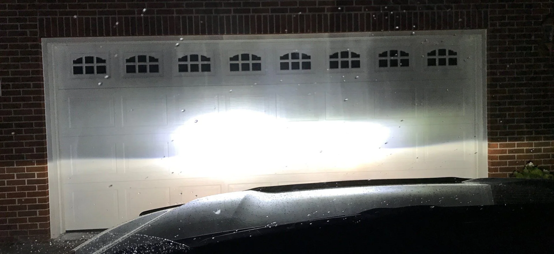

Got my bulbs from Amazon Japan tonight! Spent a couple minutes cleaning up the plastic covers, swapped bulbs and waited for the sun to go down.
Holy white light batman....i love these things. Tried the high beams and love that the lows stay on.
Wish I had these in Moab!!!! Definitely would have saved a couple hours of missed trail markers.
Best 122$ I've put into this truck.
I just put them in a 2015 - which should be the same as a 2013.
I posted visuals a few posts up from this one.
My 2008 reflectors are very different.
There ya go!
Matches what I saw too...
I find it most obvious with land-based contours & barriers.
Massive improvement for nightmares in Moab! :hillbilly:
