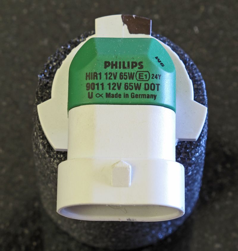

The first were the Philips HIR1/9011 bulb being sold by Amazon.com for approx. US$35.00/pair: http://www.amazon.com/gp/product/B00480J5CW/ref=oh_details_o01_s00_i00?ie=UTF8&psc=1
Here's what the base of that bulb looks like:

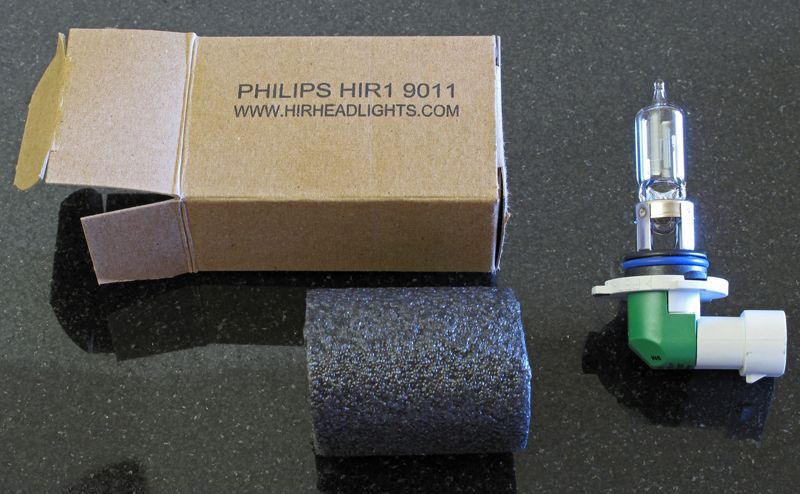

The second were the HIR1 bulbs currently being sold by HIRHeadlights.com for approx. US$57.00/pair: http://hirheadlights.com/
I trimmed both bulbs so they would fit. This was very easy and both fit perfectly in the 9005 socket after trimming. No modification to the headlamp socket was required.

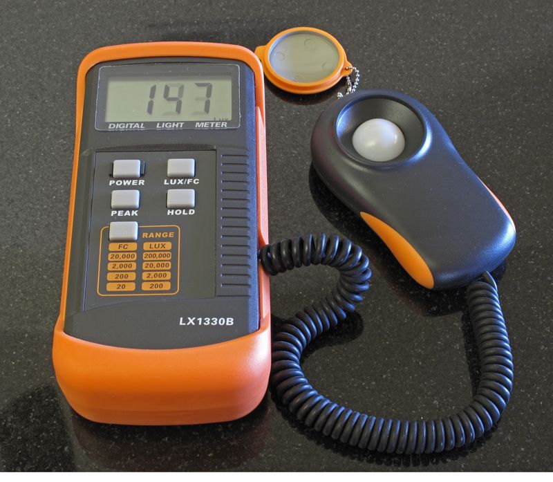

I have a digital light meter:
So I decided the easiest procedure would be to measure the light output of the Sylvania bulbs already installed, then install and measure the light output of each of the HIR1 bulbs.

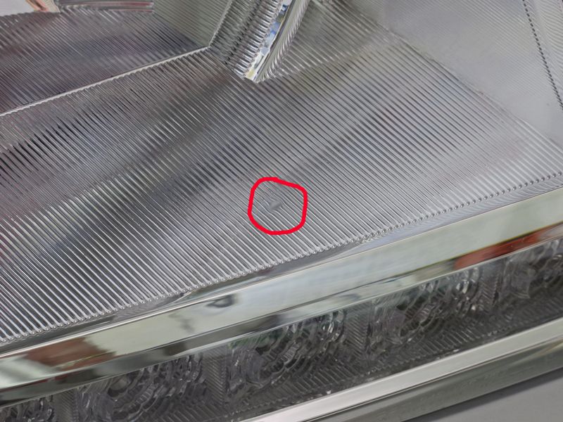

In order to be as consistent as possible when measuring, I measured all bulbs with the engine idling, headlights on High, holding the Light Meter's sensor in exactly the same place directly over the high beam center marking dimple in the headlight housing - circled in red in this photo:

A genuine Philips 9011 lamp has a 400 hour life which is 80 - 100 hours longer than the 9005 lamp you are replacing. The reviews you report of having only 2 -3 months life --PLUS-- the pictures by the author reflect that the AMAZON lamps displayed and discussed in this thread are most likely counterfeit lamps.
