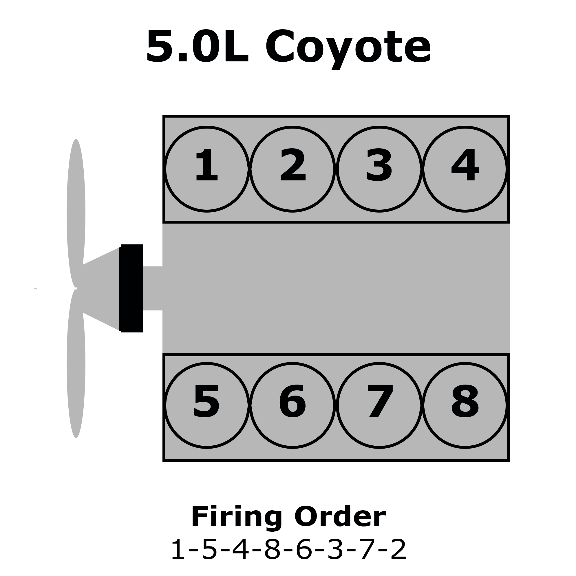

Why 5&6? Those are opposite sides of the engine, but across from each other. Separate valve trains, separate gaskets, no direct connection. Seems no chance of coincident failure of those 2 cylinders from low oil. And oil on #1 even though running well? What the heck? Second opinion time?
Depends on how the techs are numbering the cylinders.
Ie:
Ie:
Yes but I think only Ford numbers their engines (like the Coyote) that way. Most (all?) others number with the DS front being 1 and the odd numbers on that side. Camelback will know that's how the 5.7L is numbered.
