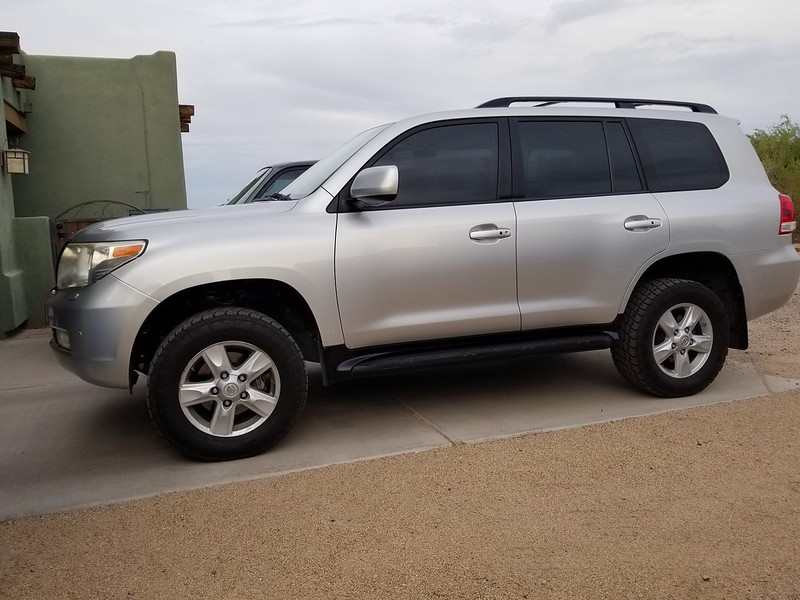

She's an unusually clean 2008 so I don't want to go lowball her off because of some freak motor mishap. Still a head scratcher how she went down and I'm not going to speculate about what caused it for a bit.

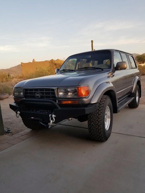

Wife will have to drive my 80 for a bit, oh the torture. Beautiful Spring in AZ, have a great day everyone!

I am happy to report the 200 is back on the road and running better than ever.
Thankfully I didn't have to scrap her or sell her in her broken stage for peanuts and glad I didn't go for full engine replacement ;) She had a broken valve spring and and several other valves not holding proper seal. A complete valve job later (I replaced all the springs too, just because) and she's running good as ever. Got a new radiator as well as somehow the existing got a puncture wound during her surgery.
