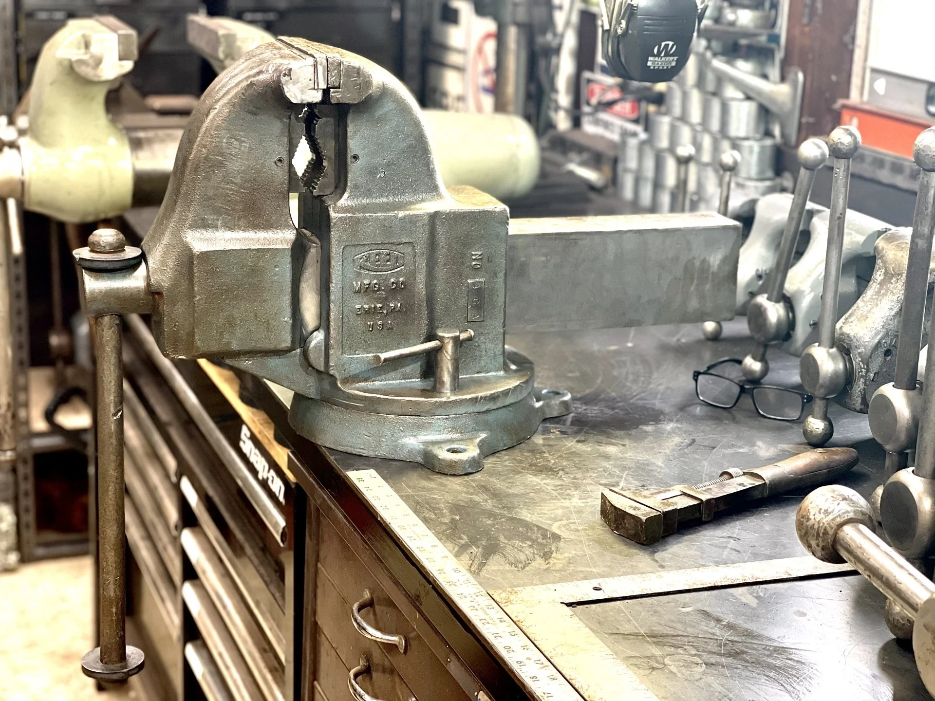

@Skniper Your Reed is a "pre R" series that they began manufacturing after the war (1943 actually) so yours certainly predates that. Reed date stamps are famously hard to find. The 270 is definitely not a date stamp. 7/26 is much more believable.

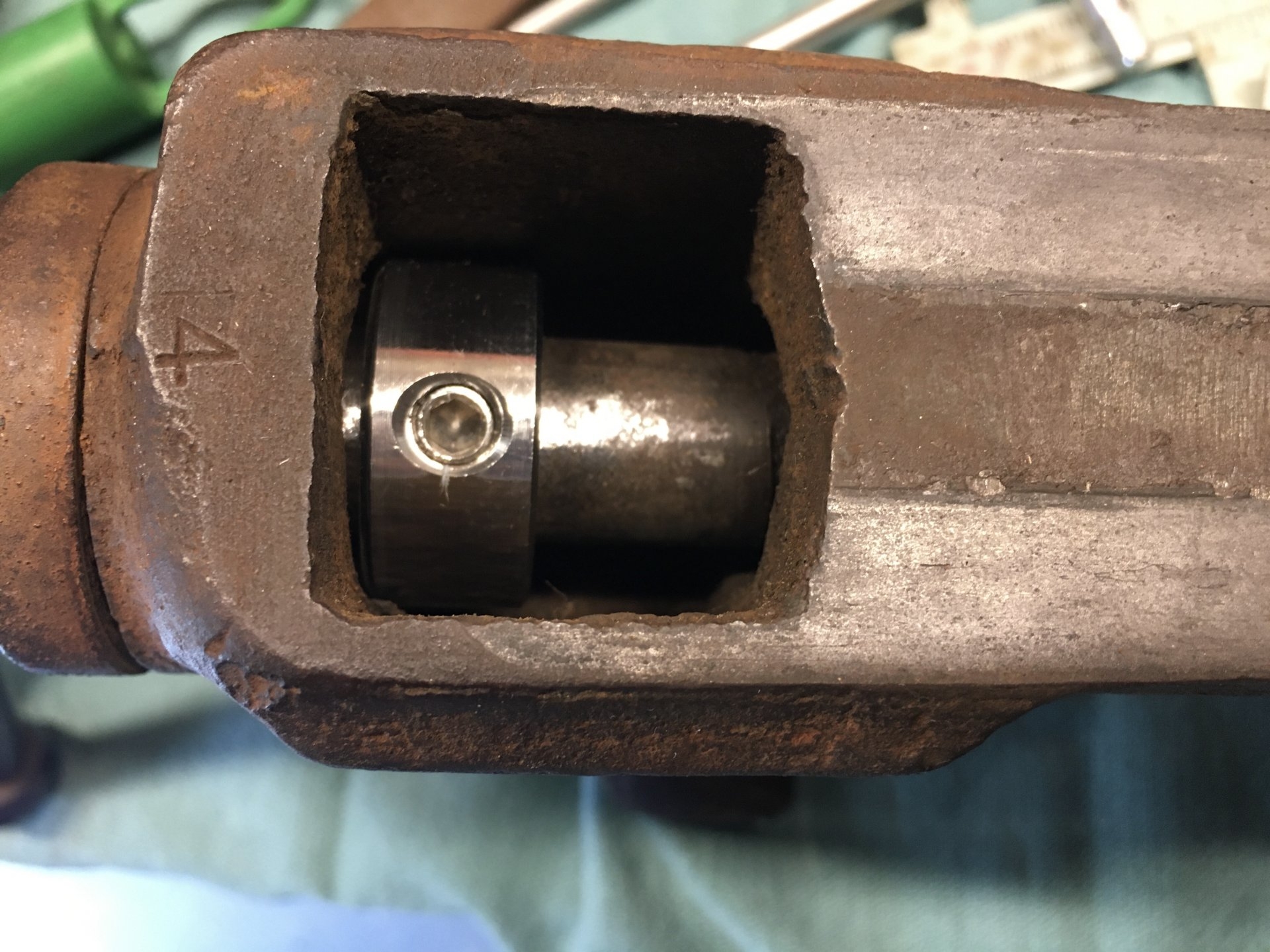

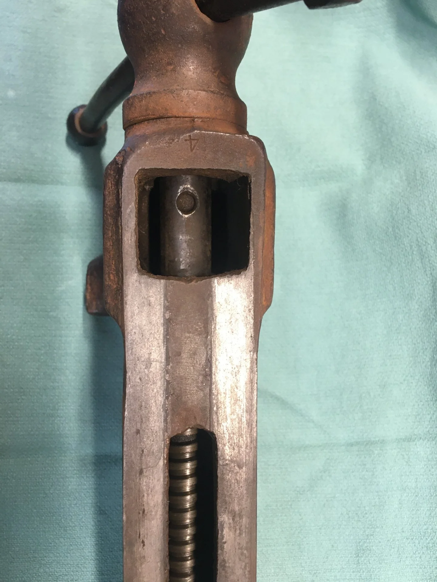

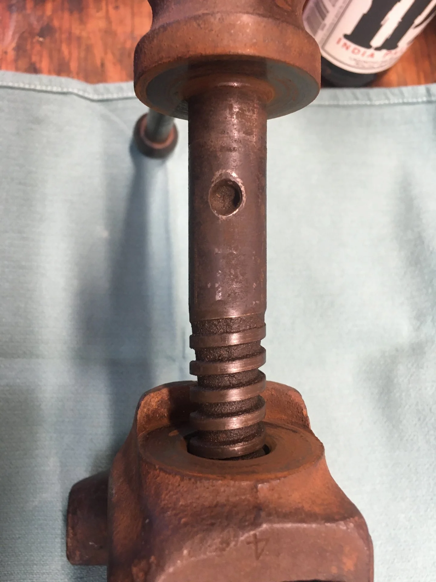

@FARMAN33 @scrapdaddy Got the slide removed from the Reed 103 1/2. There’s definitely some sort of retainer sleeve/set screw that’s missing. The vice clamps just fine but the screw won’t back the jaw out, has to be pulled back manually. Makes it tedious when trying to adjust things.

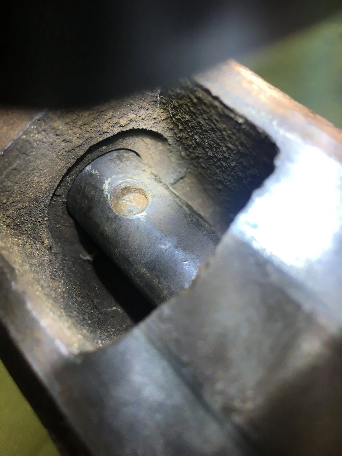

Any idea what exactly goes in here ?
@Skniper Yes. This is the older style Reed that used a shaft collar (1/2" wide ring with a set screw through it) to keep the dynamic moving when backing out. After the 40s, they started to use a split nut between the "meatball" and main screw.
That collar would take a proper machinist about 5 minutes to make, but that ain't me. I'll start looking for some type of collar that might fit and can be drilled/tapped.
I can't find any photos on the web so far that show a break down of this particular vise and part. Need to join Garage Journal too.

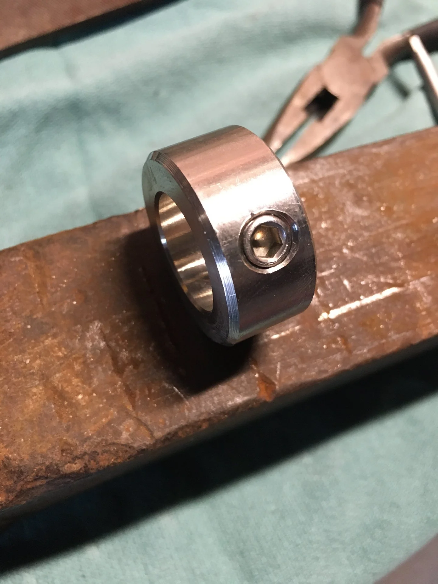

Well that was easy!!

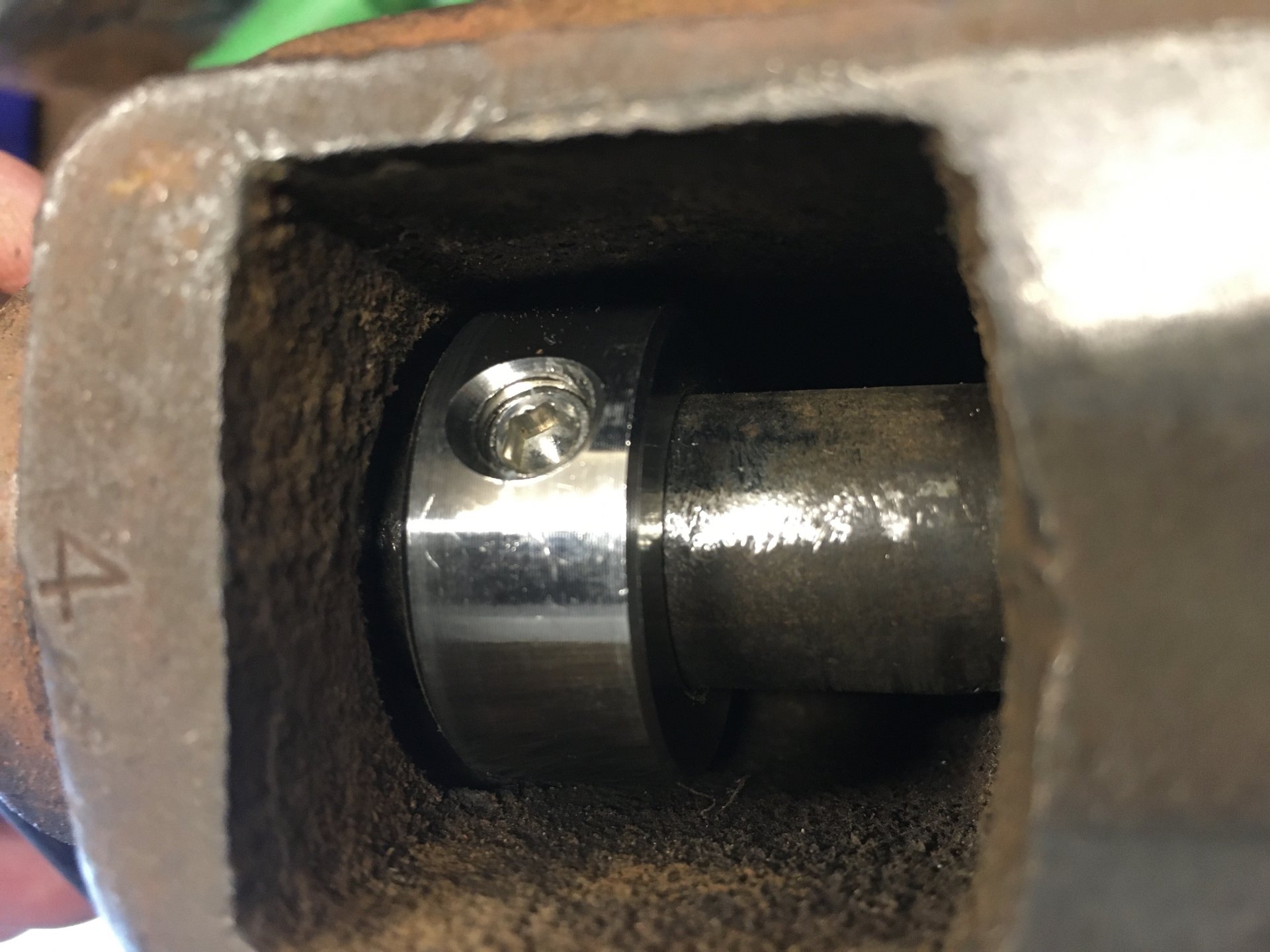

Thanks to @FARMAN33 for the lead on these machined collars (Amazon) to make the old Reed 103 1/2 completely functional again.
Perfect match on the collar’s inner 3/4” and outer 1 1/4” diameters. The chamfered edge of the collar even matches the recess in the dynamic jaw, although I may add a washer in between the two to act as a bushing.

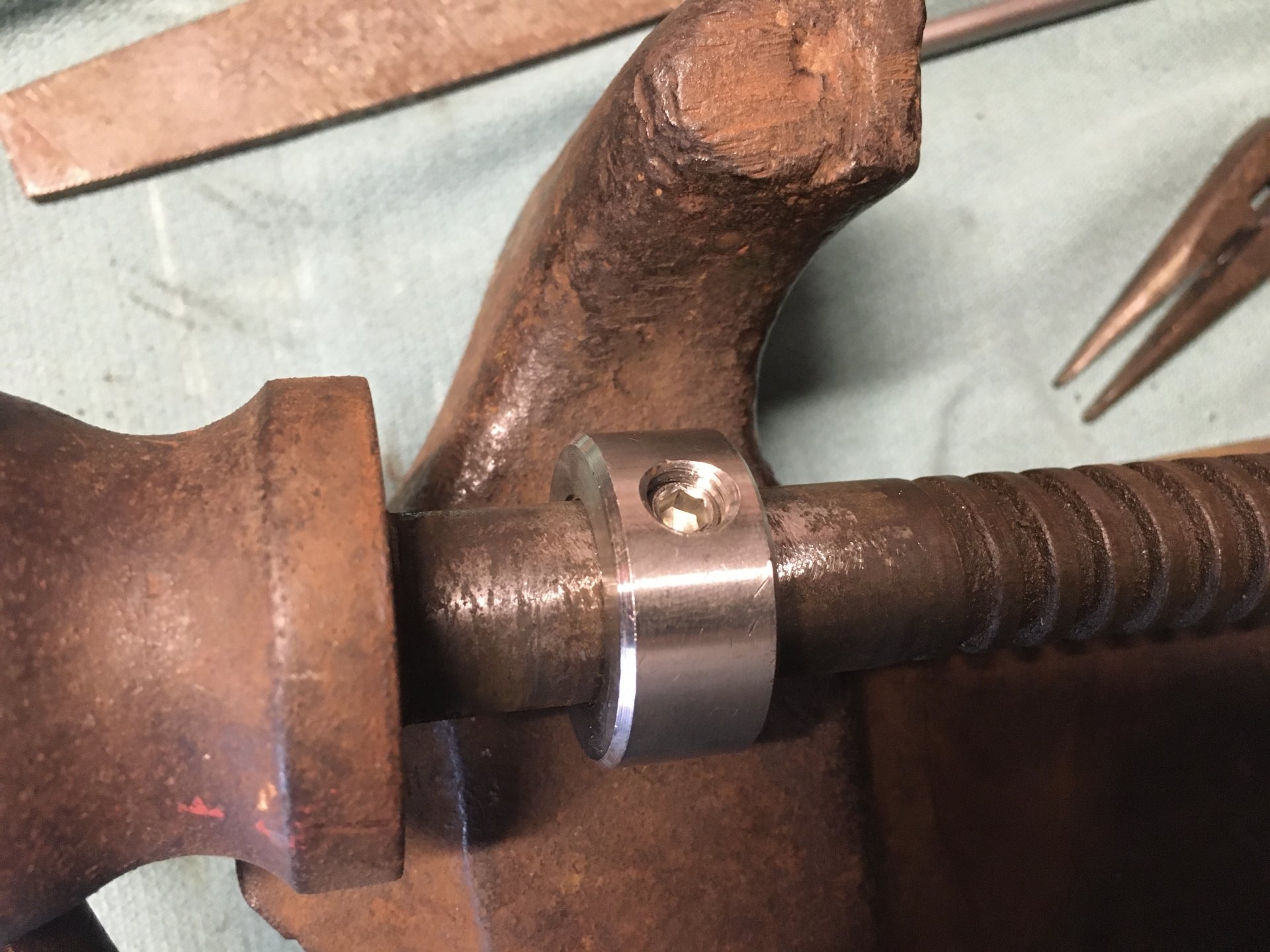

Shiny bit on 90 year old rust:

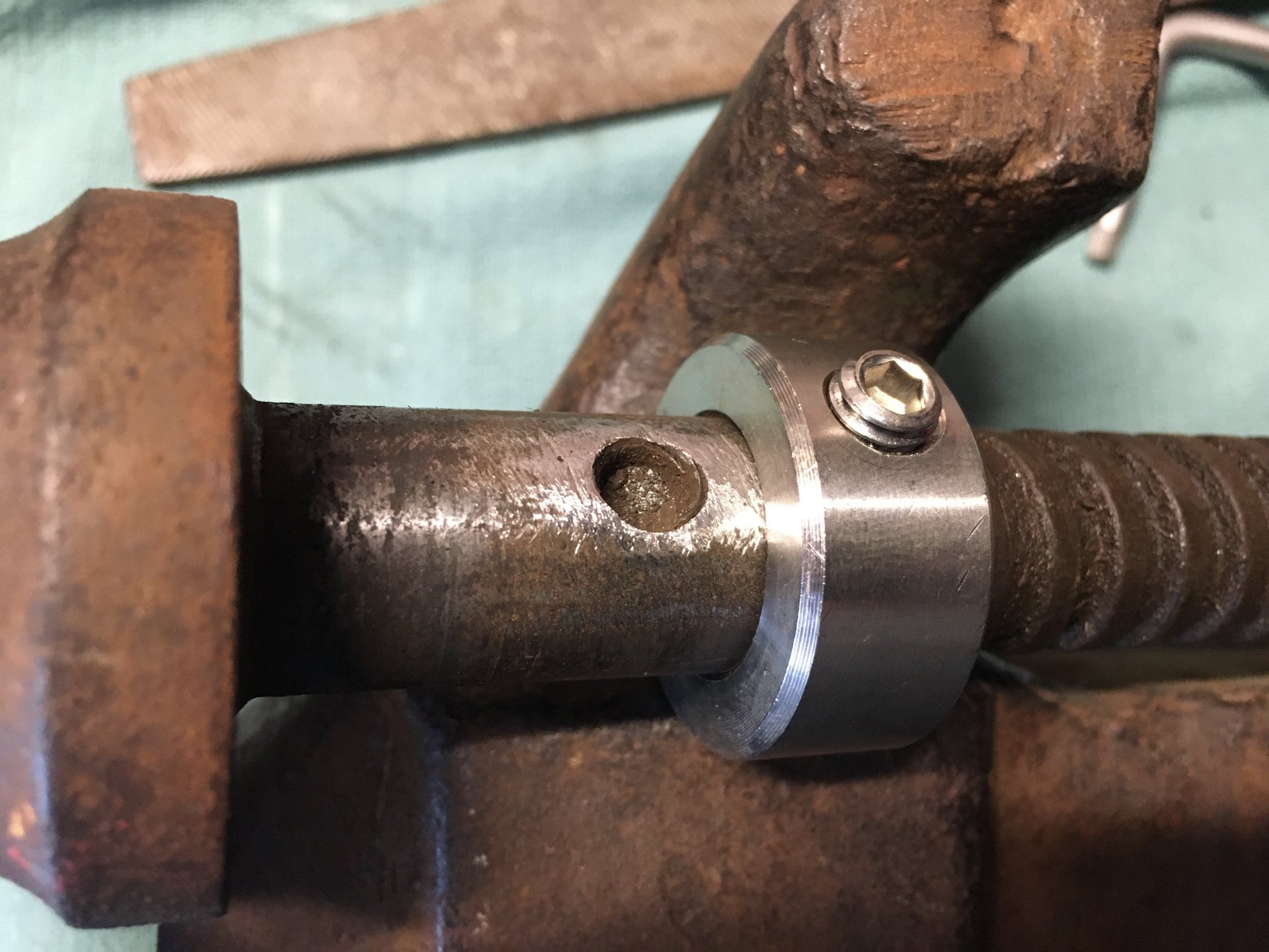

Needed a little flat file work on the worn spindle set screw hole:
Perfect fit:
“Dynamic” again:

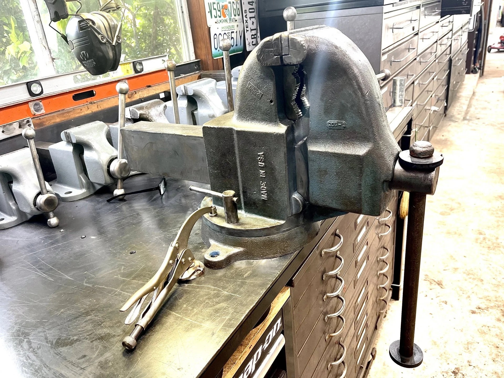

I picked up a Columbian 605-M2 today. It's pretty beastly. It's newer, so the lettering and stuff isn't as "cool" as it is on the antiques, but it operates smoothly, the knurling on the jaws is in really good shape, the jaws close square to each other. the levers(bars) on the swivel locks are bent to sheet, but that's a fairly easy fix. It was at a local architectural salvage place for $185. I happened to have store credit though, so out into the truck for $120.

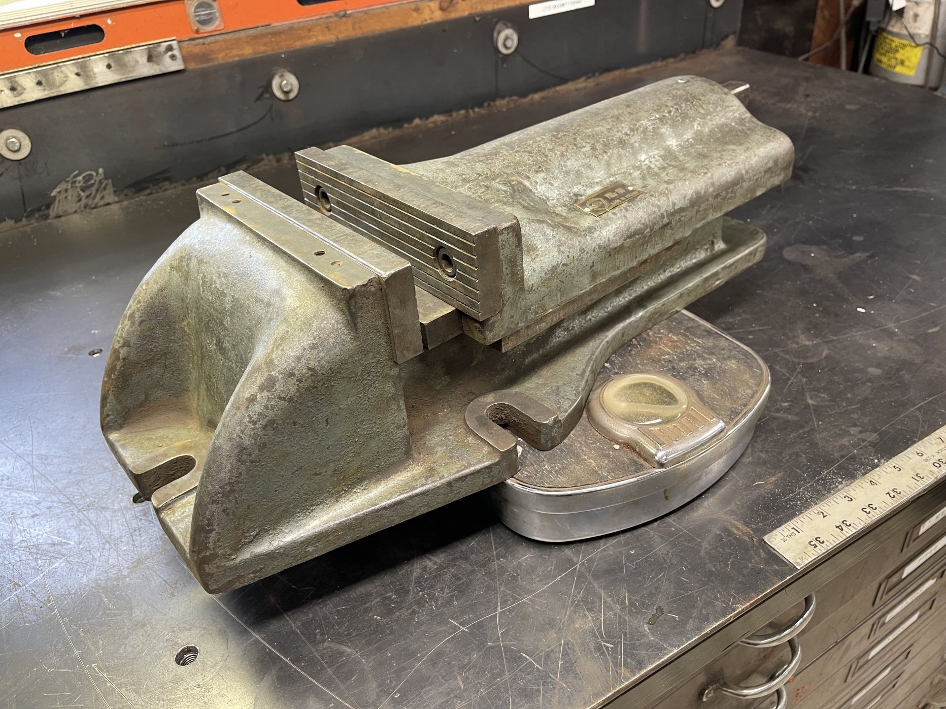

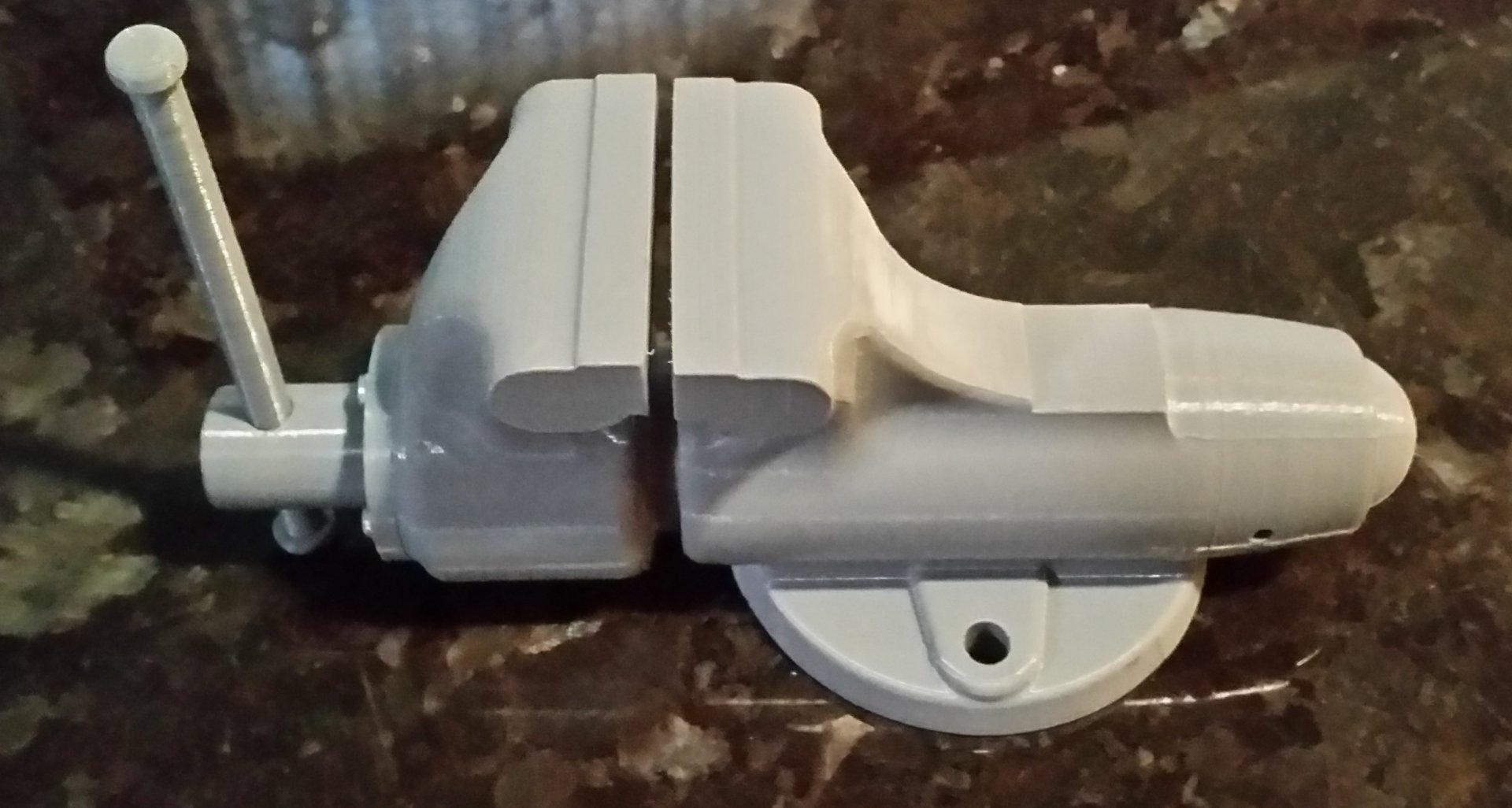

I'd be really curious if any of you have seen one of these, or have one. Mine is missing a spring and/or a couple of other pieces that enable that quick release feature. I was able to find the patent, but I really doubt the exact mechanism from the patent made it into production in the 1950's. I would love to see the "guts" of one.
The Columbian 605 is one of my favorites. I have a newer Reed 4C-A that is a rebadged Columbian 206 (combination series). My absolute favorite vise! Columbians have such clean lines (similar to Steretts) and their ductile composition makes them legitimate “lifetime” vises.

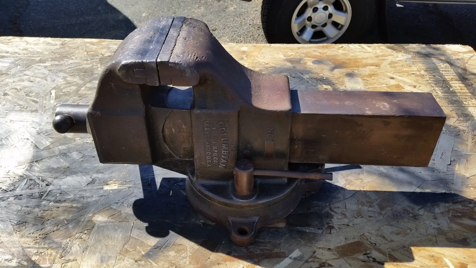

The first vise I bought that got me on this collecting/hoarding path was a Columbian 606 that was in very good shape. At the time I thought it was too big for my small garage so I flipped it. Wish I still had that one.

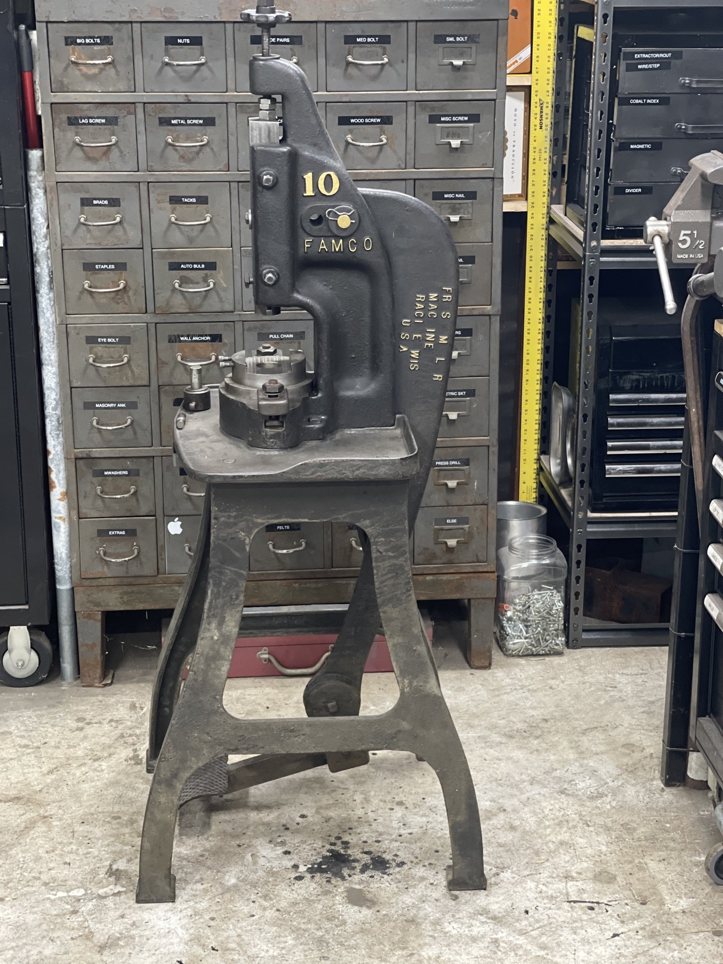

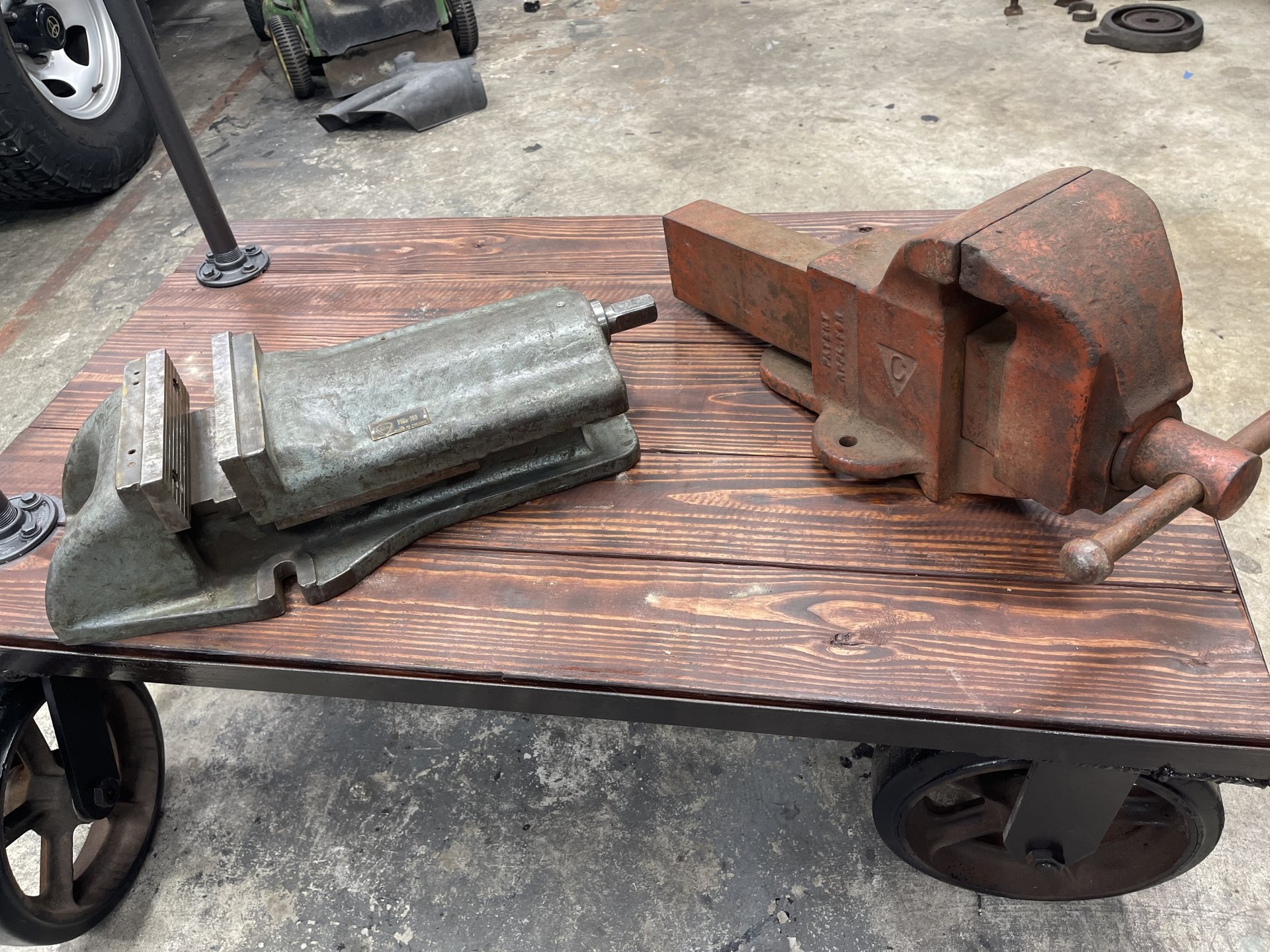

@TomH that is beautiful! Funny, I picked up a 506 today. It’s an older Triangle C logo. Also picked up an 8” FPU (Polish) milling vise and a 2Ton Famco kick press. Nice little trip to Austin paid off!!!
